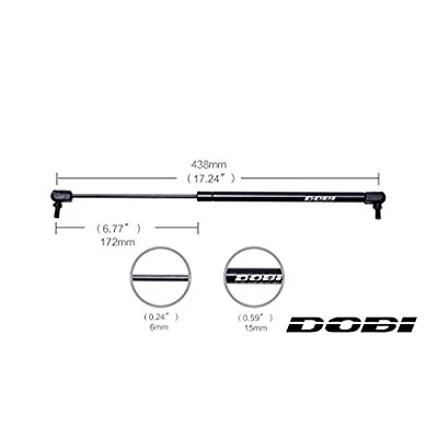

So is this a skinny strut that fits inside the OEM unit it did you just mount the strut to the OEM bracket?
Would you mind measuring the diameter of the wide part of the strut? I’ve bought two sets and neither would fit. So I’ve mounted one set without the OEM struts but would love to have the OEM struts back in there. Thanks!
1mm to spare
