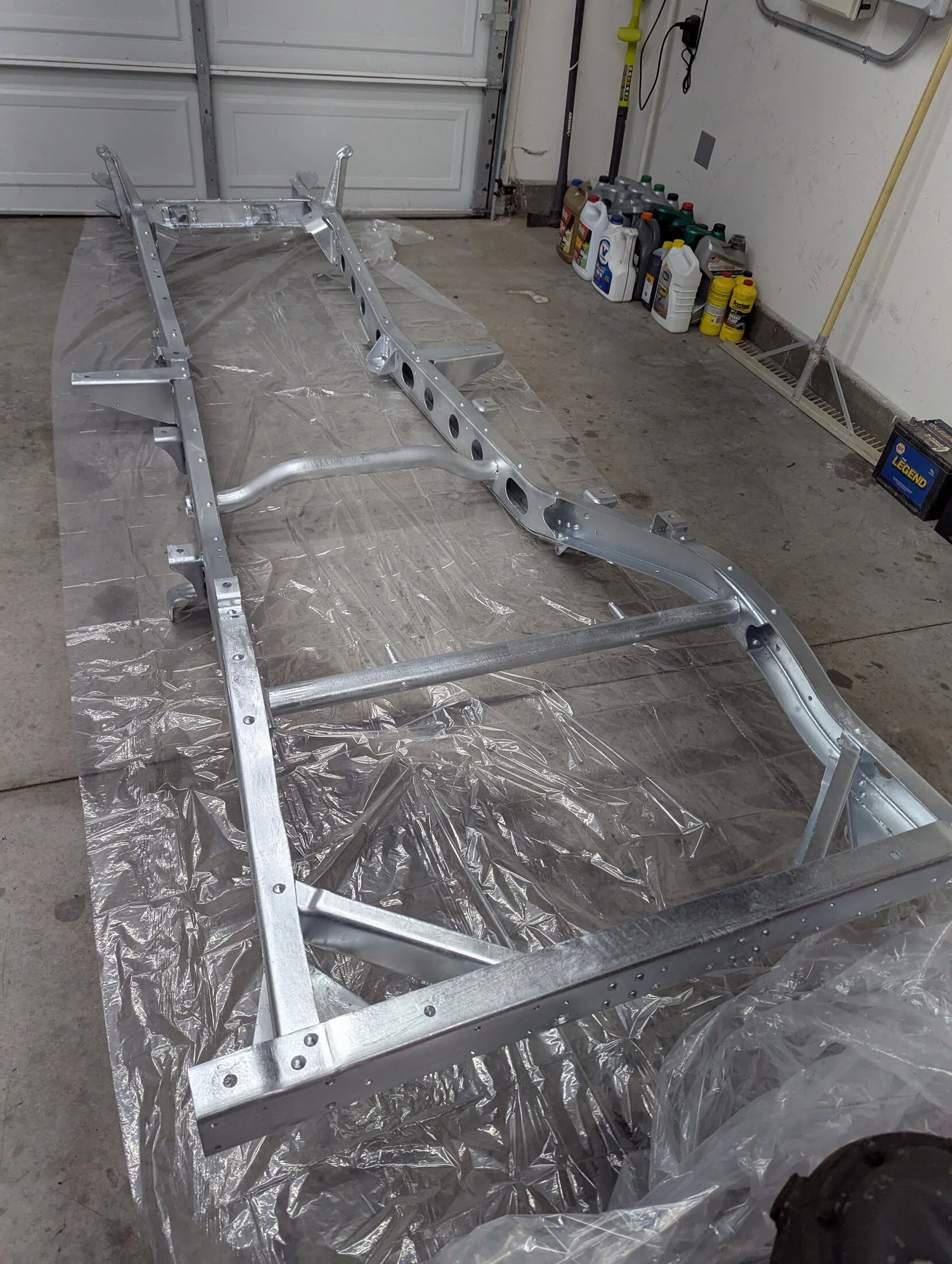

I got the frame galvanized. So follow up question for those of you who did it. What did you do for paint? All the LR forums talk about T wash which inst sold in the US. I've heard some people just use vinegar and degreaser followed by etching primer. Some say use epoxy primer. Some use other acids/metal prep.
What did you guys do?

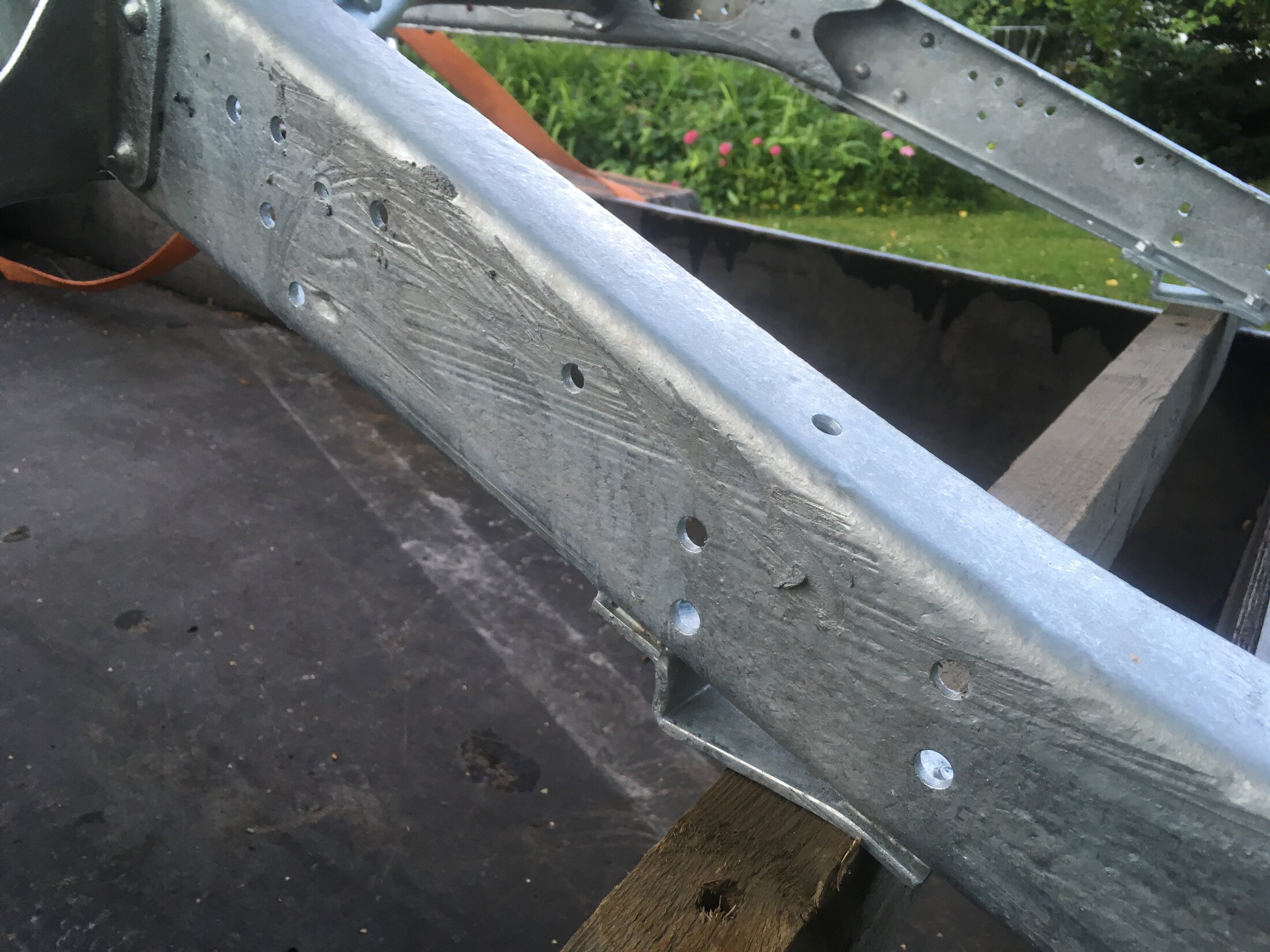

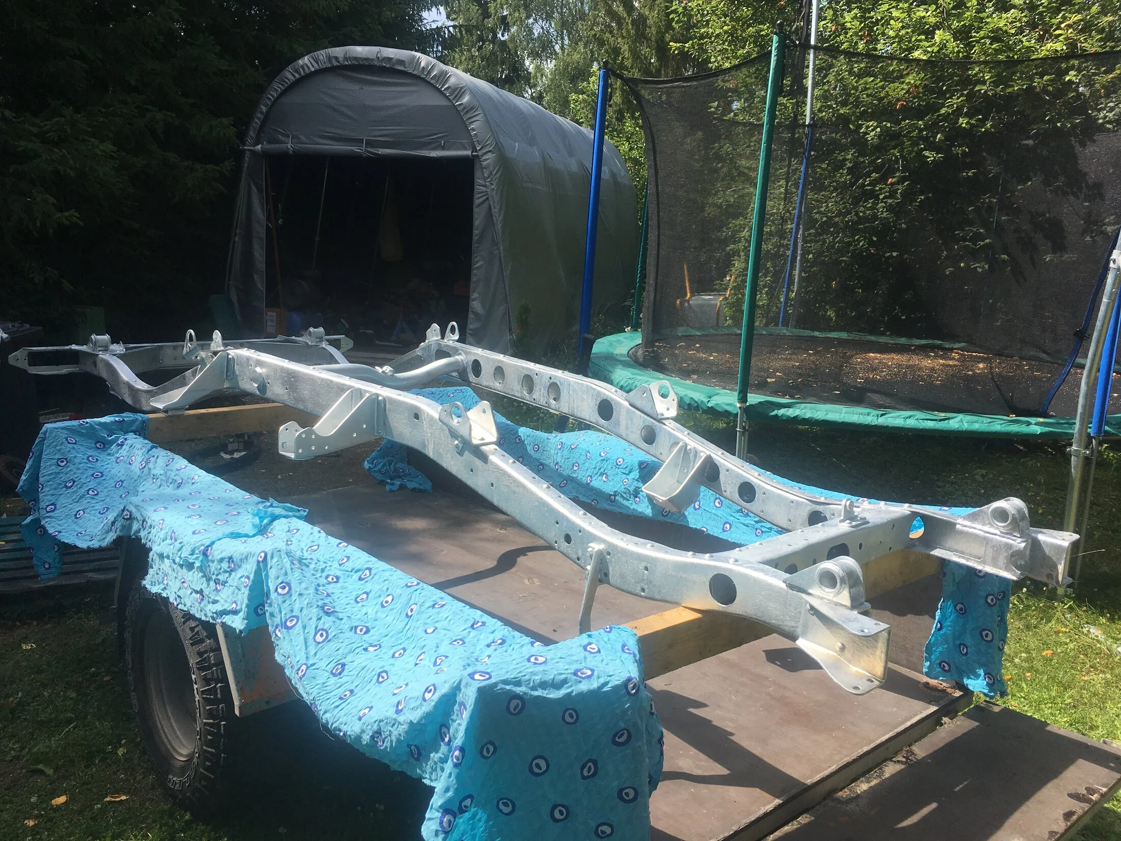

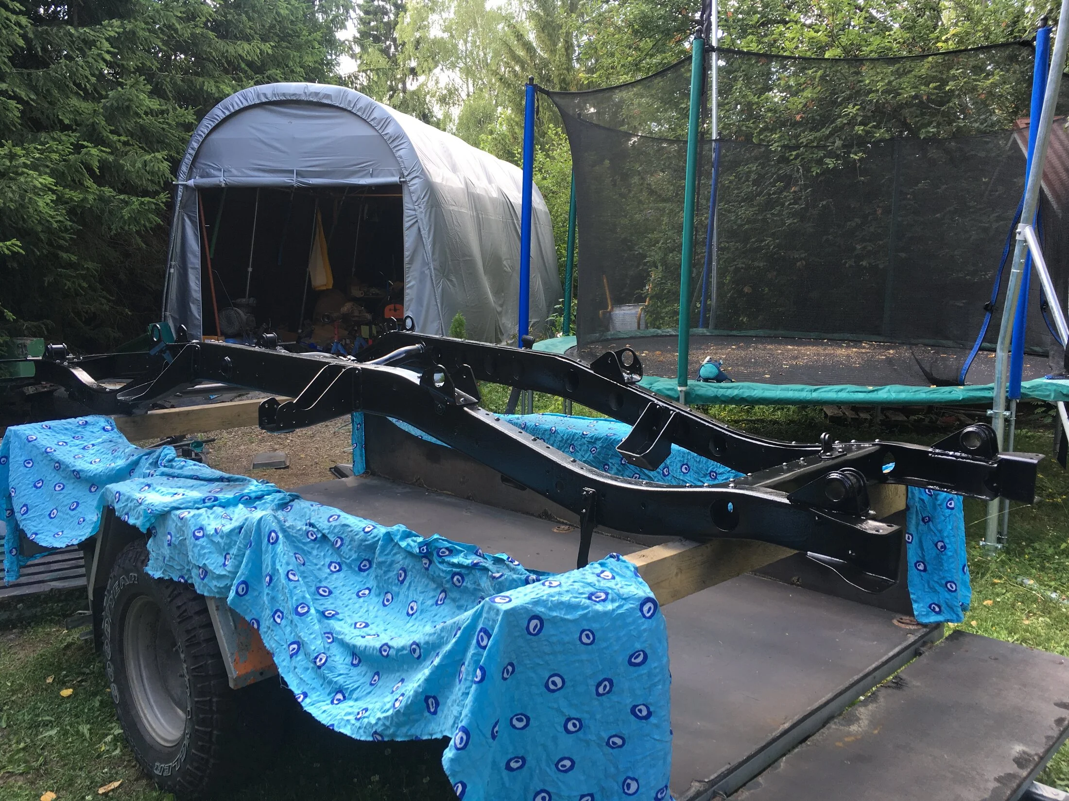

I used phosphoric acid, just a little while (it starts to react/makes foam), then washed it and painted with black epoxy. It’s looked nice since (almost 6 years now).
There was rough zink surface in some areas which will be seen, so I used aluminum bondo to them after grinding. It’s held nice too.
