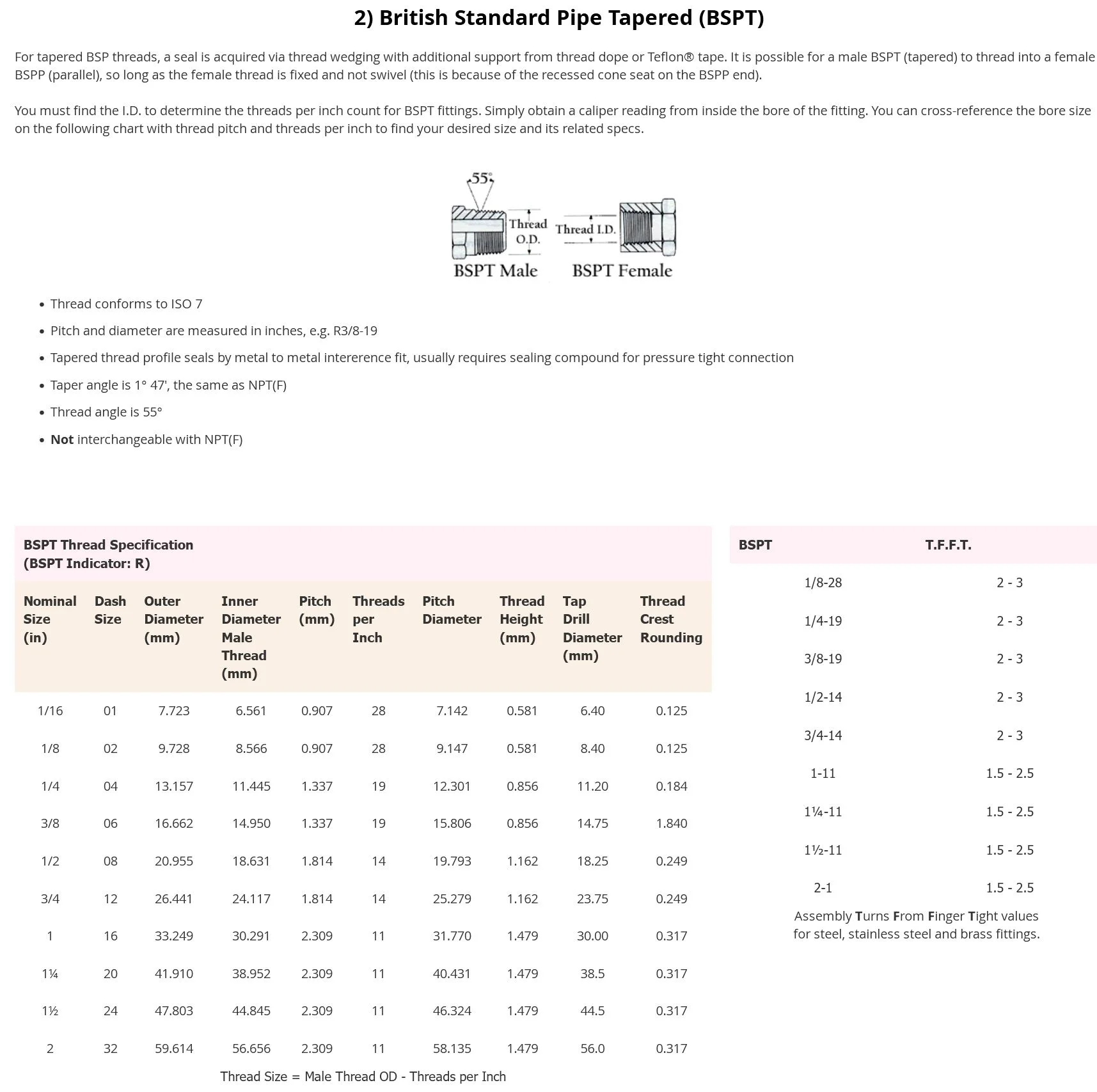

@ZblackliZard : If you can't do it yourself any mechanic can check the oil pressure for you. The threaded hole where you or the mechanic will attach a mechanical gauge (by removing the oil pressure sender) has 1/8 BSPT (British Standard Pipe Taper) threads, most oil pressure tools/kits should have that BSPT adapter.
