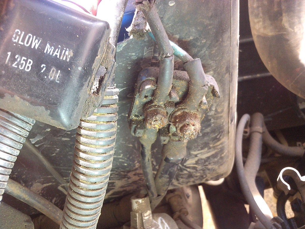

Let me tell you a thing or two about fusible links........
#1: Replace them!!!!
#2: Replace them!!!
I went on and off for the last 10 months with an intermitant stall and starting problem. Just happened to occur the exact same time I had a remote start put on. After spending close to 40 hours trouble shooting, a couple of tow trucks and a lot of time on here I finally took the remote start out. Now 3 months later I have been trouble free (though I rarely drive the vehicle). Today it dumped me with the exact same problems as before. Jumped the fusible links and TADA!!!! So 12 bucks to my Toyota Stealership and I will be picking them up on Wednesday and getting rid of my current hodge podge jumper system.
ohh the love of the Land Cruiser.
