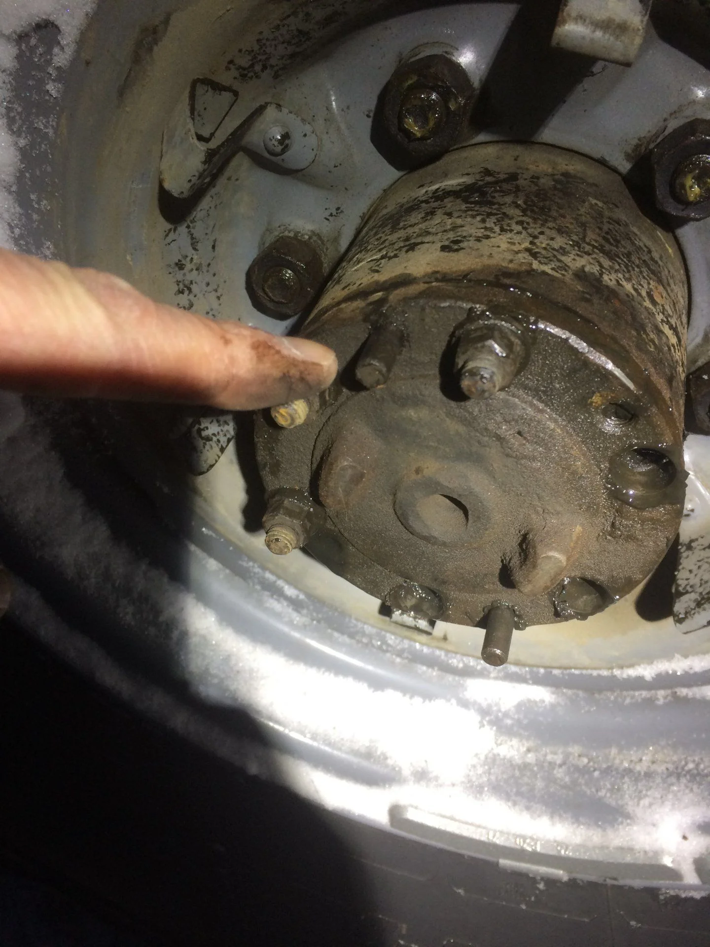

Went to snow plow and noticed a bit of grease on the Rear Right wheel. The grease had come from inside the hubcap. When I moved the Troopy I heard a noise inside the hubcap, thought it might be ice. Took the hubcap off and found three of the studs with cone washer and nuts broken, first photo, and also the pins I'm pointing to on the second photo where almost out. The other three studs with cone washers where loose.

There is a thread here or in the 60 section about beefing up the full floater. Believe the issue may be nuts loosening up that causes them to snap off. Also those pins should be flush when the axle is installed. Either a longer replacement or working their way out.
Thank you. Yes, the pins are flush on the other side, looks like they worked their way out. I'll do search on the 60 series. I'm hoping that that is all it is, that the nuts loosened and then the studs broke.

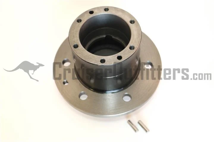

Yuck, btdt. We've got everything you need to fix it up but the big question mark is getting the broken studs out. Worst case we have complete hubs for the FF but I'm hopeful you can back out the broken pieces. If the hub studs damaged he hub by coming loose, we've had great luck clocking the studs to a new orientation and we have a jig for doing so.

One potential trouble spot. When the hardened pins back out like that, they often wallow out the hole in the hub itself. THen when driven back in, they don't provide any strength. So examine carefully. If Kurt can machine new holes, that's a cool service. might be an economical way to handle this.
