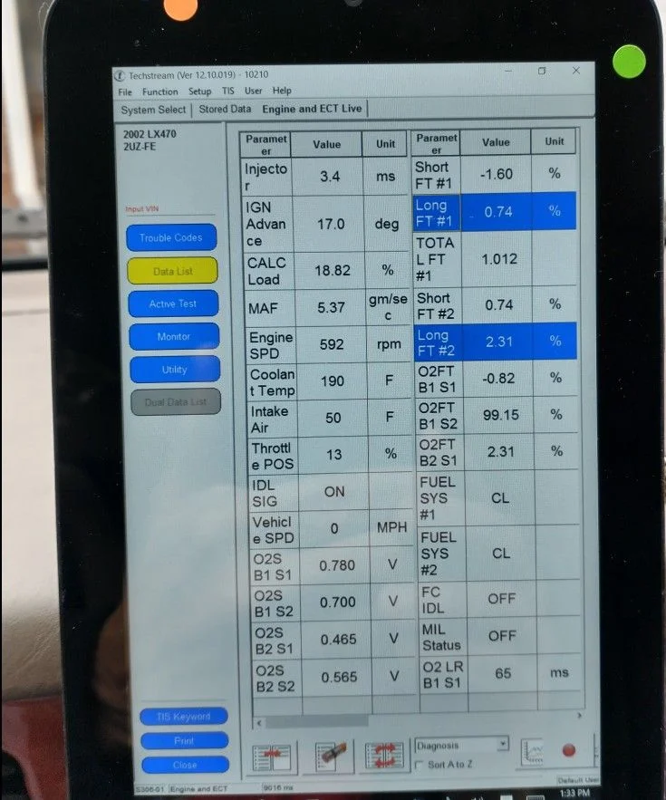

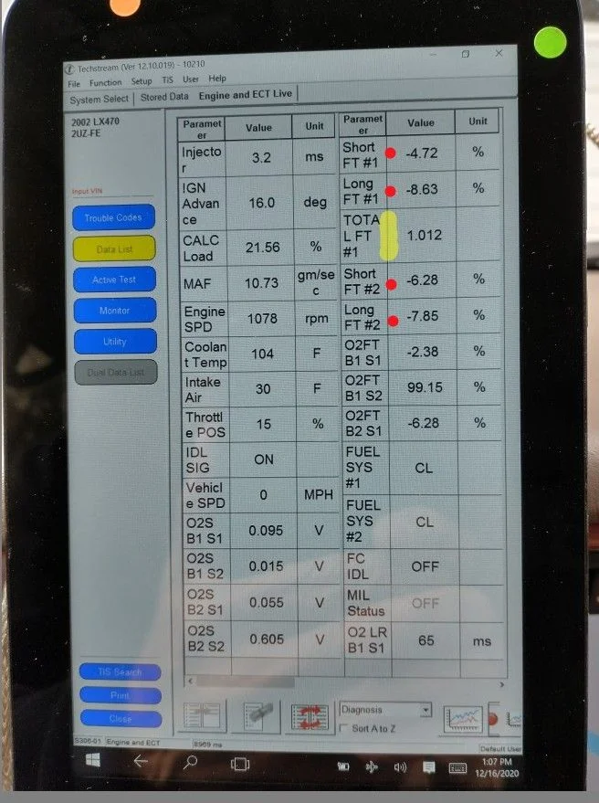

I got my Tech Stream Interface and Windows Tablet hooked up to my LX470 and I think I solved my LTFT problem.
With the old MAF sensor I was getting high negative LTFT reading - as high as -15.
The first photo shows the LTFT's with the old "Ebay Chinese" MAF.
The second photo shows the LTFT's with the OEM Hitachi MAF.
I remember 4 years ago replacing the the MAF with the Ebay part but can't remember the circumstances.
Whats curious is that one consistantly gives negative trims and the other consistantly low positive trims.
What confused me was what was this TOTAL FT #1 in Tech Stream which looked like what a LTFT number should be.
Old Ebay Chinese made MAF Sensor: Suspicious Long Term Fuel Trims.
OEM Hitachi MAF Sensor: Long Term Fuel Trims now looking like they should be.
Looks to me like TOTAL FT may not be a standard variable when it comes to "classic" understanding of STFT and LTFT.

Total novice on this topic, and havent finished the video yet; but comparing your MAF sensors, it seems the Ebay Chinese MAF is showing 10g/sec, double what the new one says. Could the faulty MAF sensor, thinking it had much more air then it did, cause the fuel trim to start pushing rich? Really cool to see that data comparison.
