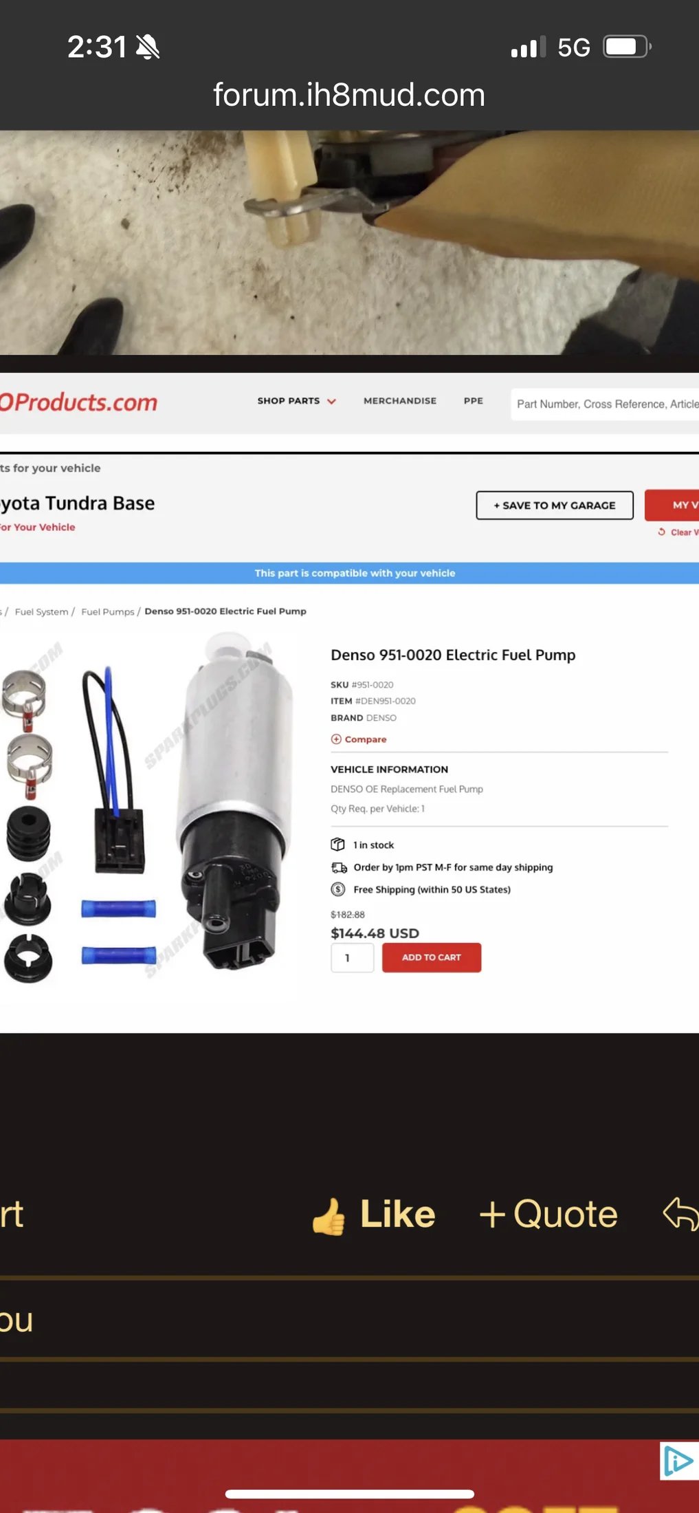

Here’s the Tundra fuel pump referenced above.
