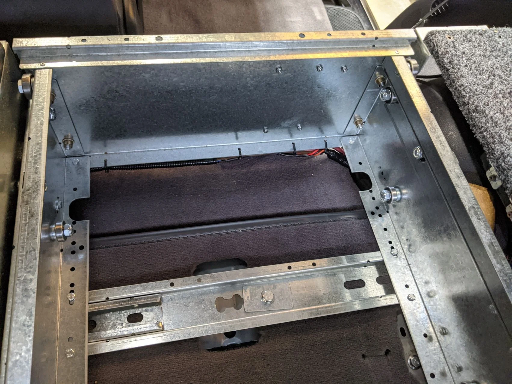

The pump access may be under the seat, but I see no way to get the carpeting pulled up and out of the way if you have ARB drawers installed. Pic I posted in one of the other threads, this is looking forward, that plastic strip is the seam between the carpeting sections. It's not clamping down on the carpeting, but there's very little room under there:

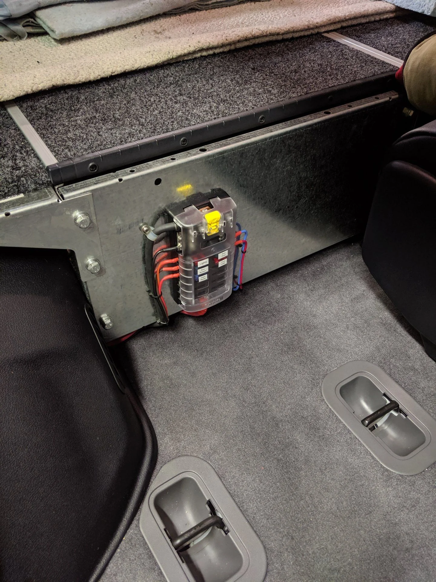

At the least, you'd need to empty the drawers, pull them out, then unbolt the chassis they slide in and somehow prop it up at the forward end. Then put it all back together. I seriously doubt any dealership is gonna wanna deal with that, and I wouldn't want them to anyway. You gotta be kinda fidgety when re-installing, and I'm not confident they would take the time I would want. And, in my case, the removal is more complicated since I have this going on:

I may be completely wrong, but I believe the "seam" is merely Velcro holding the two sections of carpet together. If I'm correct, it would hopefully be a simple matter to pull the passenger section apart and forward to access the fuel pump. I certainly hope this is the case, as I also have ARB drawers and don't look forward to removing them. . .
