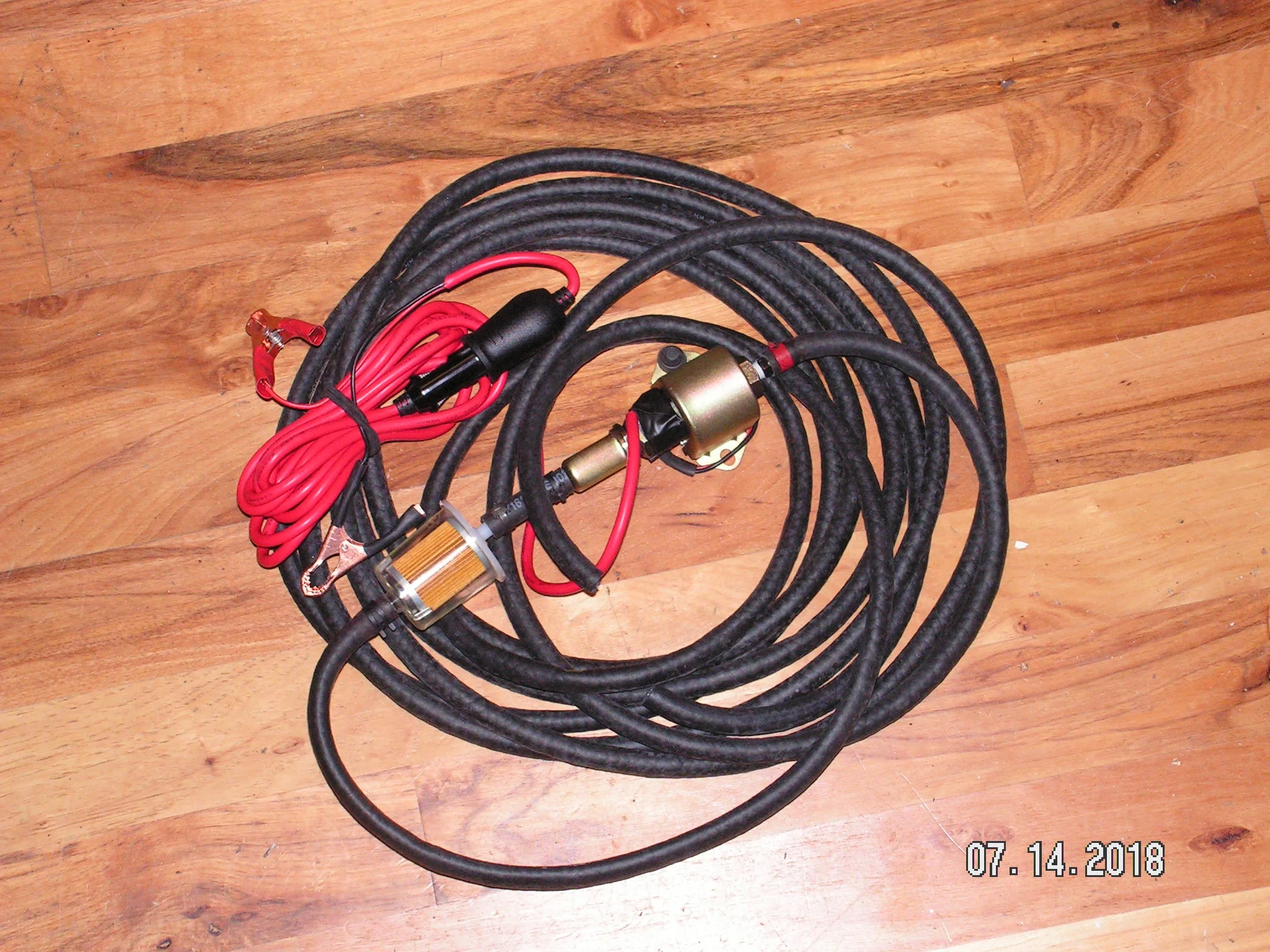

I like electric fuel pumps and have run them for years. Some were big buck units that didn't work very well or last very long.
I'm a big fan of the cheap diode pumps as they last for years. They are like $10 on ebay or Amoron. Years back I built my first fuel transfer device. I have made like a dozen and given them to family and friends.
About $50 a few years ago. Switched, fused 12' power cord that connects to either battery or cig lighter, filtered, 5' draft and 20' delivery. You can reverse the hoses to harvest fuel. Will also do diesel. This is the same pump I run on both Elsie and my F150

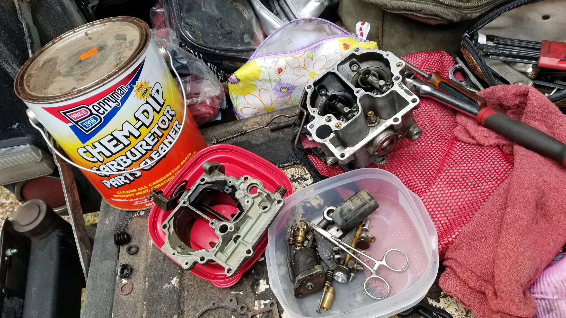

Looking down the barrel, it appears the AP is firing a shot in there..:-/. I’m gonna pull the carb and strip it down..maybe a slight blockage somewhere..

I used my drill kit to determine jet sizes and looks like my main and secondary are both smaller than the SOR jet chart for my year. Should I open them up to spec or a bit more? Maybe that’s a stumble off idle reason? Accel pump seems to be functioning properly. Carb is apart and passages blown out..

If the carb is apart I'd soak it while you order a couple carb rebuild kits. They usually come with more jets. Watch the Pinhead youtube videos and follow along in your FSM (or similar). I would not start drilling jets, they're hard to un-drill. Put the carb back together as close to right as you can and see if that helps. There are a lot of different causes for a stumble off of idle, rarely have I seen it be due to jets too small. Maybe put in backwards though (secondary in the primary hole for instance).

Solid info! Yeah, the carb is actually new, but one of those Amazon ones..I stripped it down and went through it all. I’ve rebuilt a few dozen carbs over the last couple decades, so I’m not too shy with messing around a bit..😬…I did drill the main a minuscule amount to match it to the SOR jet size list. It’s actually running pretty solid now! I also straightened the accel pump arm a tiny bit to activate it earlier, and that seems to have helped, too. Timing set to stock, then I dipped in a little more advance.
