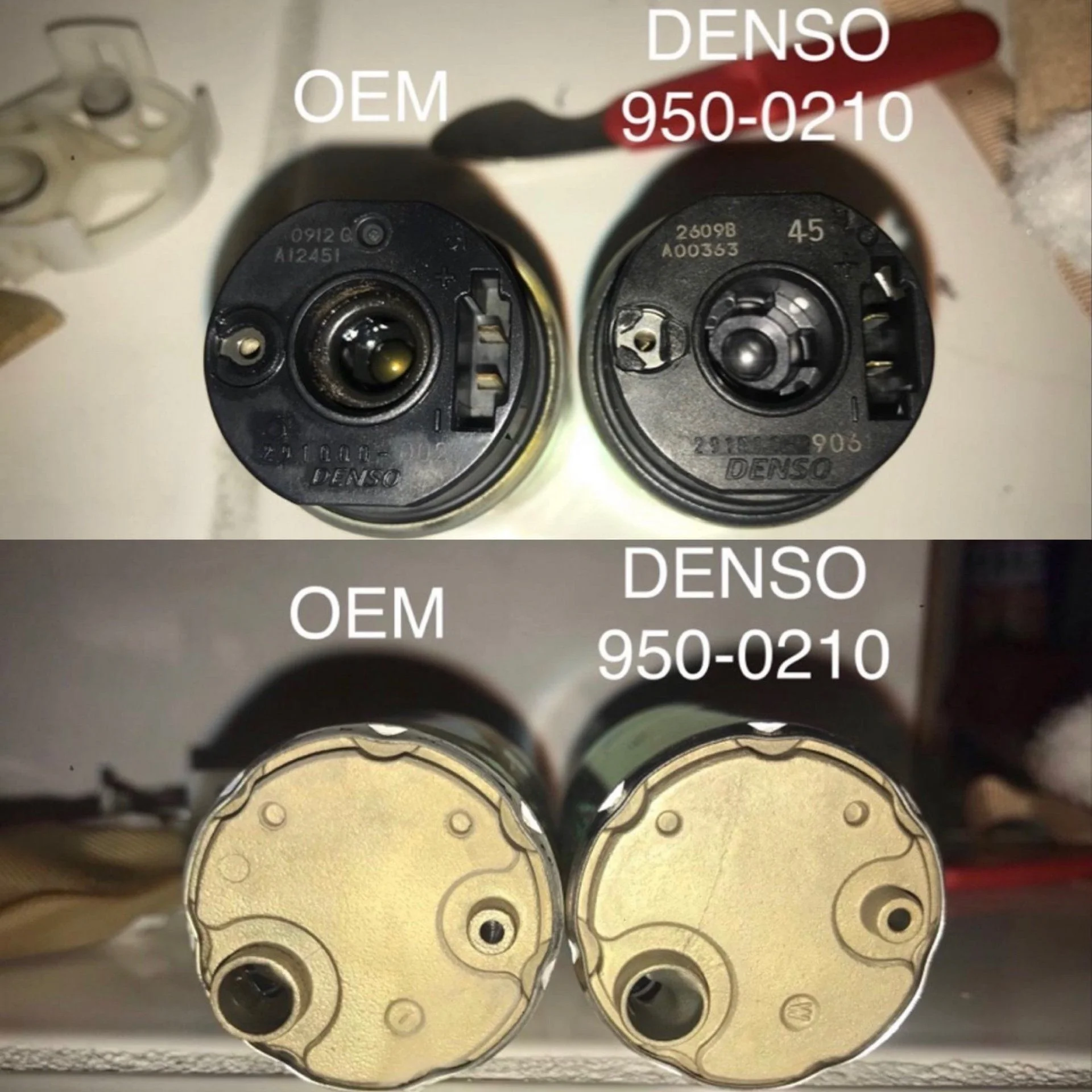

I'm having really hard time finding a replacement fuel pump. All the ones that I see that are supposed to be compatible differ in the following areas:
1) Electrical connection tabs are in series other than parallel meaning I would have to source a new plug and cut wires. See picture 1

Try- Denso 950-0210
$107 on RA
Denso offers with and with out. I dont recommend reusing the sock- the plastic fitting gets stiff being in the fuel for years and may crack, leak etc.

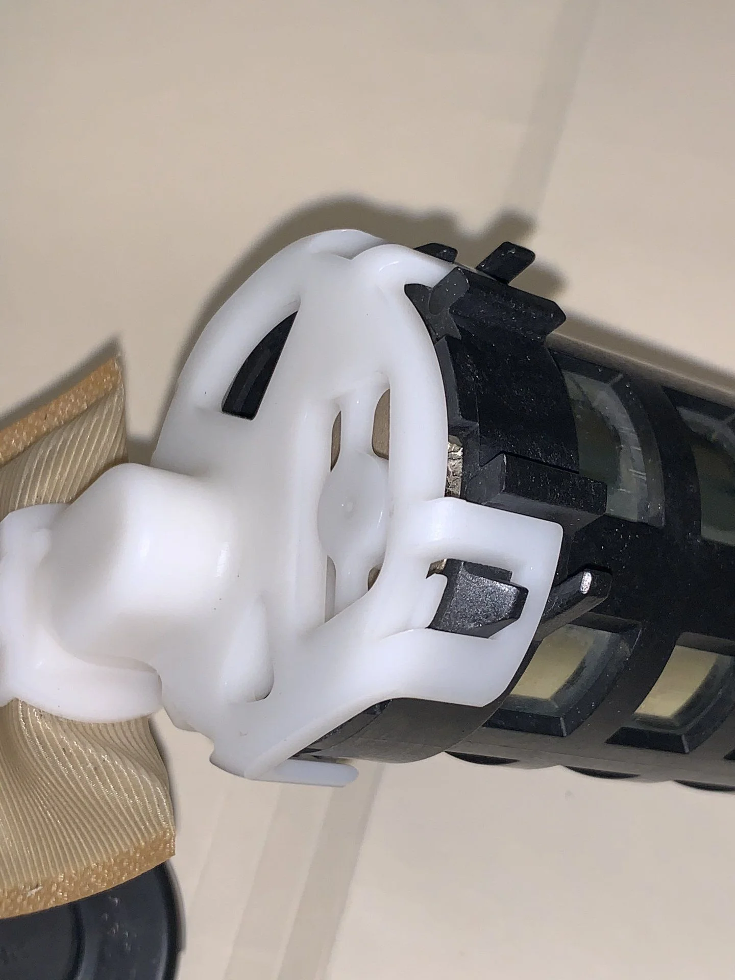

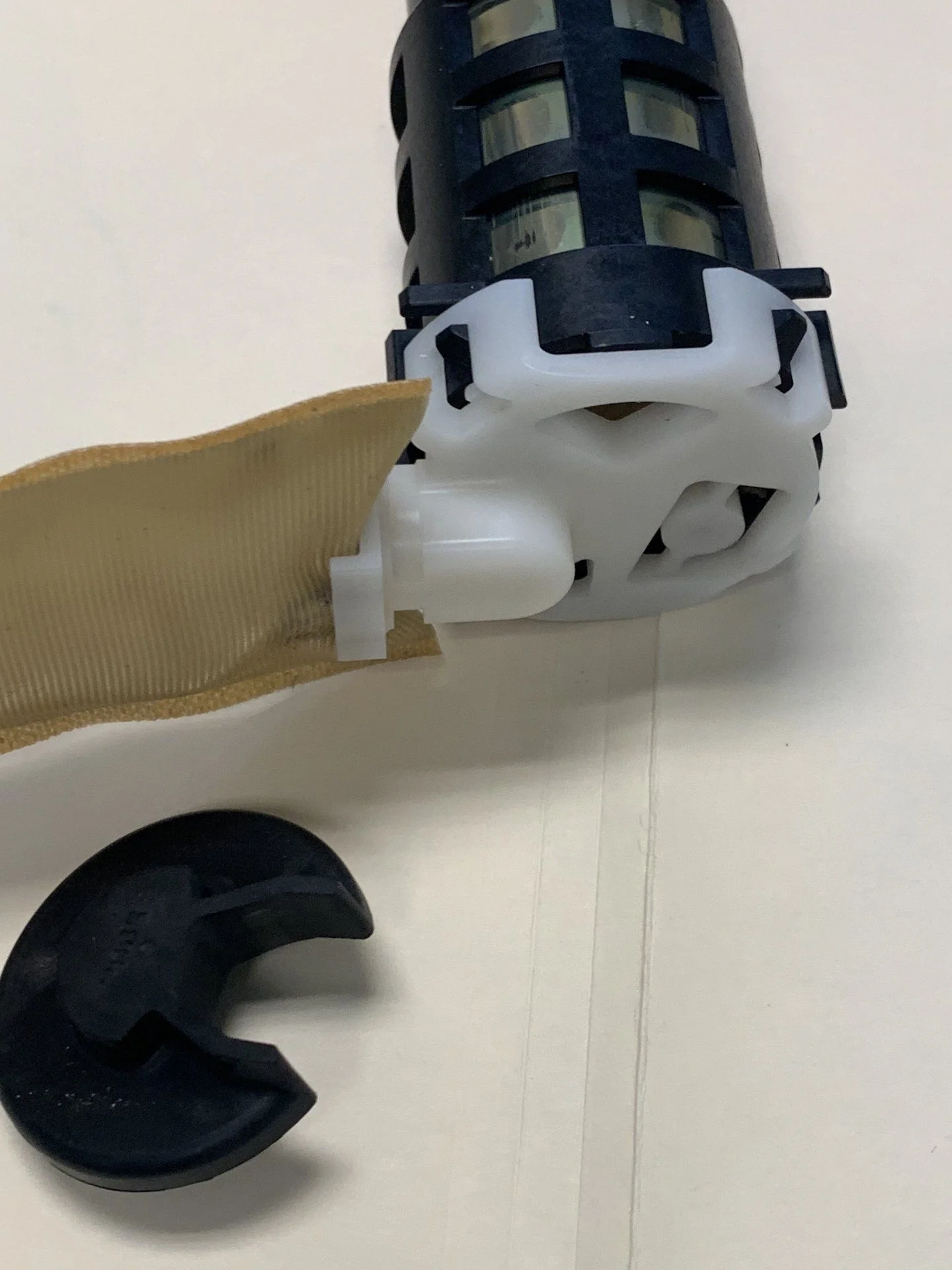

link to denso with fuel sock? I could not find that i just reused the old sock. also i thought today on my run that these fuel filters probably do 2x work because of the poor gas mileage on the truck!
P/n in post #8 is supposed to come with strainer (sock)
hmm ya thats what i ordered it comes with a pre filter sock but it is not nearly the same as oem, its not a "direct fit"
You will need to reuse the original with that Denso 950-0210. The filter it comes with is for the Sequoia. If you want/need a new filter, you will need to buy the assembly which comes with the new cage, sock, etc. and spend about $150 more. It is a tradeoff, but I have not had any issues reusing the original sock, but mine wasn't too dirty/clogged.
Yup that's what I did someone else said it came with a new compatible filter and that's when I got confused. Thank you. I reused the old one when I installed a month ago
