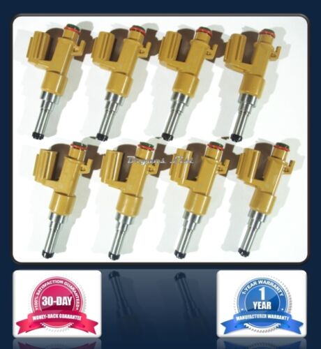

ALSO.. Found these on eBay seems to good to be true..
Went to Denso parts website and they don't make fuel injectors for our 200 series.... wondering what's the story. Anyone else heard of Denson Injectors? I have them for my coil packs, but can't find anything outside of Amazon and eBay for these.
