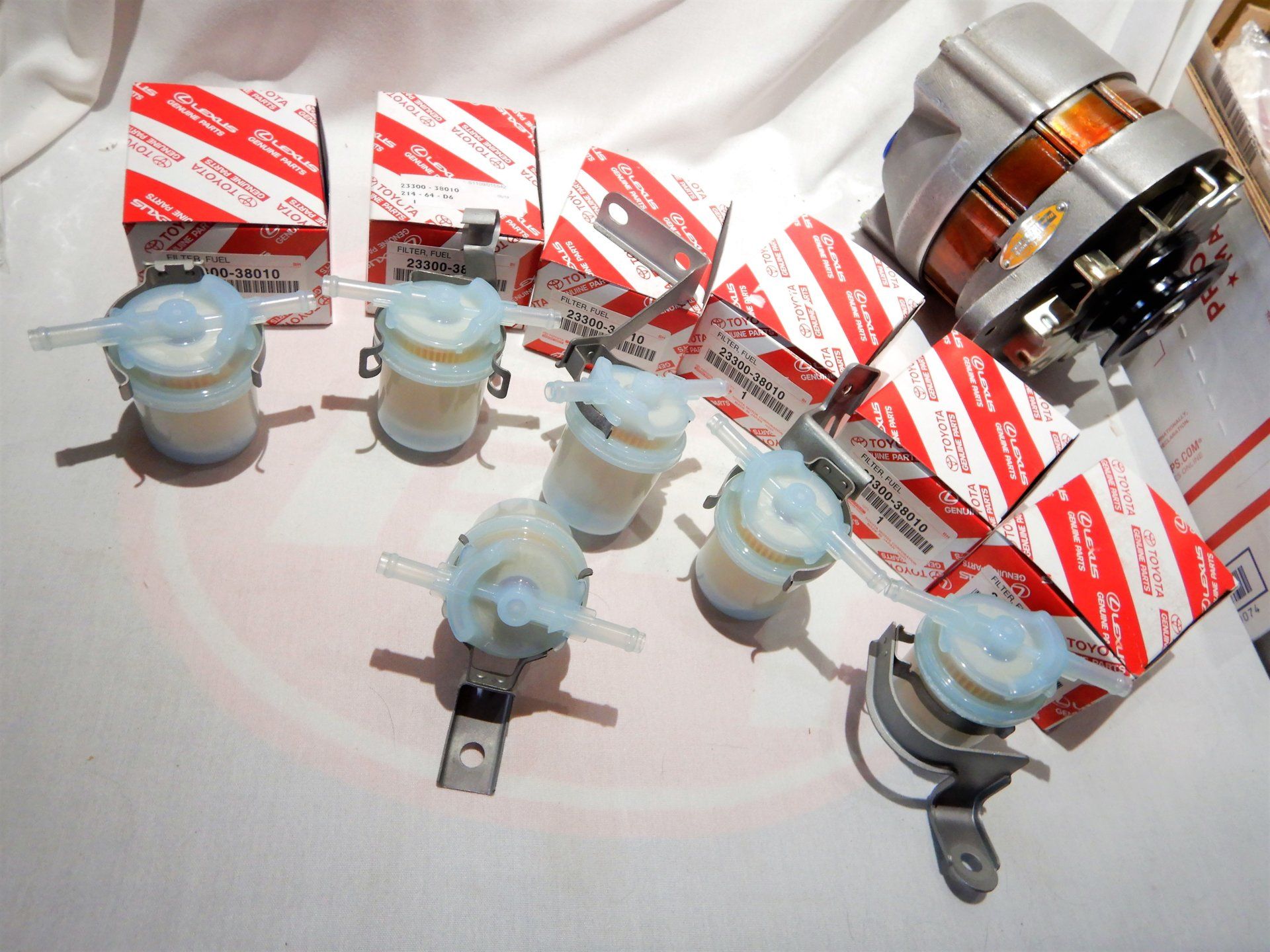

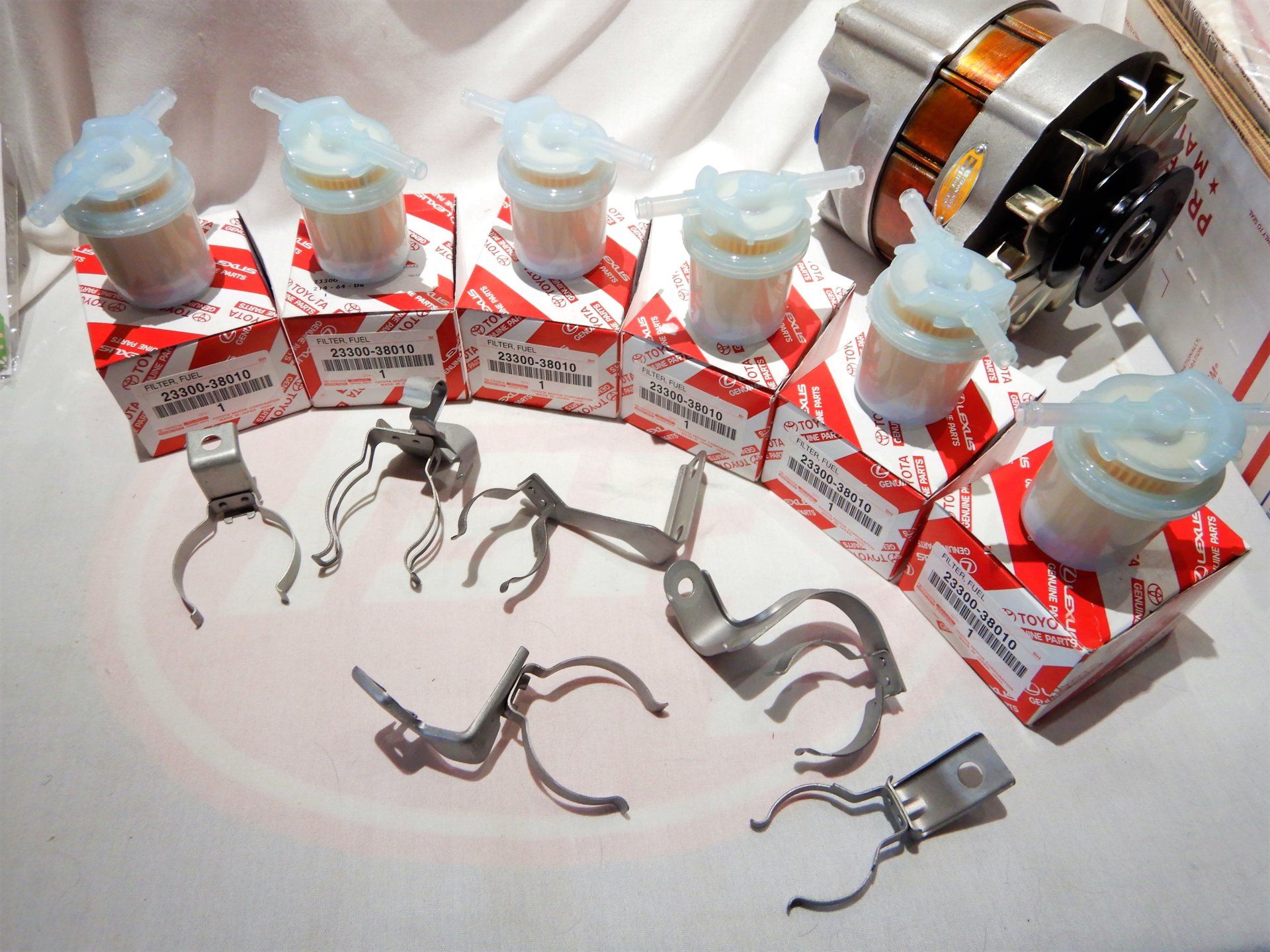

glad you caught the toque Rod out of the main Pivot Grommet , that could have been Evil , some times
they fall out due to a bad worn grommet or the 2 firewall bracket Bushings are smoked ........
give them all a good inspection , and if need be i have a Solution Below in the Link :

I was planning a Update Tweek to my Cushions Kit in time for the Holidays , By adding / including the
Carburetor Side Bracket wearable items also , the white bushing , Hair Pin , and thin wall fender washer
I guess that time is Now :D

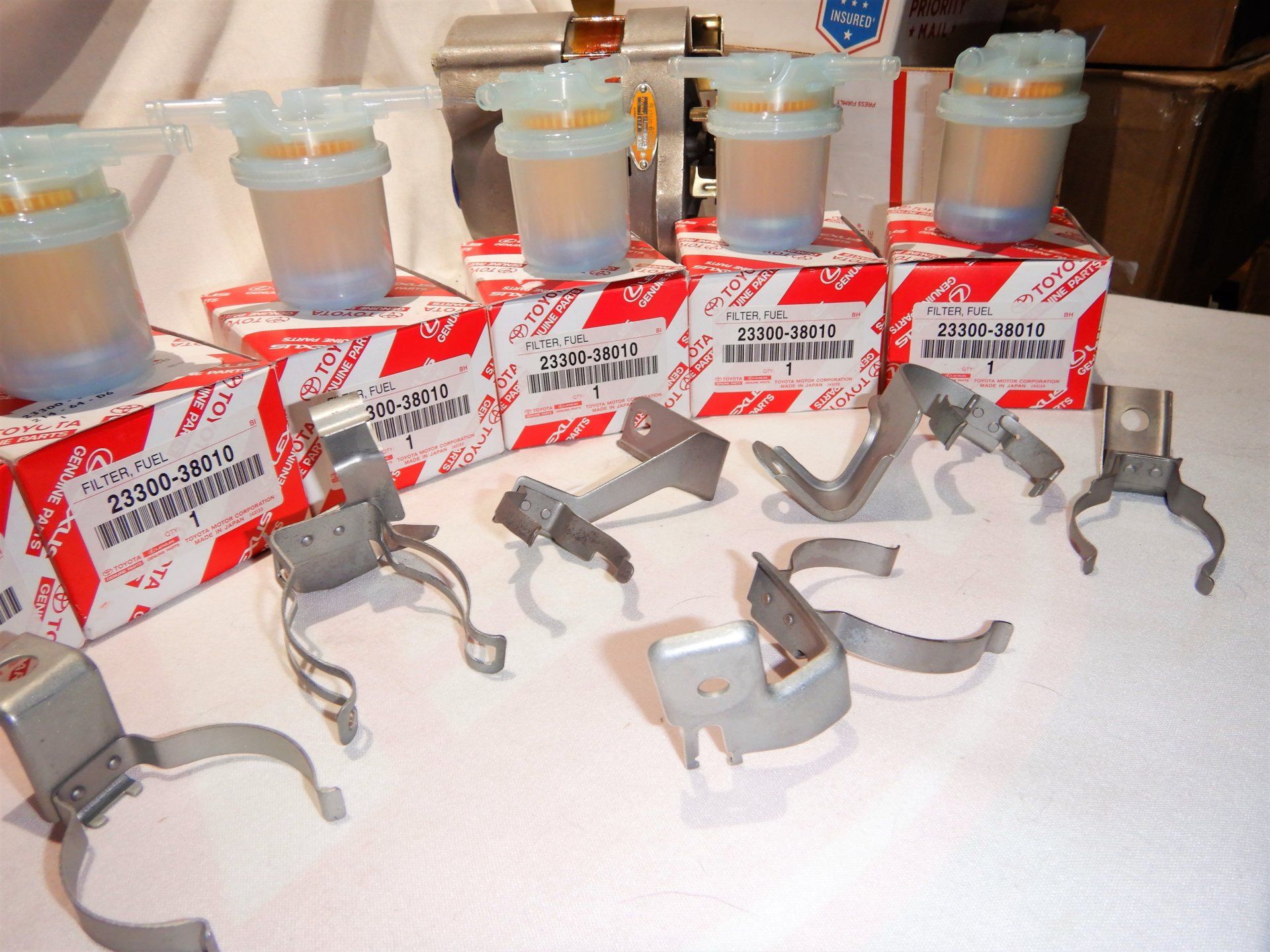

Hi ToyotaMatt,
Apparently the previous owner did not get the torque rod into the pivot grommet when he installed the Weber. Was a white knuckle experience when I got it running good enough to get it to DMV and register. Then figured something was wrong when I replaced that Weber with a rebuilt carb for the FJ, and spotted the issue. Grommets appeared good, but what the heck, sine I'm replacing about everything as to hoses, grommets, etc., might as well get this done now.
One thing I did spot in your fantastic photos is that I do not have that nylon bushing (3rd photo).
Thanks for the website. Now I have another source for parts. :)

If your looking for Very Descriptive TECH related Close-up Macro-Tripod-Shots , well look no further 💫
the 23300-38010 is the Only way i Roll , Its diverse and can be mounted on almost ANY TOYOTA
Carburetor fuel filter Stand or Bracket ............
its got the Most Filter Media of any carb TOYOTA filter assy. and a extra large Reserve capacity and
translucent see thru container ............
