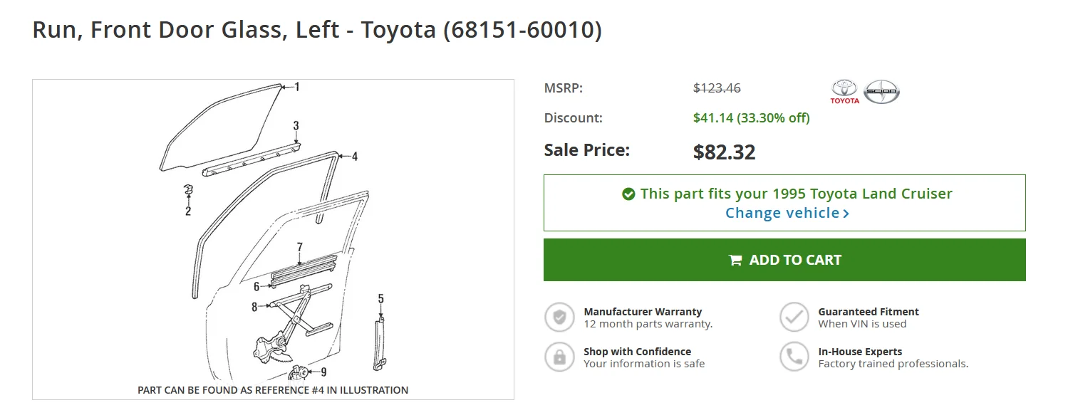

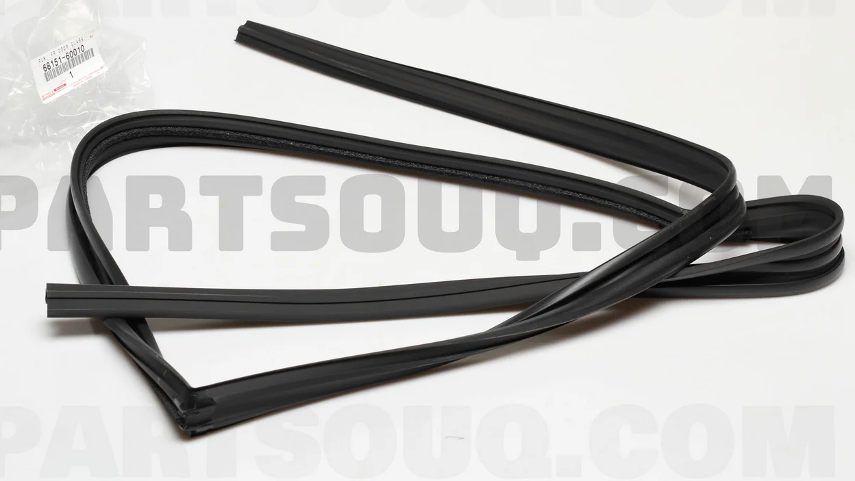

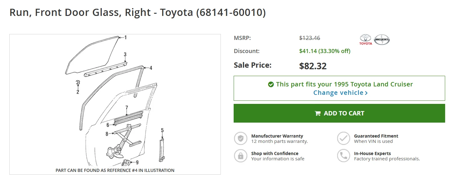

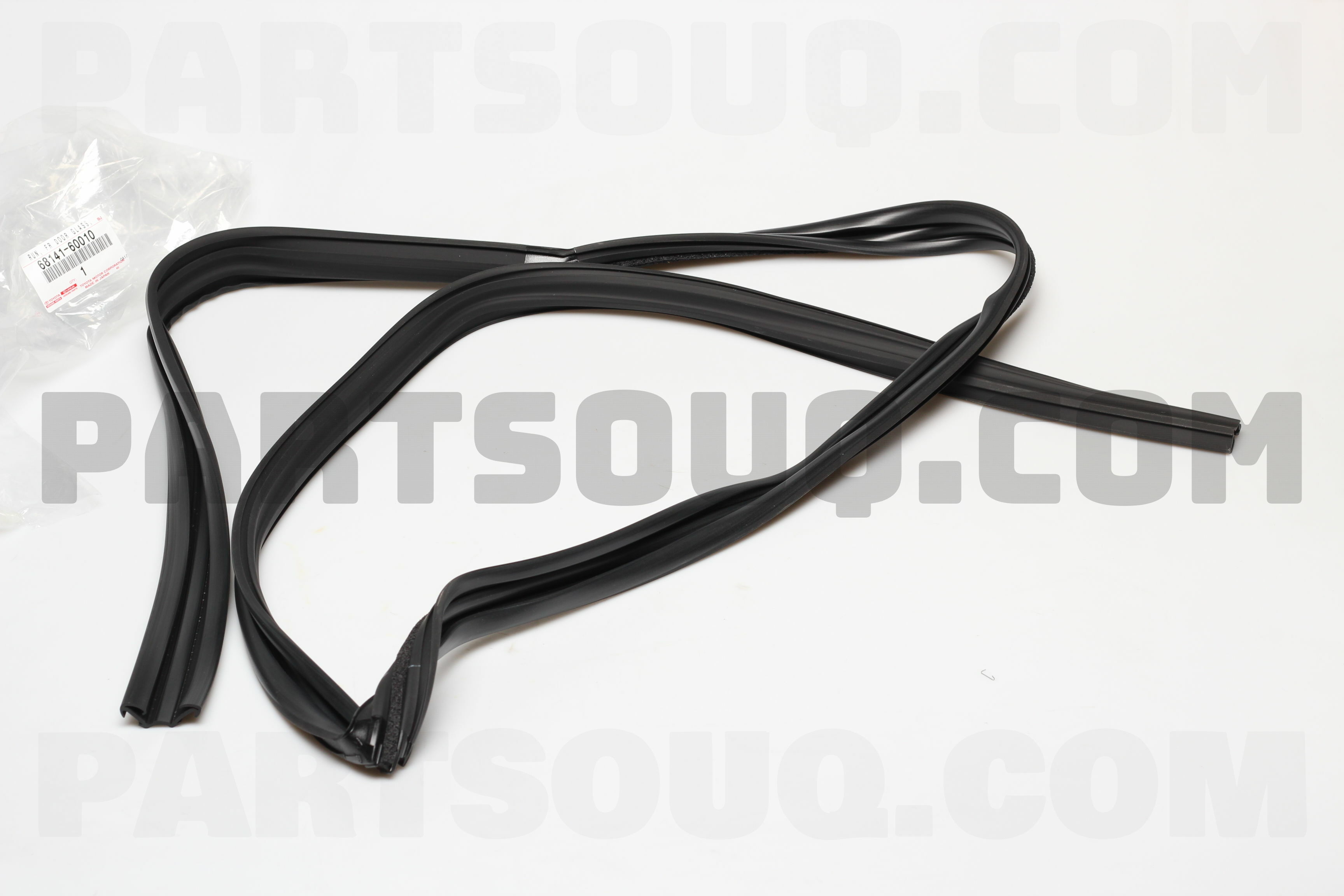

You need new rubber; it's called window channel run:
PartSouq lists it for $55, but they only have the right side currently. Shipping for something this light shouldn't be much. You might save $10.

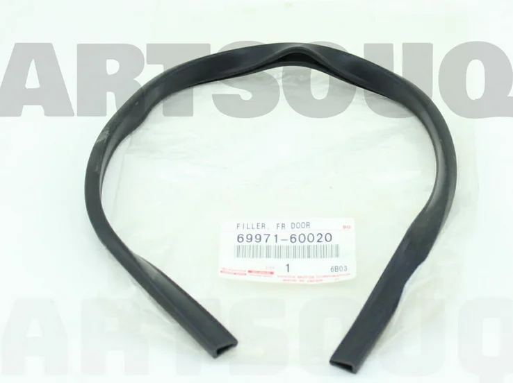

You also probably need the insert in the lifting frame; it called front door glass channel filler:

I opened her up and made a video, you guys are saying the window runs are what is causing it to be loose like this?
At first, I thought you didn't even have any window runs. I'm skeptical that your window is even seated in the glass channel (the thing that connects the glass to the regulator arm).
Pull your door card and plastic liner off and inspect. It's maybe a half hour job.

No, I'm saying that the clunking was so bad that I didn't think you had them until I saw the rubber strips on either side.
Your window isn't attached properly. Either it's come out of the glass channel or, as others have said, the regulator assembly isn't screwed down. You shouldn't be able to see the edge of your glass like you can in the video.
Since this appears to be a front window, maybe your window has slid forward in the channel enough that the back edge is barely contained within the channel run.
This gets confusing because there are two channels being talked about: the window run channel that goes up the sides and the glass channel that supports the glass from the bottom.
This is the glass channel (or channel sub-assembly), and it has a rubber insert that grips the window glass:
This is the door glass run (or door glass channel run, or window channel run), it's the seal inserted into the perimeter:

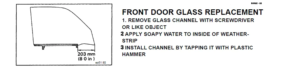

The window glass needs to be positioned into the channel at the bottom according to the FSM:

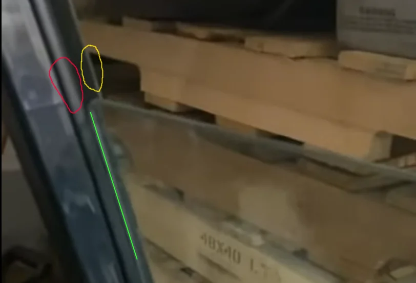

@Francis K looking at it again with fewer beers in me, it really looks like the outer lip of the window channel run is completely missing.
The area circled in yellow looks like bare metal. The area circled in red is what both sides should look like.
I maintain that the edge of the glass should *not* be visible, as traced by the green line.
