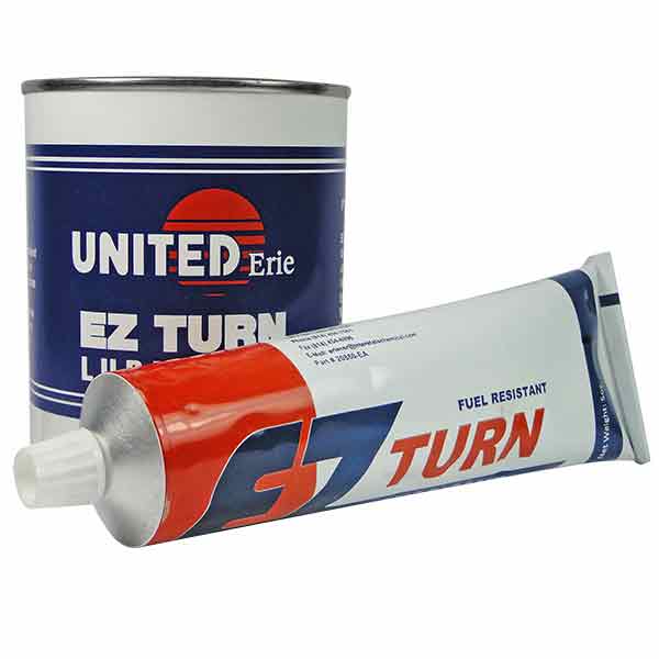

When i use to work on aircraft fuel systems i used a special grease made to work around fuel without being dissolved, or washed away by contact with fuel, Below you'll find a link to where you can buy a 5 OZ tube of that fuel system grease

EZ turn is what I also used on my second-go at installing the fuel rail. Pinched an o-ring the first time around and it leaked just as you describe. new orings from toyota and a bit of ez-turn to lube them for install worked great.
Hey everyone, thanks for all the help. I got ez turn and new orings. It ended up being a pinched oring on that injector. I started up the LC for the first time in about a week and I noticed a significant amount of exhaust coming from the tailpipe. The amount died down after I drove it around streets in my neighborhood so I’m hoping/thinking the excess exhaust is just a result of the engine getting more fuel than what it’s used to and the ecu needing to reset/water vapor from sitting for so long. I’ll post again if the significant amount of exhaust persists. Anyway, thanks for all the tips!
