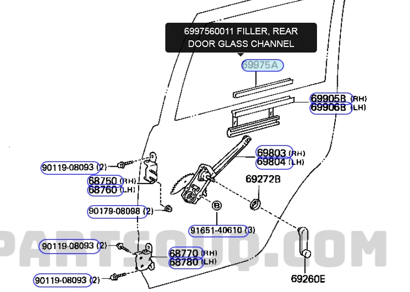

This is the problem:
replace it.
Not available from partsouq. Anyone found any? (Also, any more info besides "this?")
I've disassembled everything and see that the track looks more out of adjustment as anything, this part visually appears fine?

FWIW, if it doesn't clamp the crap out of the glass, it's not right. It takes a hammer to insert the glass.
Which dealer? Mine doesn’t have anything in that diagram available. (Not considered a reliable source anyway.)
Follow up - reading elsewhere it seems item 10 (glass channel in FSM) actually needs replaced along with it which is the discontinued part I definitely can’t find. Just item 9 (glass channel filler) appears easier to source.

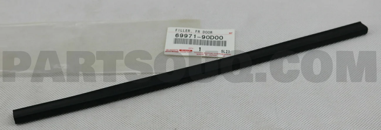

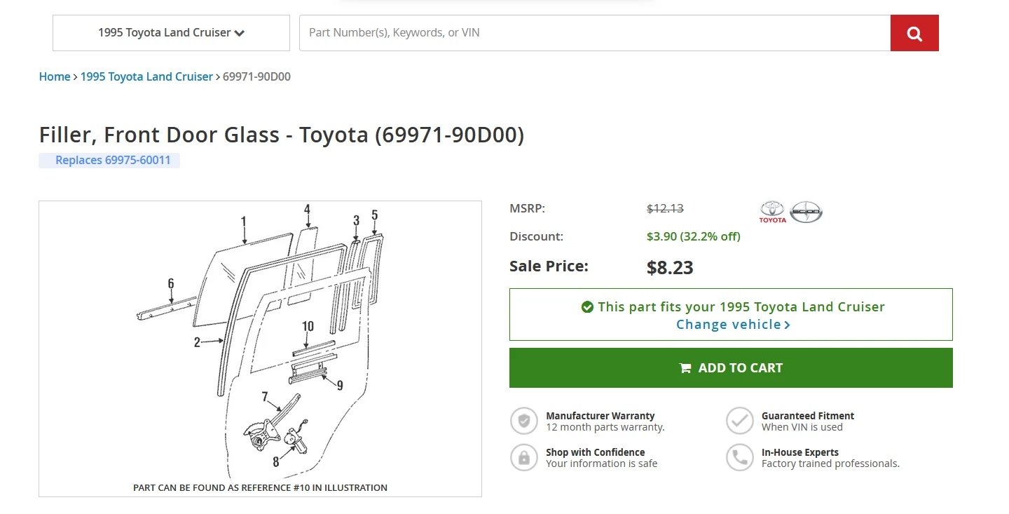

No dealer will have 80 series parts in stock, unless they're still used on current models. Any dealer, including the e-commerce sites, will be able to order it, and the storefront dealers will be able to get most parts, like this one, next day.
You only need the part I gave you the part number for.
