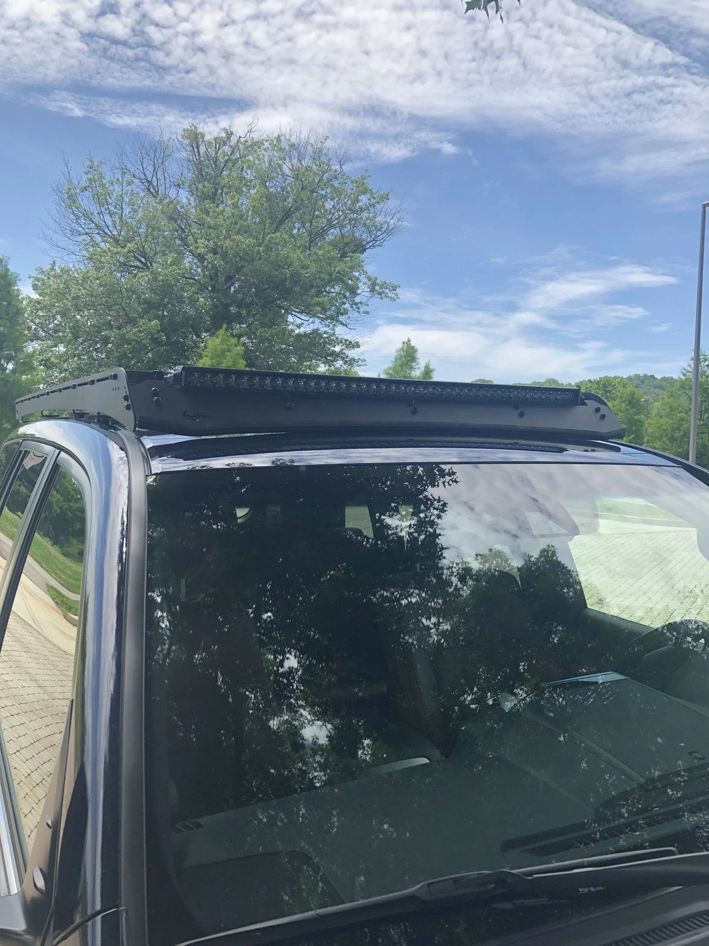

Eric at Ed Martin installed my Prinsu and I really like how quiet it is. I registered 63-65 decibels with sunshade open and closed at 70mph. Identical numbers before roof rack. If you open the sunshade you can hear the wind a little from flowing over the fairing but not enough that I wouldn’t drive with my sunshade open. When closed, it’s dead quiet. Anyone considering the Prinsu, I would recommend the fairing and noise reducing edge guard. I am 100% happy with my Prinsu and have already received compliments. Thanks Eric for your recommendations!!

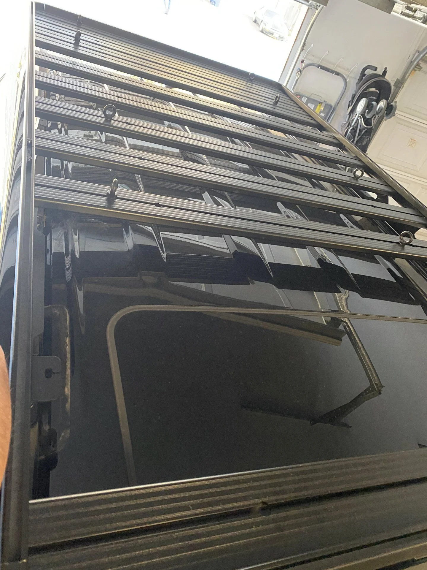

It’s adjustable just had mine put on this week and had them put 4 together in the back to create a small platform ... then the others are about 6” a part and then I had them leave an opening for the sun roof.. my understanding though is once installed not adjustable unless you take it back apart to a certain level....

Could you post a slightly further away pic of just the front section? Or let me know how many slats are in front of the sun roof as well as the number that aren't installed directly above the sunroof? My rack is here Wednesday and I was going to get the tray assembled before my Cruiser gets here at the end of the month. I was planning on doing the exact same thing to leave an opening for the sunroof and put the extra slats at the back.
You are correct that it would need to be disassembled to a fairly decent point to add or remove slats after the fact. On the Front Runner racks the slats fit into the side rails by about 1"; the only way I could imagine to add or remove would be to take the entire tray off (leave mounting rails attached to roof) and then you'd need to undo the slats on one entire side and pull that side rail off. I think you might be able to take the side rail off while it's on the truck, but it wouldn't be as easy.
