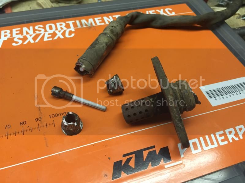

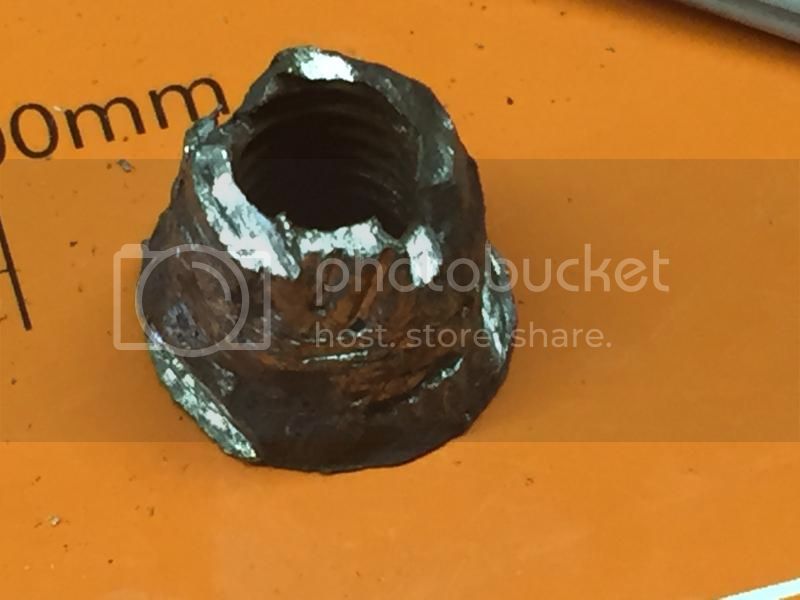

Did mine recently on my 3rd gen and they looked like this
I used a Dremel with a flexible extension with a small grinding wheel. I basically cut them in half until I was at the threads, stuck a flat head screwdriver in there and hammered away. Worked like a charm, nuts came right off.
Used an M8 x 1.25 die to make sure the threads were good on the studs and installed the new sensor.
