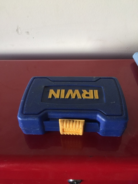

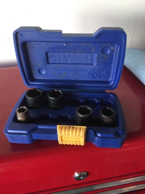

Do you mean these? I forgot all about them.
I read on a couple of threads of people using some kind of degreaser on the connections for the o2 sensors. Thoughts? Recommendations?
One of the things i found that may help you AFTER you remove the factory original nuts is to replace them with Brass nuts. In the future when you have to remove the O2 sensor you'll have no problem removing the brass nuts since they won't rust fast to to the stud. I use to do this to all my customers exhaust systems when they brought them into my shop for work. In the long run it saved both me, and the customer time and money, by not having to drill, tap, thread, or weld to repair broken or striped steel studs, not to mention the cost to remove a head, to remove a broken exhaust stud. McMaster Carr has a really good selection of all different thread sizes for brass studs and nuts.
Yeah, those are the bolt removal tools I used. They bite at lot better than the craftsmans I returned.
