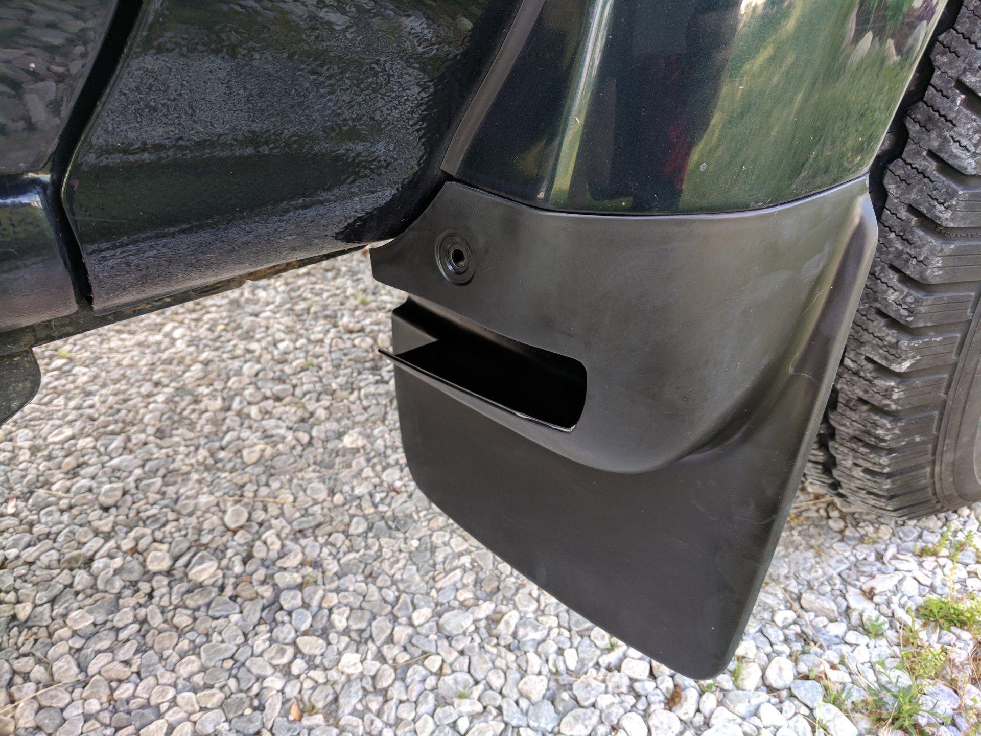

I removed the running boards from my 94 FJZ80 and attempted to add front mudflaps in their place but received the wrong parts. The mudflaps received have cutouts for the running boards. Ack! Can you help? This is what I ordered, where did I go wrong?
76603-60011
Mud Guard
90159-60416
Screw W Washer Tapp x4
76604-60011
Mud Guard
90189-06196
Grommet Screw x2
This is what the parts guy recommended. Do you know what the correct part numbers are?
He knows, trust me. He is just trying to get you using the search function. There are two types of mudflaps. The ones you got and the other type that doesn't have the cutouts. They are hard to find used because most 80s in the US came with the running boards.

Any idea what the part numbers are for the correct ones so I can exchange them? The cruiseryard link doesn't have part numbers :-(

I found this one: front mud flap???
Looks like I need 76603-60021 and 76604-60021
Sorry for bugging you.
Yes, I believe those are the right numbers. This site works better on a laptop. I get the bedazzling too on mobile.
