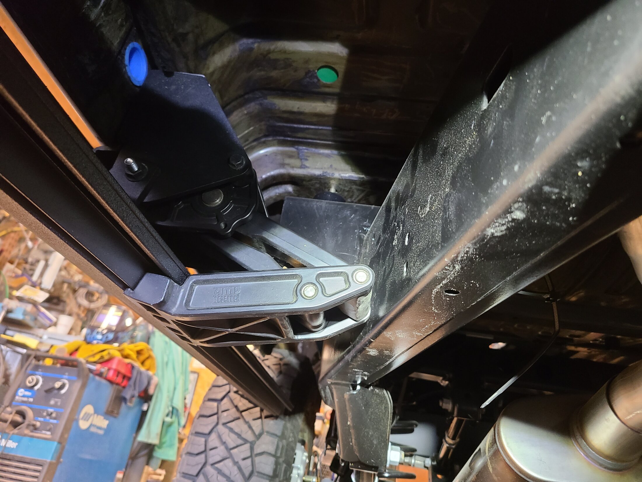

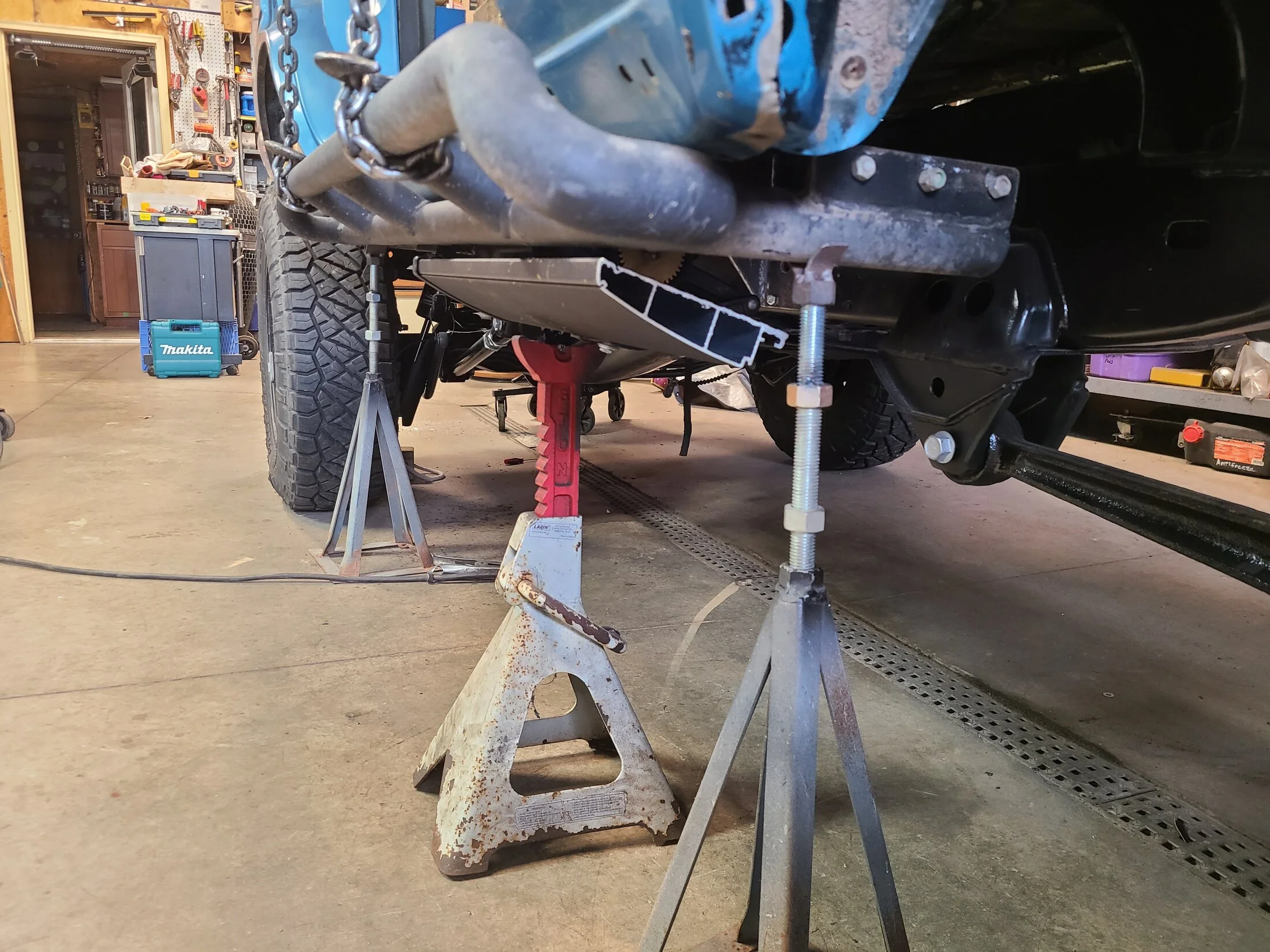

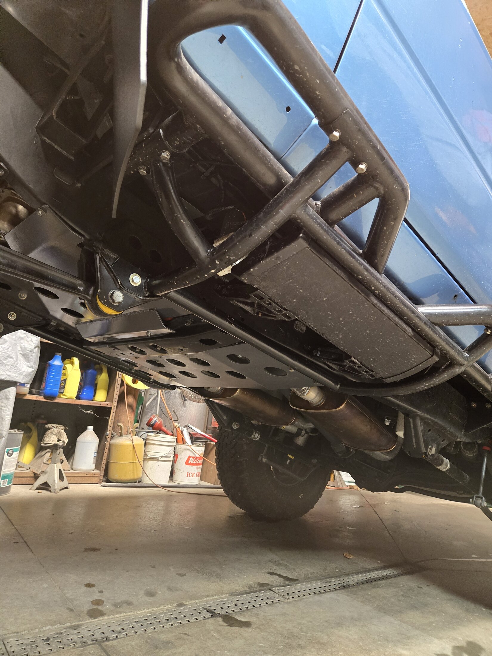

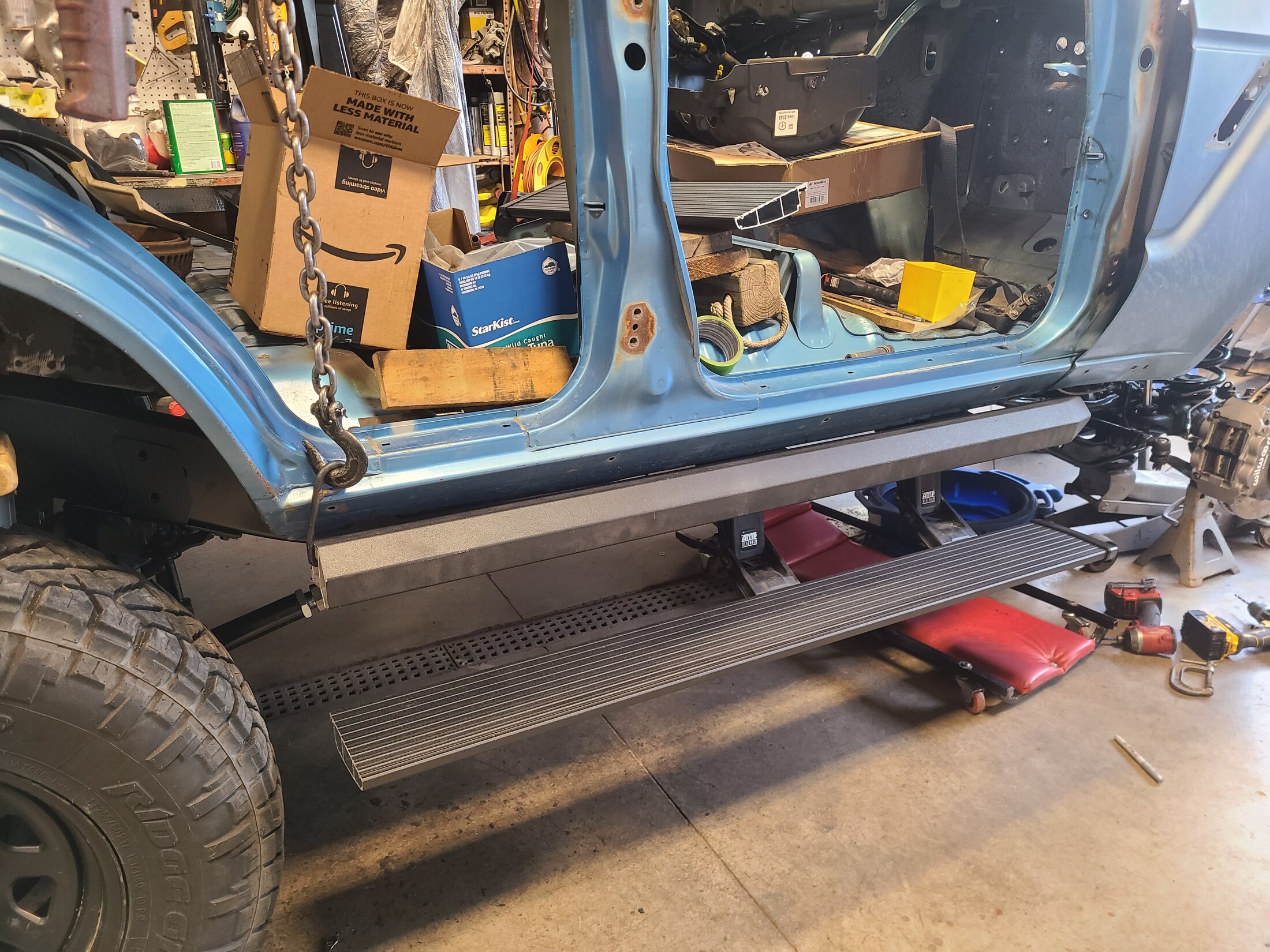

I made my own brackets for just a short step section , rather than the whole length.
I started with a set made for an f150 I think. But with the tapered frame, the rearmost bracket is under the front door. That's a lot of overhang for rear door coverage.
Here's some pics. Disregard the 60 body🤪
You'd have to find someone willing to take on the project.
Here's some pics. Disregard the 60 body🤪View attachment 3881949

Corky, maybe the width of the 80 body would allow that bracket to be a little further back. But thats the limitation that keeps them out of the market, i believe.
Thank you all. I'll keep that in mind. I'm pretty good at fabricating. This mod is further down the list, but I want to see what options there are.
