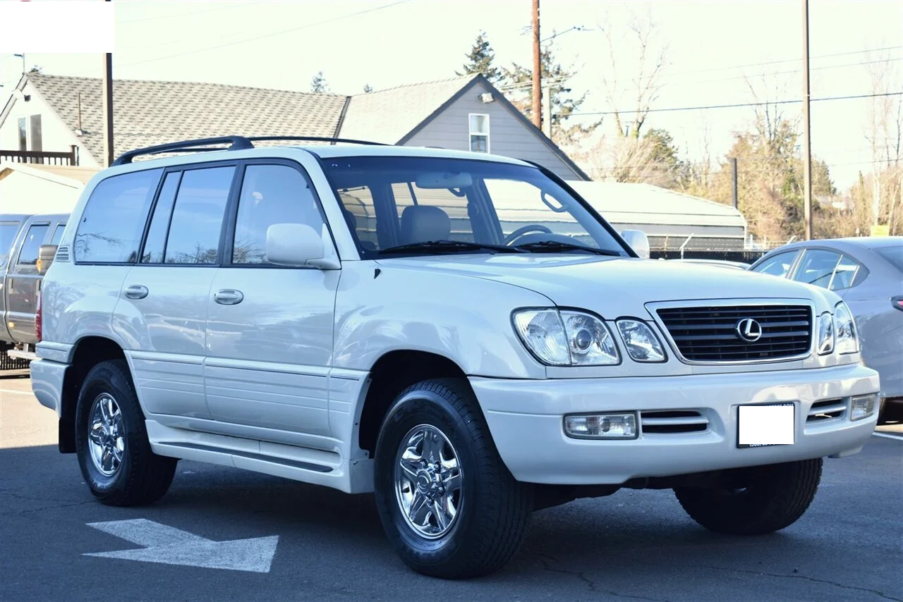

Hello! Thanks for reading. My new LX470 sat for 7 years, presumably in LA. 94,000 miles, dealer maintenance records until the hight 80s. When I got it the whole undercarriage smelled hot after driving. After 500 miles it's just the front left wheel now. That disk reads about 10 degrees Fahrenheit warmer than the right usually. That seems too low for a hung up caliper? I'm not familiar with this style of bearing. Is it likely the grease separated or got contaminated and I am cooking my bearings? Should I be worried? It's the family "minivan" so I don't want it to leave my wife on the side of the road when I'm at work.
