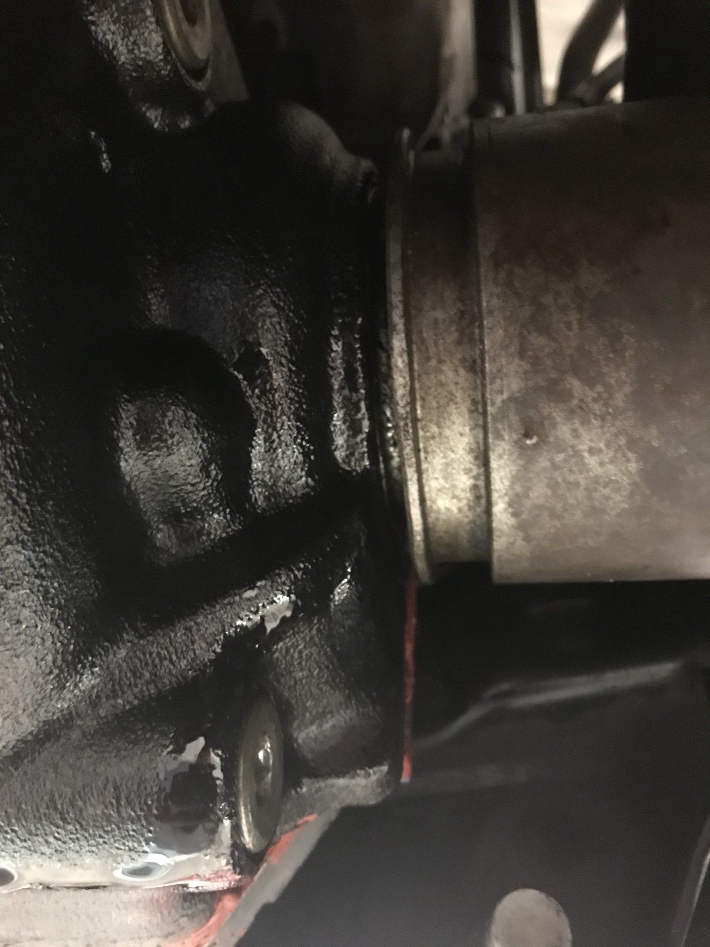

I do want to revisit the dealer replacing the passenger diff seal a month after the axles with a note "If the leak returns the diff bearing will need attention." That's why I thought it may be internal and beyond my capabilities.
You can see the line of fluid dripping past the drain plug. At this time it's not terrible, but I want to resolve.

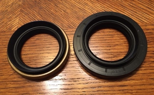

I was just trying to verify what seals I need for the sides of front diff when my new OEM CV axles show up. Napa said they are the same part number and ordered me 3 (one extra) of these:
Differential Pinion Seal - Front Axle
Part #: OSN 27SS3715
But the Lexus diagram shows 2 different seals 43420H and 43410M
Lexus parts now shows part numbers 90311-47013 for LH and 90311-47012 for RH.
If Napa is wrong, my CVs can't go in this weekend and I the family can't leave for our trip.
Please help!
Please help!
They are NOT the same seal. One side is much larger than the other.
Also, the NAPA seals WILL leak on you. Even if not immediately....they will soon.

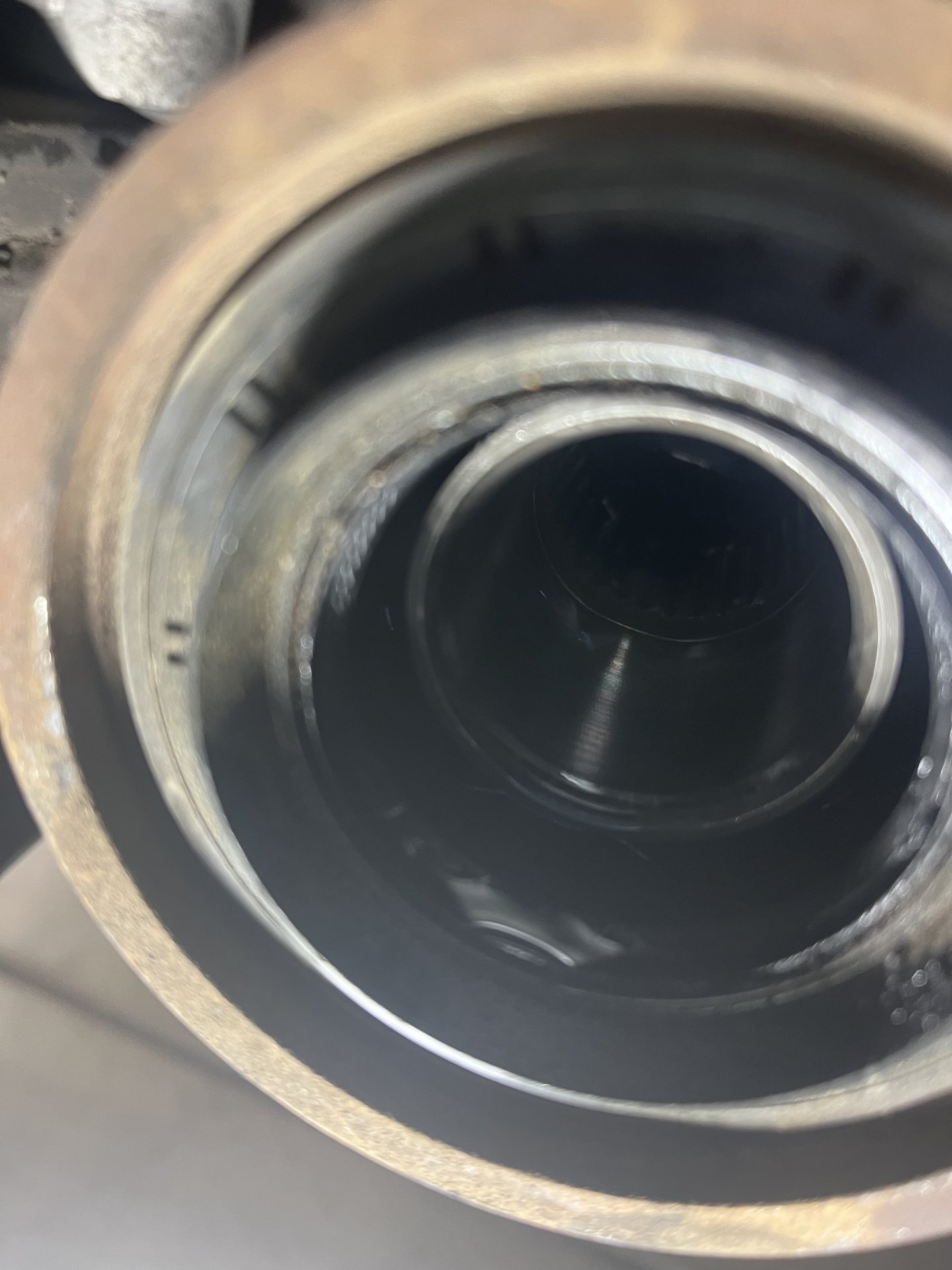

Does the new seal seating correctly? Should push in bit more?
Pics of new and old. Thanks
