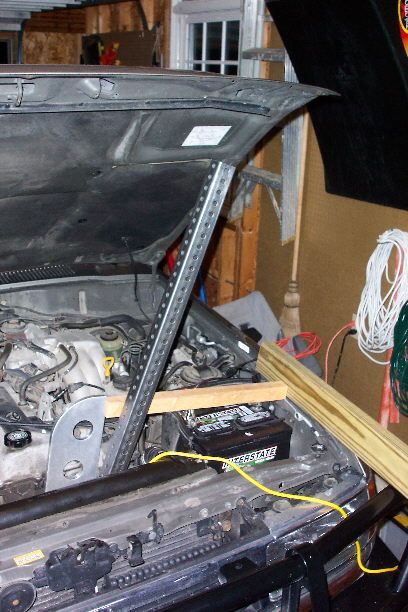

I ended up making a tool after all, braced it with some wood, several feet of cheater on the 3/4" drive. I'm sure I got 300# of torque.
