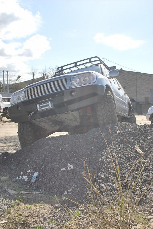

This guy did it (in Russia).
https://forum.ih8mud.com/100-series-cruisers/373778-cranking-torsion-bars-3.html

You could run the 200 Series shocks upfront with a custom adapter for the upper shock mount, that's what the Russians did. I will Skype Tamberlan tonight and see if I can't get a pair shipped. I am concerened about the travel, the 200 Series has 9" of wheel travel upfront, which means the 100 Series upper A-arm, CV and LCA will have to travel an additional 2.5" over stock. I have a feeling it's not the uppers or the lowers that cause the limited travel, I feel that the torsion bars take away a lot of potential, even in stock form with the lower shock mount unbolted, the front end can droop another 2-3" before the UCA comes in contact with the shock body. I haven't exactly checked if there is any binding, but the front end did spin freely at full droop.
