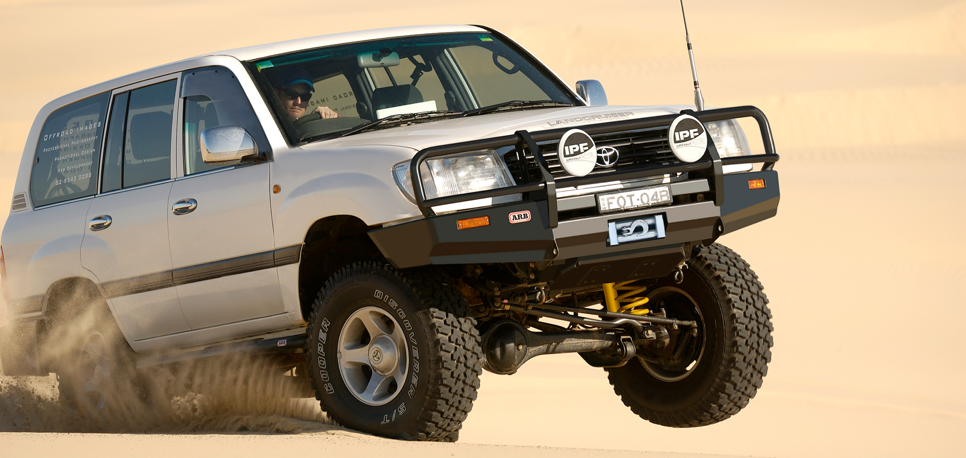

Looking at the front suspenion of the 100 series and how robust the upper shock mount is, got me thinking that we could run coil-overs up front... basically, the AHC is a hydraulic version of a coil over... what do you all think?
I'd especally like to hear from Christo or the other vendors/experts what they think of this idea... any reason why it wouldnt work?

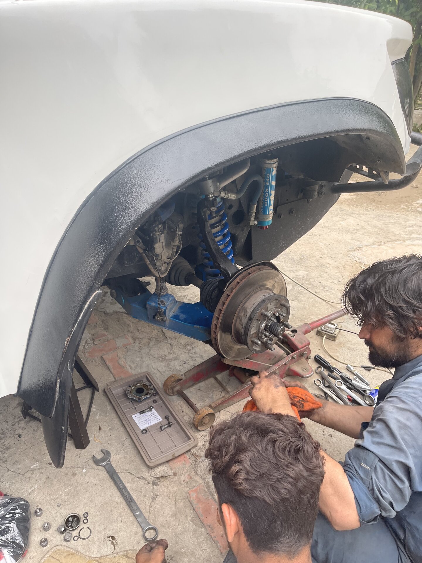

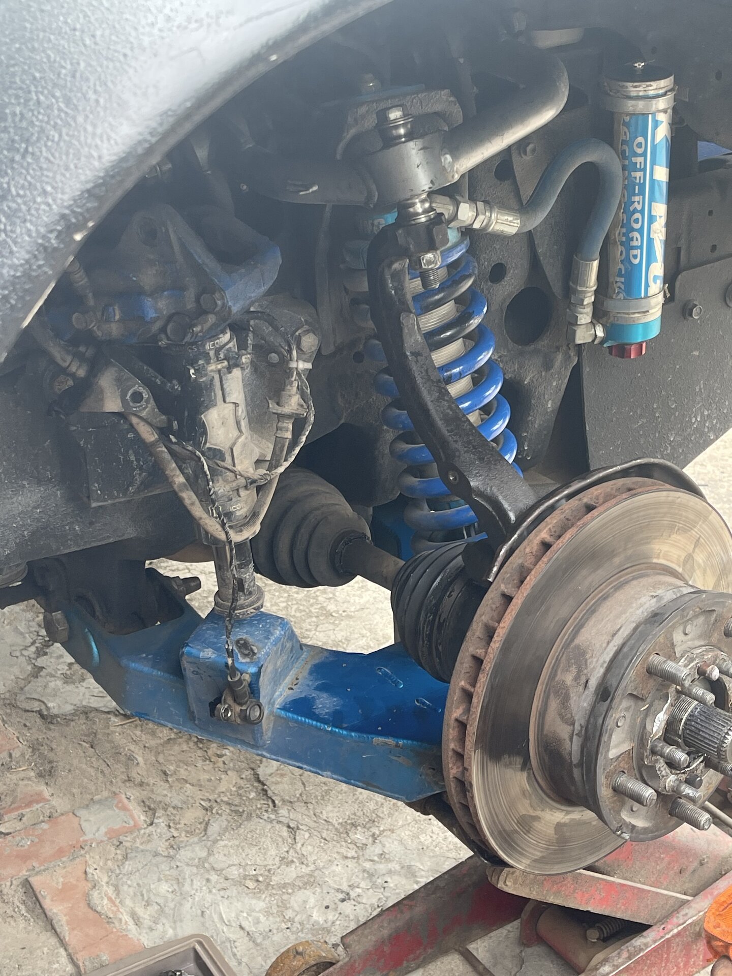

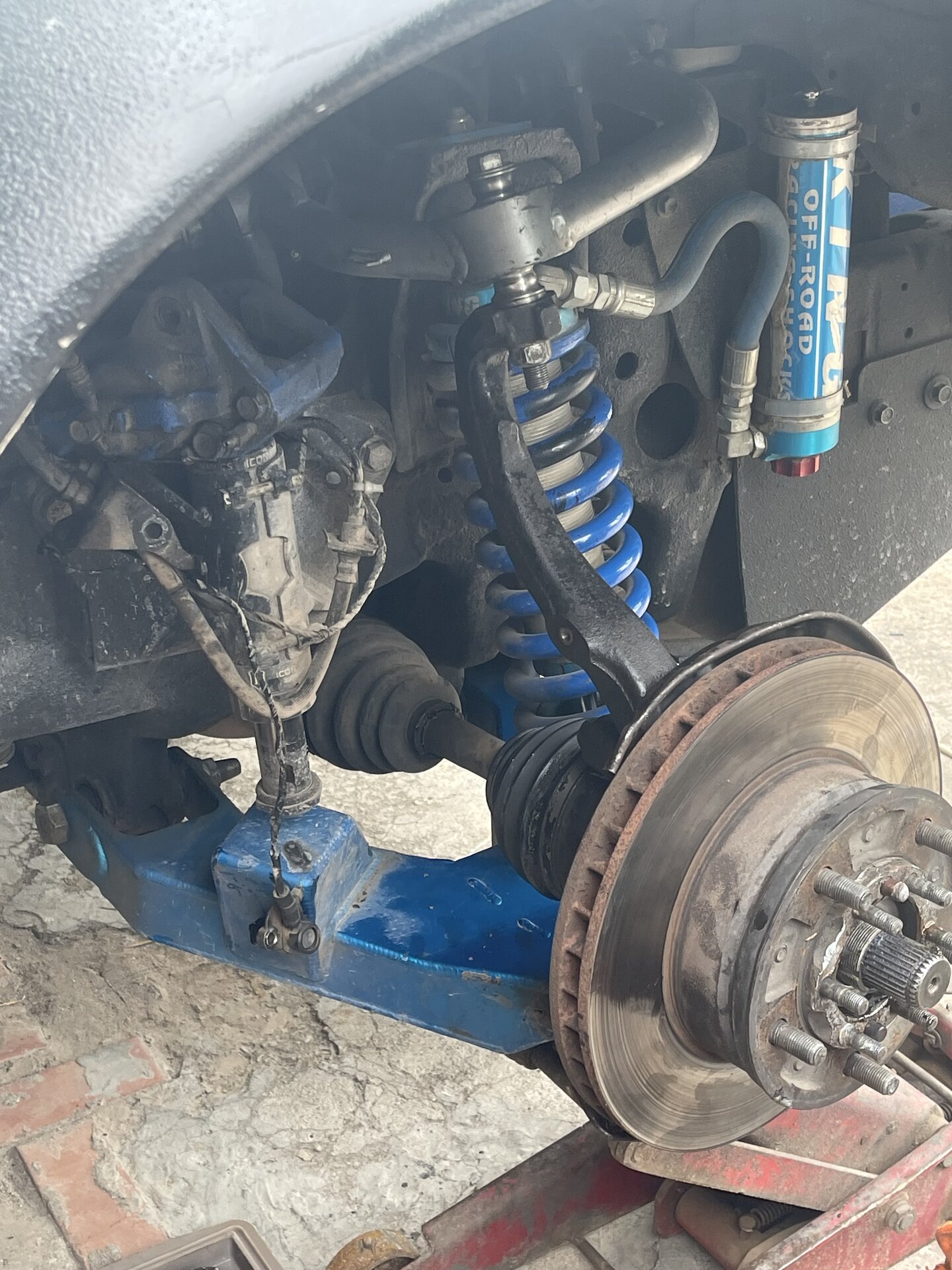

I have done the conversion, deleted torsion bars in my 100 series IFS and installed kings 2.5 coilovers. The only issue I’m facing is the steering axle and boot is rubbing the spring of coilovers at a particular angle. In the shared pictures you can see that steering assembly tie rod axle is too close to the coil spring
What to Do !? I’m thinking of giving one inch spacers to steering box foundation
If you gentlemen have any ideas pl respond
I have fabricated the lower arm, so it’s wide then stock stronger and sturdy then stock, the only issue I’m facing is how to create space between the shock spring(coilovers) and steering axle boot and axle
I going to foundation of steering box and trying to give spacers out there
Pl let me know what to do to sort this issue
While there isn't much room, you may be able to create a cradle for the rack and shift it forward 1". I tried to find pictures of your "100", and I'm pretty sure with what you have done with that frame, creating a cradle for the rack is not going to be tough for you. I may be in Lahore at some point in the next 12 months, where about in Pakistan are you?

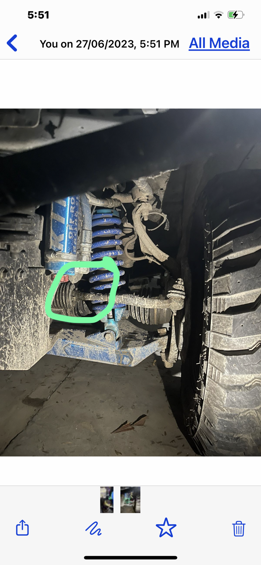

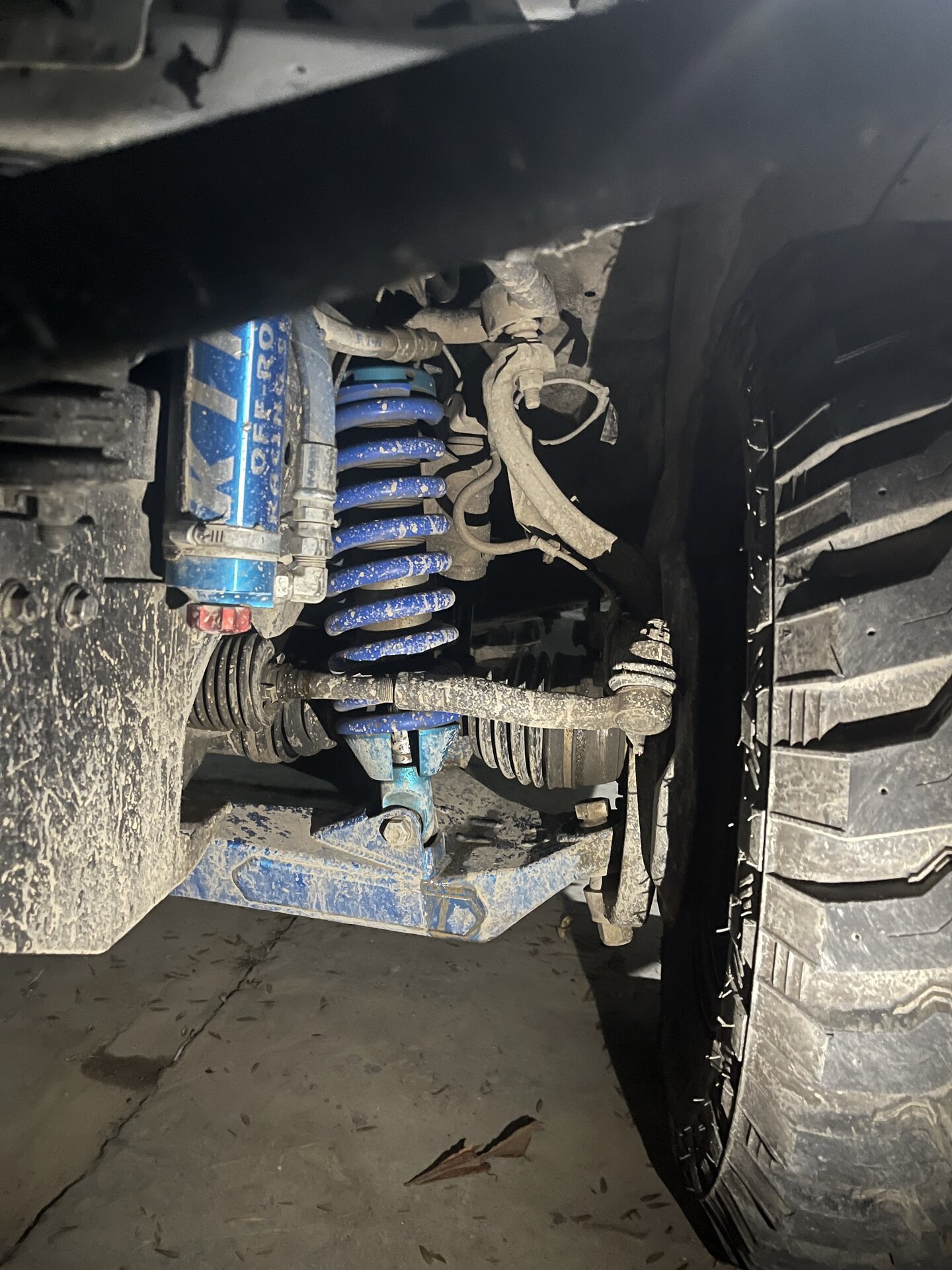

Front drive shaft is way to close to the springs of coilovers and on full cutting boots of front drive shaft press against the shock springs which in turn pushes back words. Would any gentleman respond to this issue ….! How to fix this problem ????
