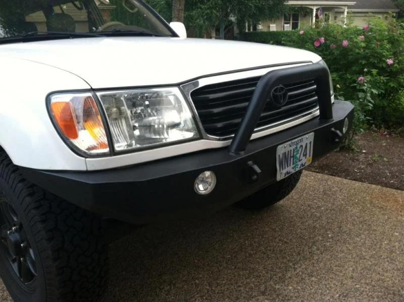

Charger1... did the fabricator who built your bumper chop the frame at all? Did he build a winch mount - behind that license plate?
Yours appears to much less overhang than the off-the-shelf bumpers...

He didnt say if he cut any off just that he boxed in the end and i didnt think to ask. He designed it so when i do get a winch we can do some notching and reinforcing so it will drop in without having to pull it forward. I'm toying with the idea of having a receiver welded in instead and using the warn cradle so i can use it in back if i want.
Charger1 : that is one of the best looking bumpers I have seen for the 100 series.
I agree! I'd even be fine if that one protruded another few inches. Very nice work. Charger 1 - would you post up a profile shot? Thanks!

Some pics as requested
Looks great. Although I'm no expert in this field, shouldn't there be a bit bigger gap between the bumper and fenders to allow for flexing??
