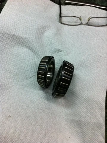

Koyo bearings cleaned up, how can I assess their condition?
