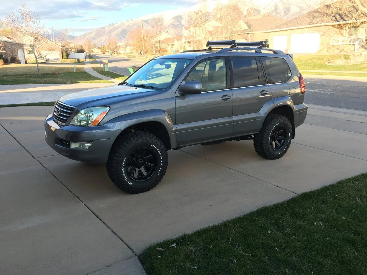

Do you have any pictures with the Ultra 195 mounted?
Yes, but I've been saving them for my build thread...
Here is one spoiler...
