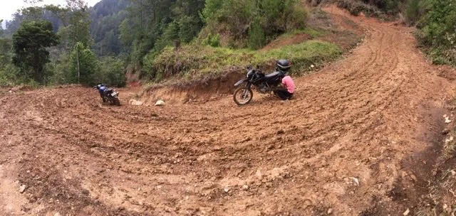

BTW this is one of the roads I drive weekly.
