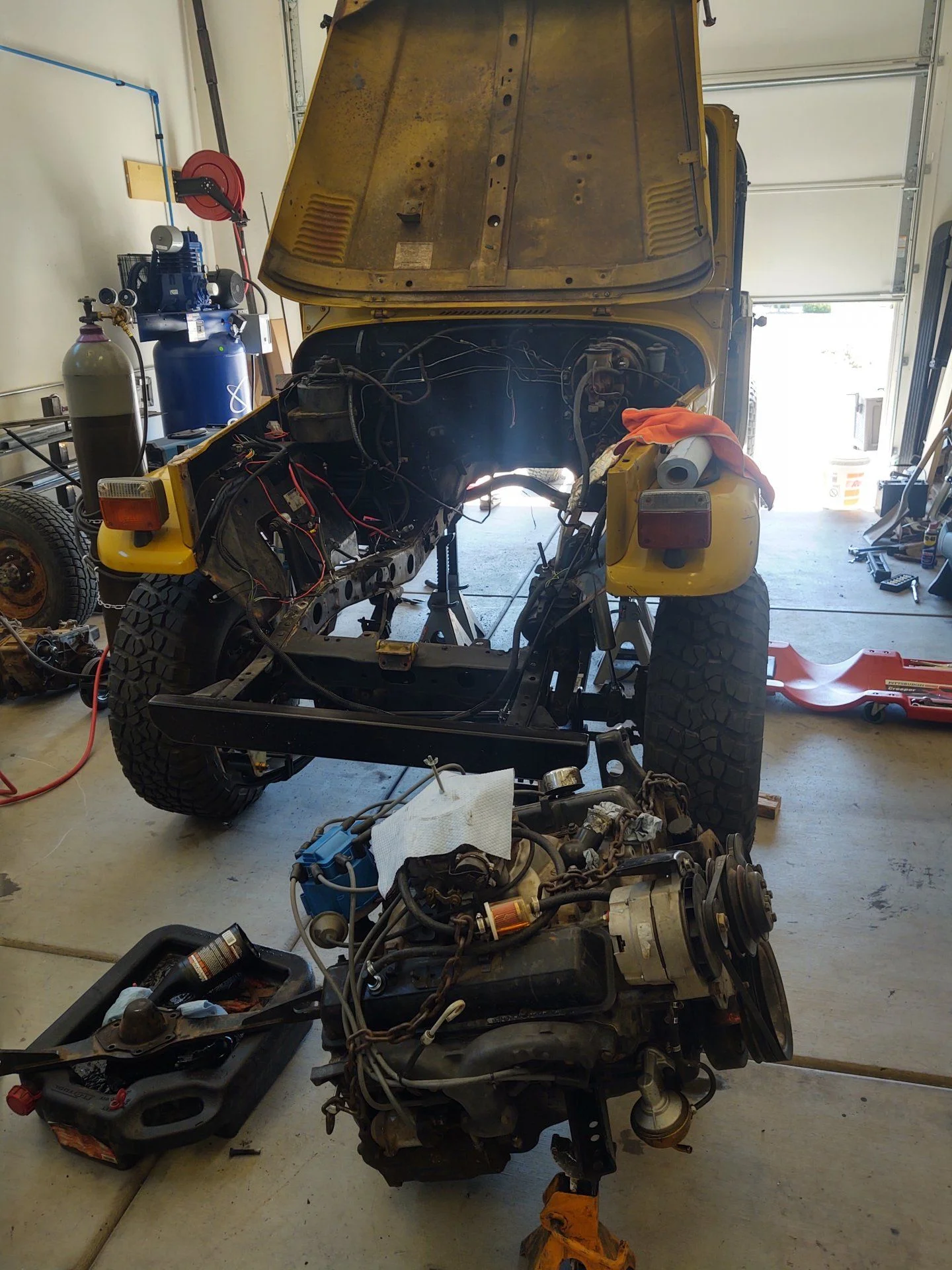

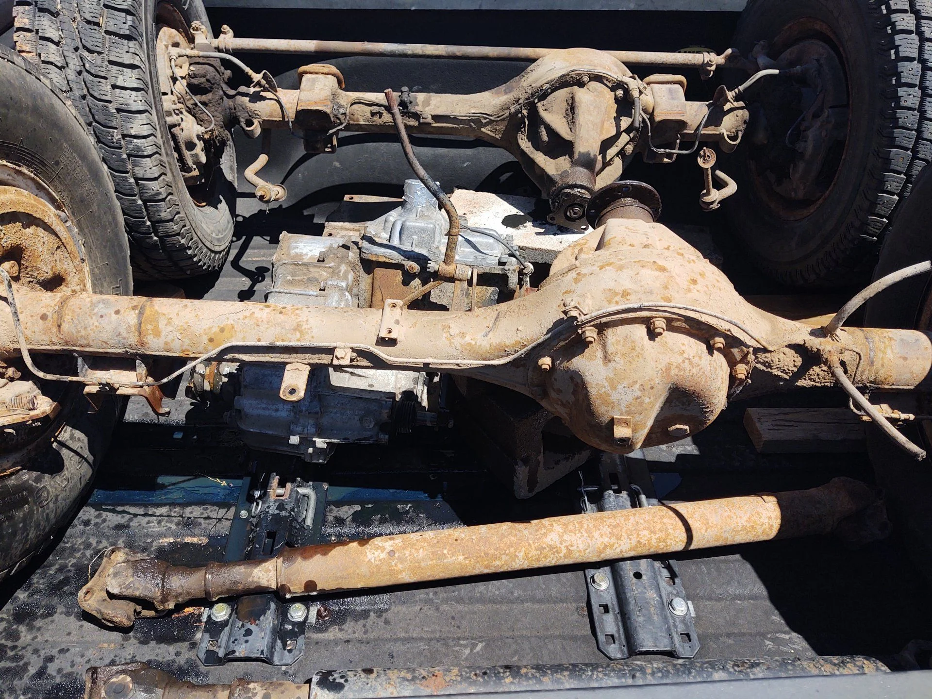

My 76 refresh. Plan: remove 350, install LS, fj60 4 speed and split case, fj60 axles soa, 37" tires on beedlocks.

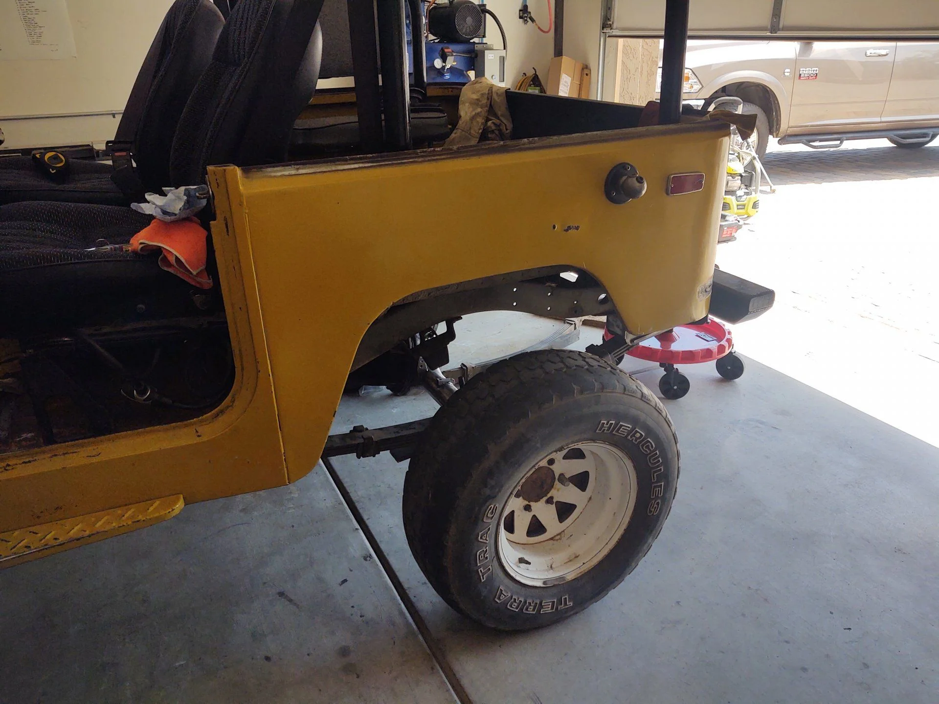

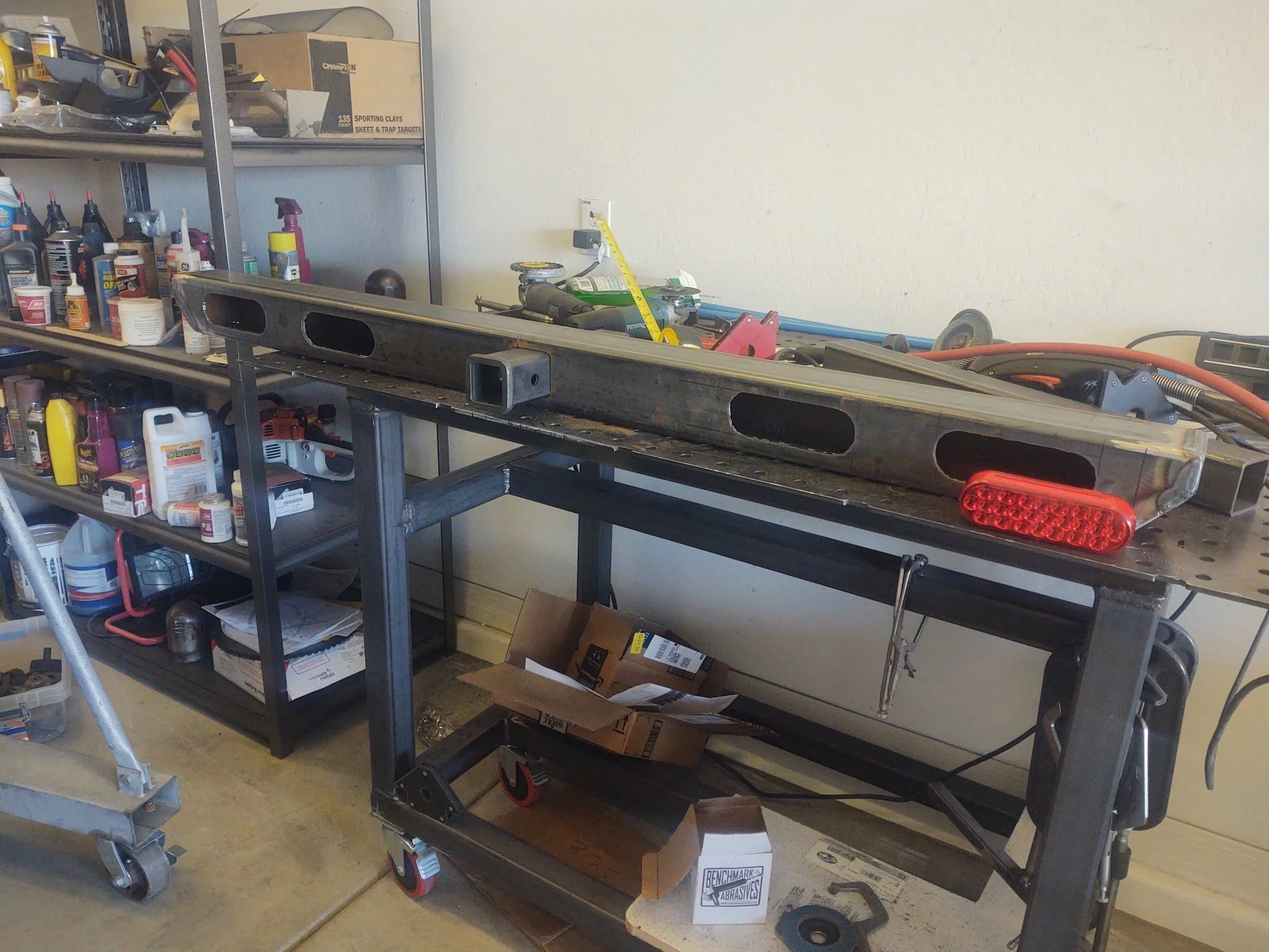

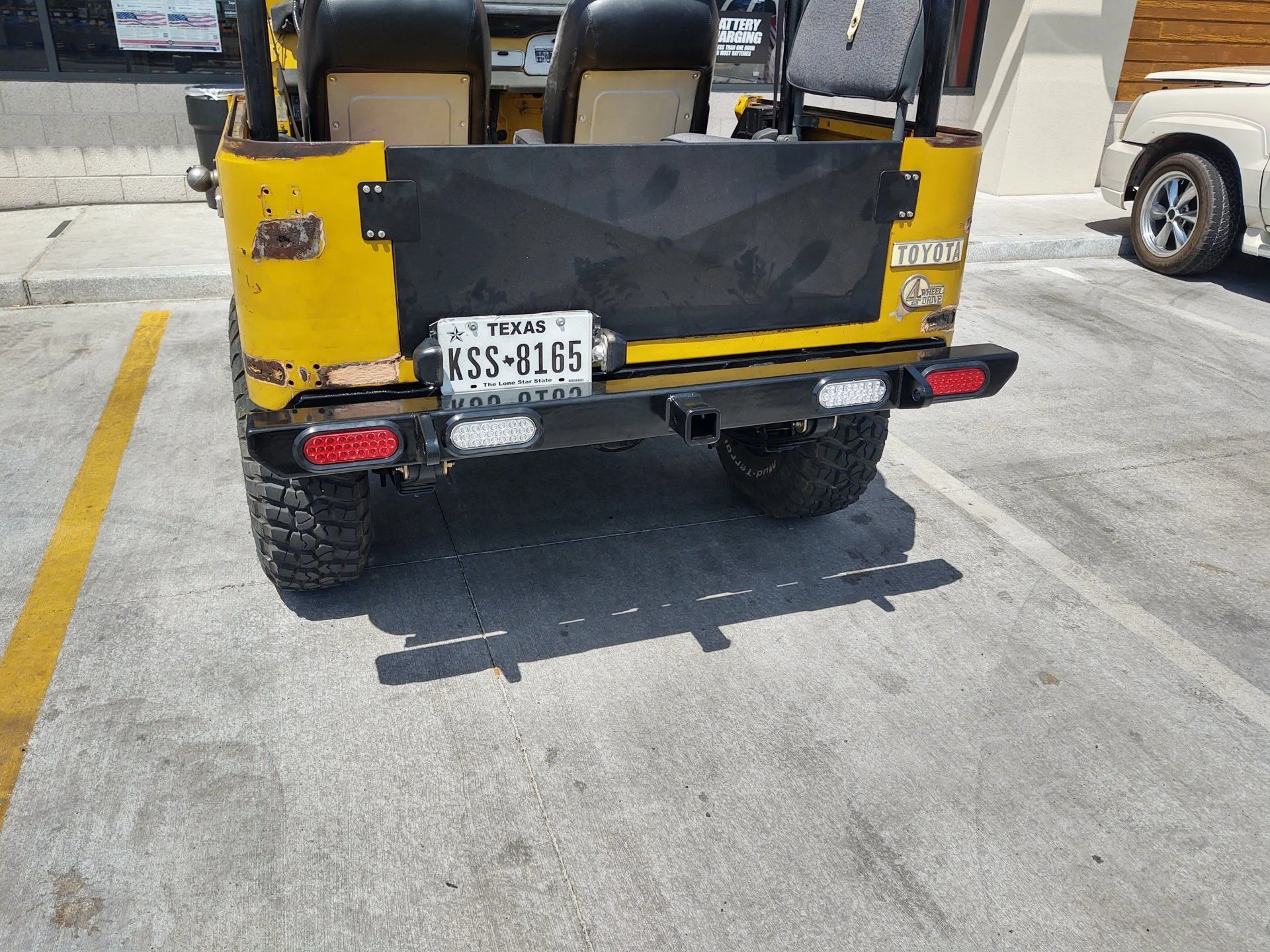

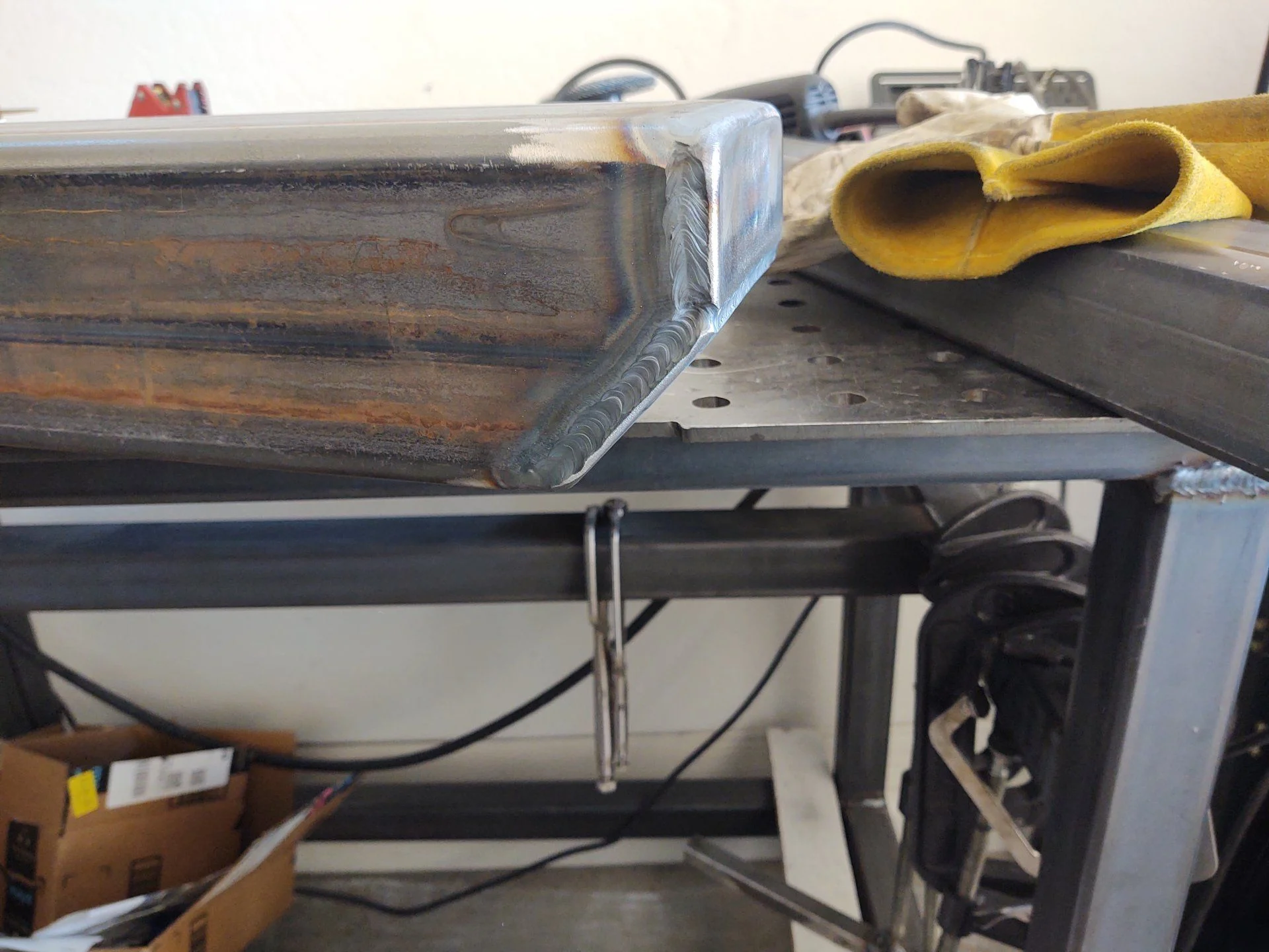

Removed the top and built a new bumper

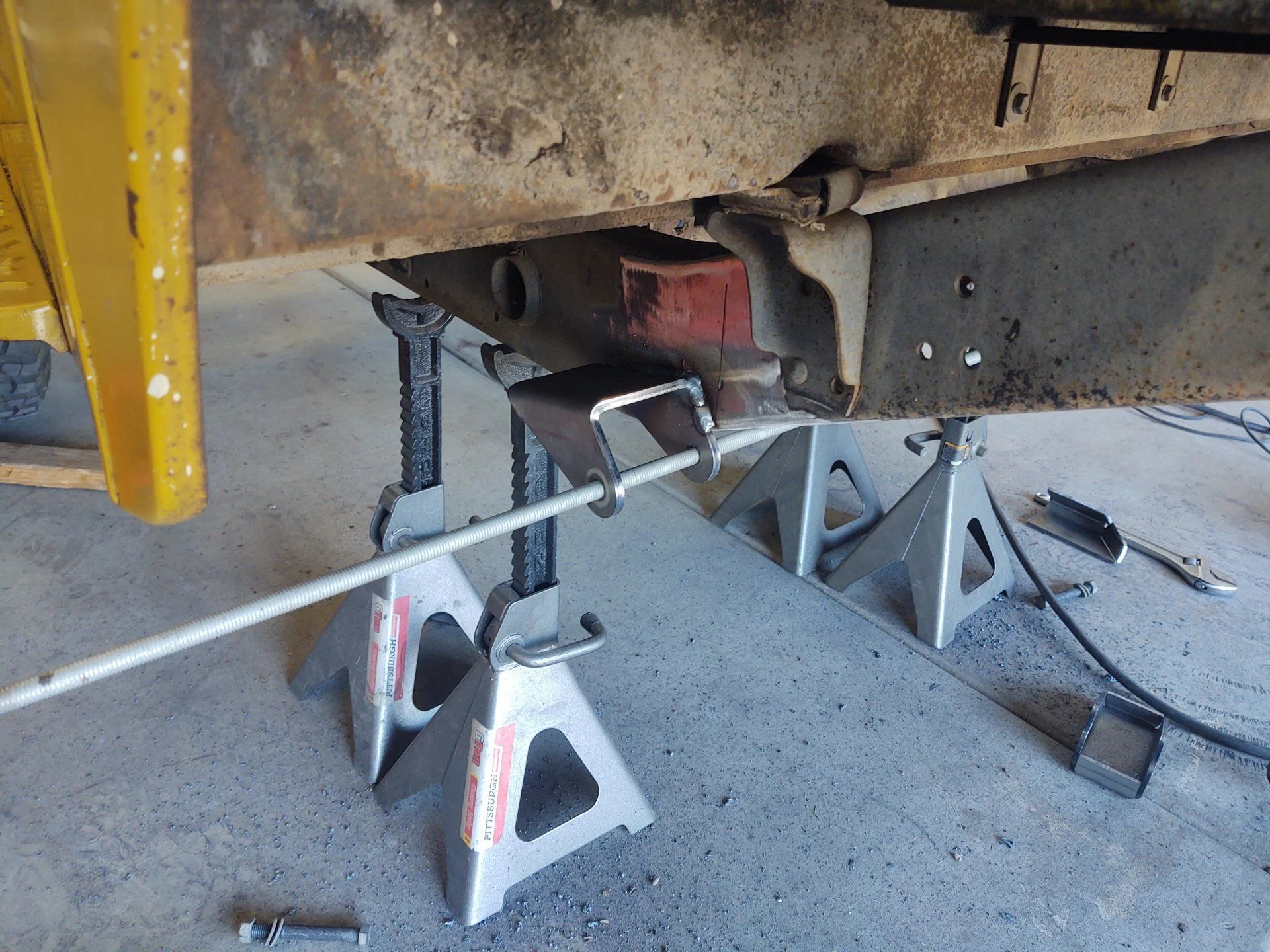

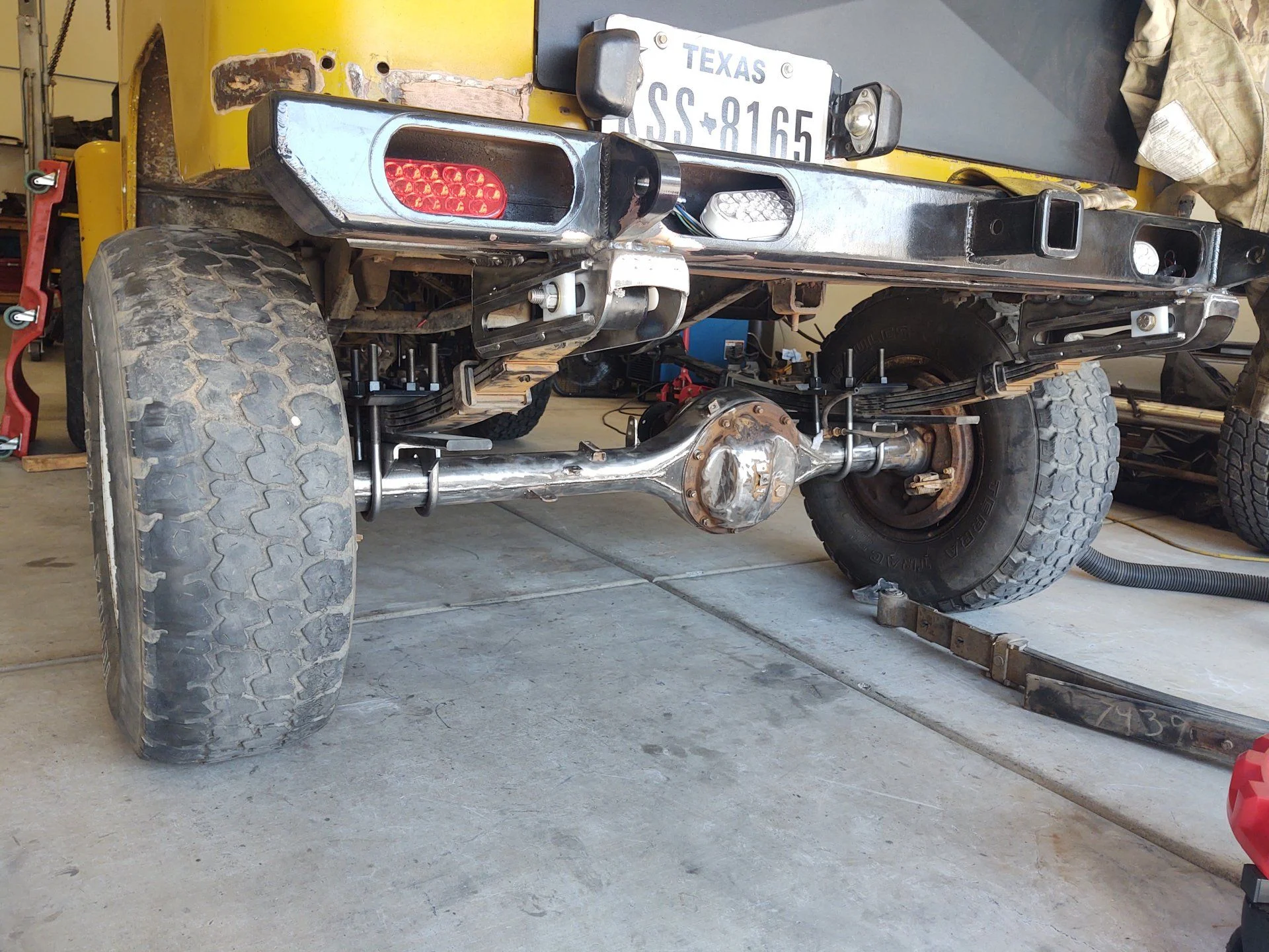

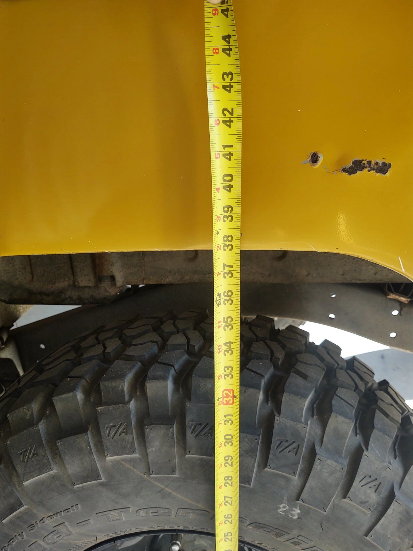

Starting height for springover in rear with 33 inch tires
what ls variant are you going to use?

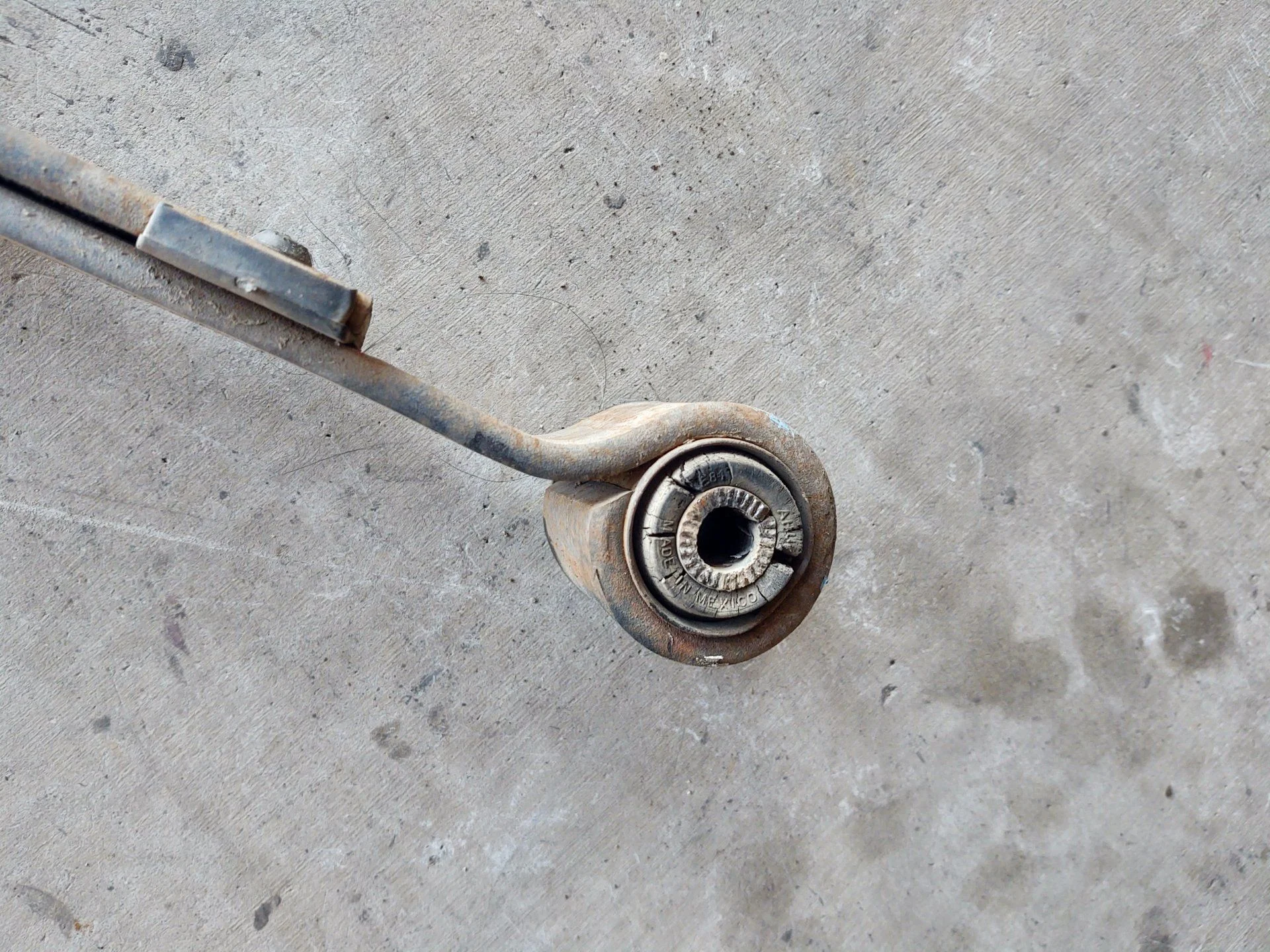

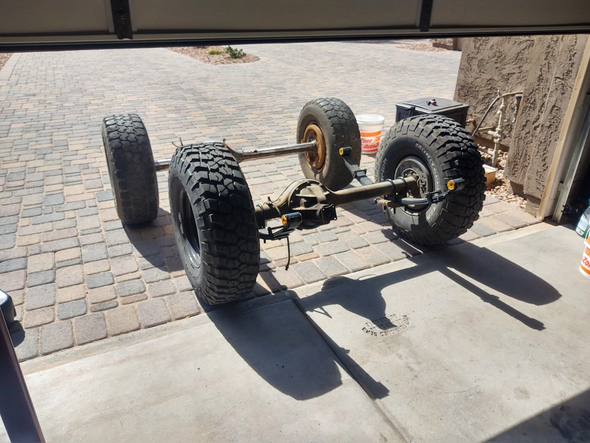

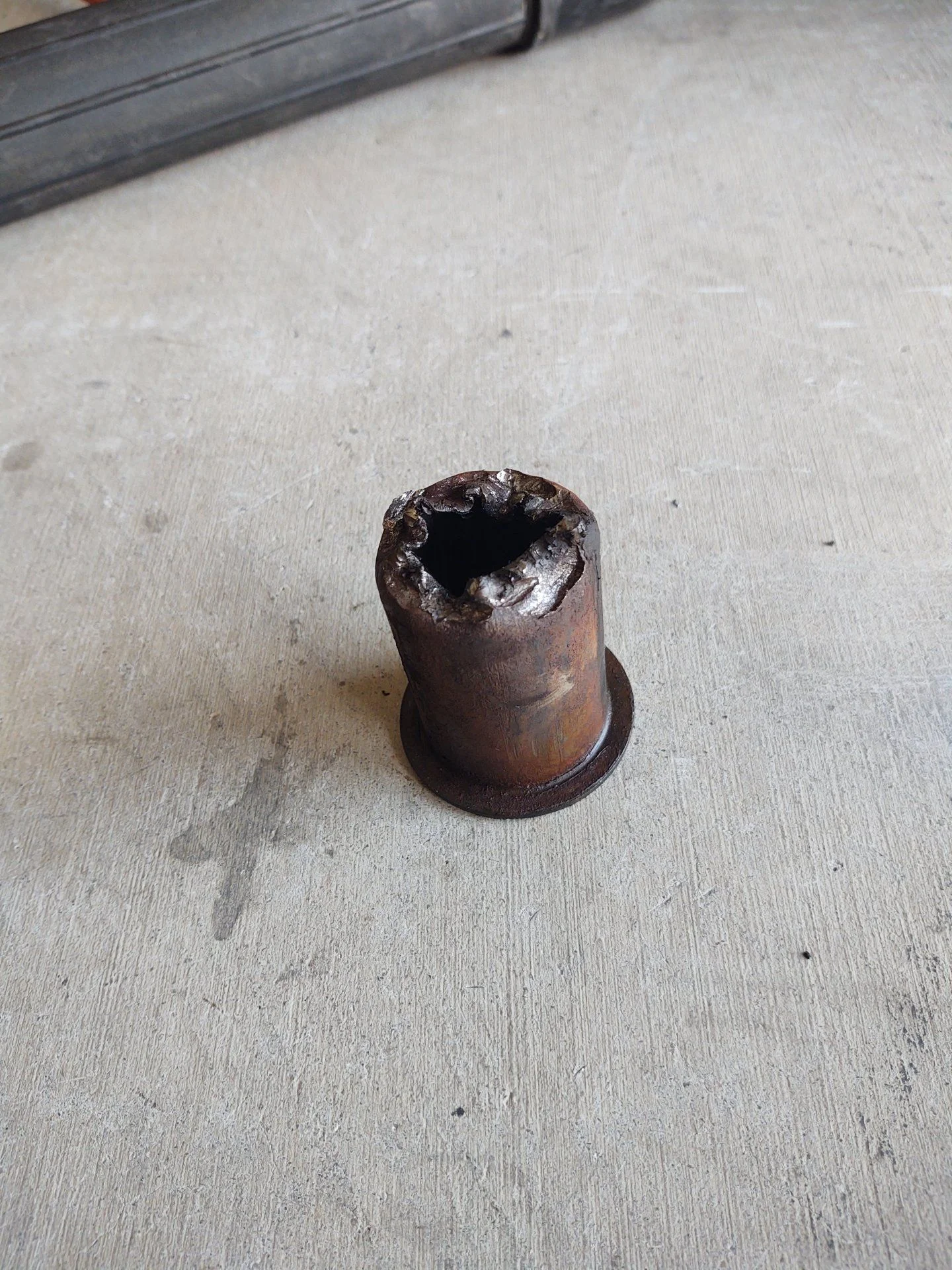

For shackles I'm using liquid iron slide shackles, and Tahoe 54" springs at all four corners. Old bushings sucked getting out/ lots of bfh persuasion needed

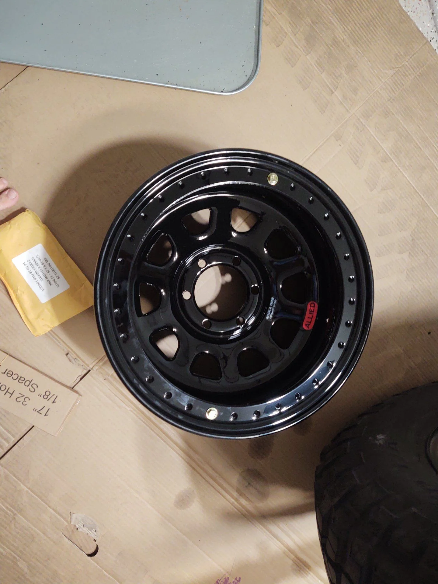

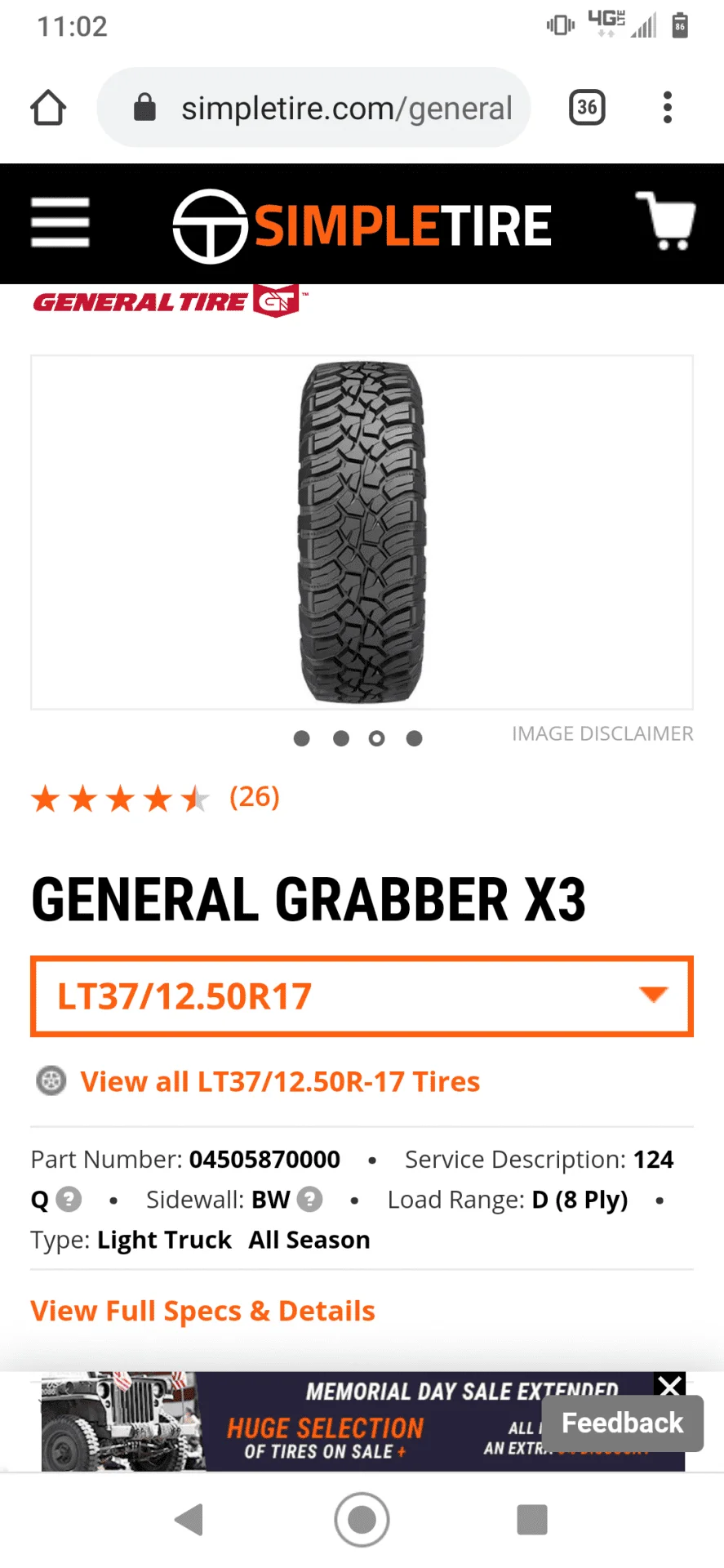

Planning on these tires, any feedback would be appreciated
