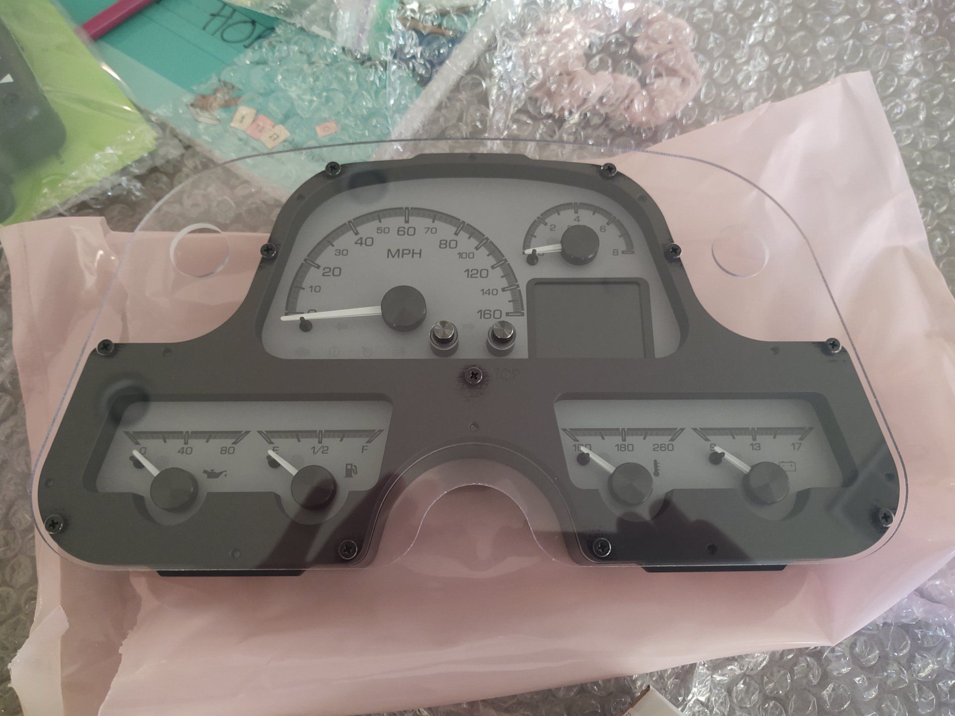

Sorry if I missed it, but what gauge cluster did you use? I thought it was Dokata Digital, but looks a little different than other pics I've seen...Awesome build by the way, Im gathering parts (i have a 5.3 Vortec and 4L60E and hope to be going in this direction soon!
looks like a Dakoda RTX cluster.
I used the hdx, and I used the GPS module for speedometer. Thanks for the compliment. U will be very happy with the 5.3, perfect engine for a 40
thank you, my next question was going to be how did you run the speedometer! 😂...yeah I can't wait to get my build going, hopefully real soon, I'm sure I will have more questions for you as I get going on it...thanks again,and keep up the good work!
