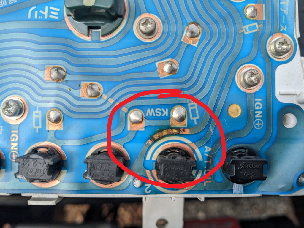

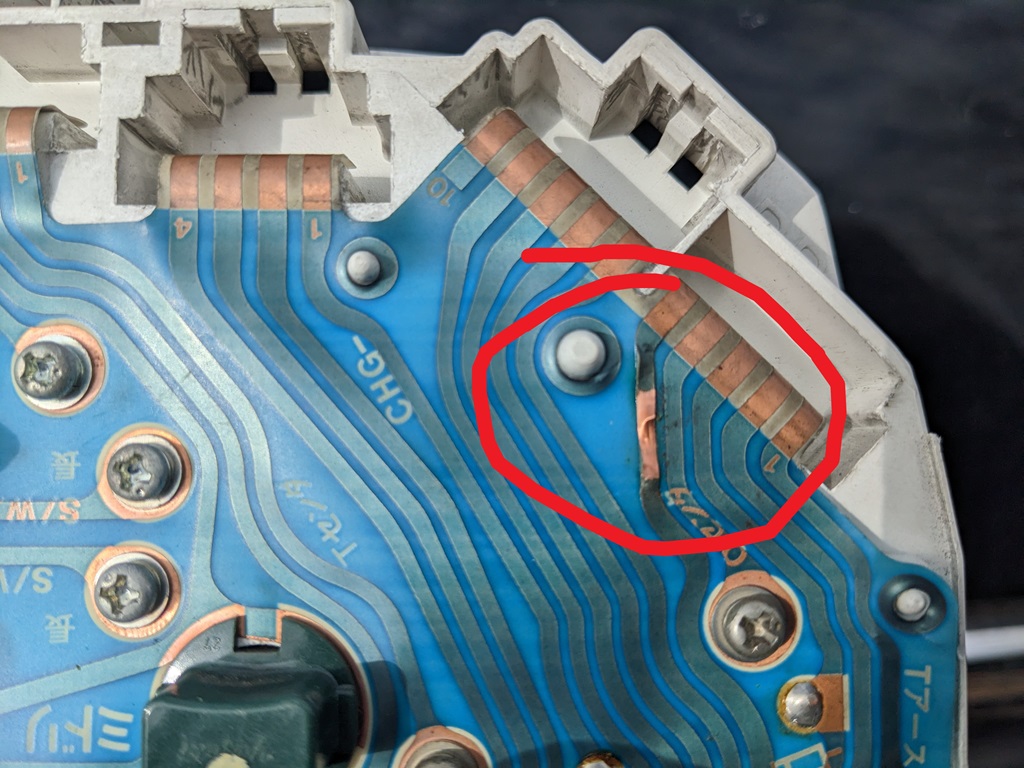

Sorry for the lateness with these photos. Life & weather, you know...
I noticed a 2nd melt spot.
The circuit is severed in the area near the AT temp light, circled.
The spot circled near the connector/plug seems to be intact. Once I fix the severed section it will be easier to get a tester on it to be sure.
It doesn't look hard to repair, but is there a proper way?
Or simply solder in a jumper wire?
Thanks, folks!
Yes, solder in a jumper
UPDATE: Confirming the trouble spot was the one near the AT temp light. A short jumper was crafted from a small piece of wire. I removed all insulation (it was too short anyway) and tinned it. I was able to lift the trace slightly away from the flexible PCB and tin it. Then, using a low wattage soldering iron and a flat tip, I carefully soldered it in. It didn't come out too ugly, but it's obviously a repair.
I was pretty anxious to test it in the live environment. It's in the truck working 100% now. I didn't take any pictures, I was too wrapped up in getting it back together. So everything works so far!
Thanks for the tips everyone, I was afraid of completely ruining this thing so I had a skittish approach.
I didn't think it was tough enough to take a repair, but it did.
The biggest help was the videos @Kernal pointed out, so double thanks for those ideas! Cheers!
