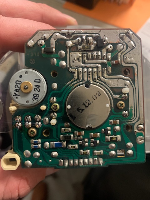

Hey everyone. Had a good find to share with the community. So like many other 80 owners, I have been battling INOP/ intermittent speedometer issues for several years. The issue is the acid leaking from capacitors on the back of the circuit board of the speedometer, if you aren’t familiar. Every single one of these 80’s likely has this issue to some degree at this point. See below for what mine looked like at 172,000 miles:

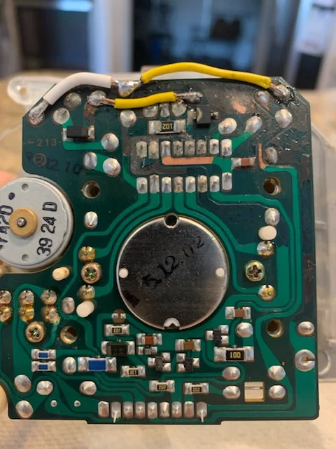

See below for the same speedo circuit board after repair.
