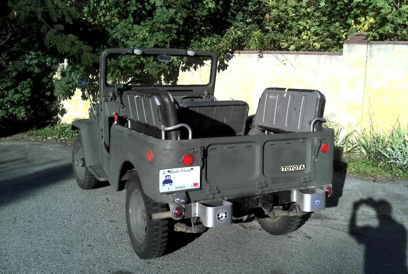

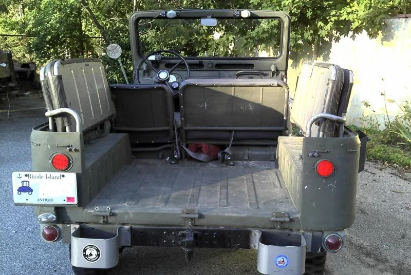

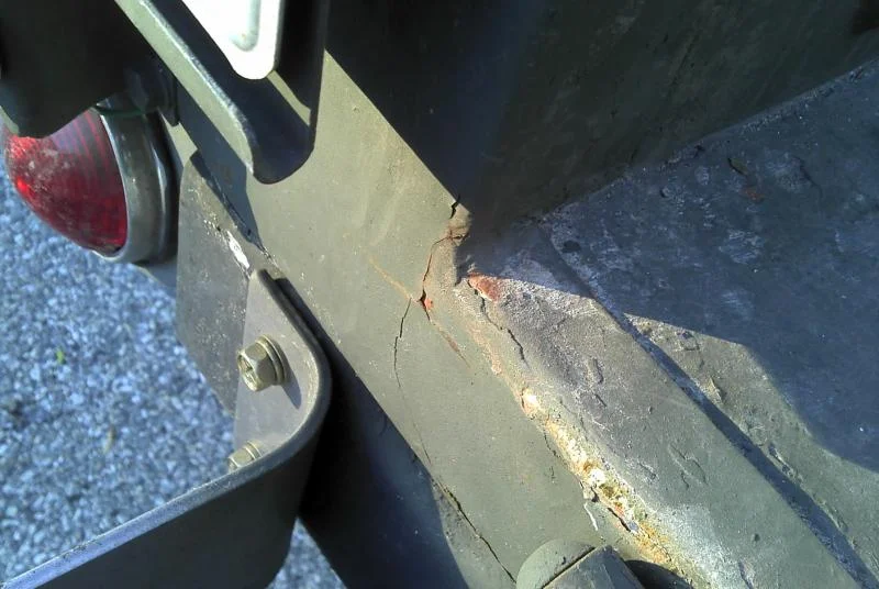

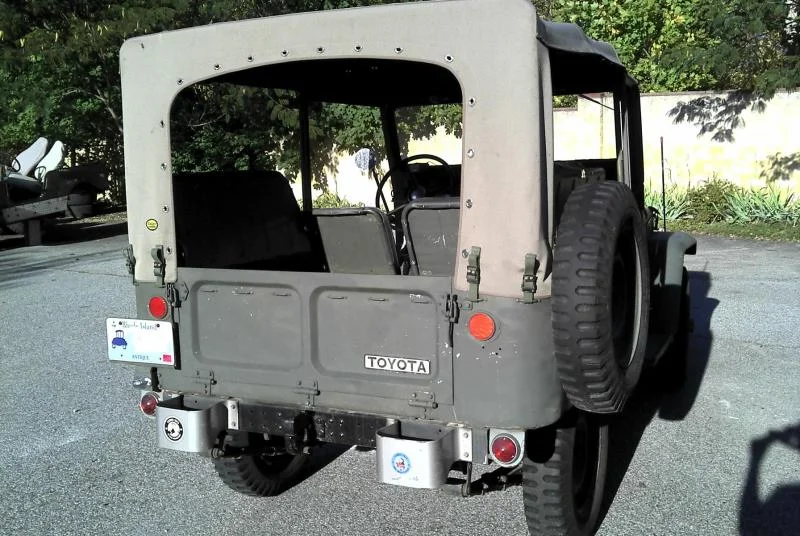

I'm going to finally give some necessary love to my olive drab 1959 FJ25 named ODIE. This is #67 in the "count the FJ25's thread" There are lots of separate threads that I've done in the past on mechanical fixes that I'll try to add links for. I'm still not into full restoration mode but the east coast is starting to get to the sheet metal. So, plans are to do rear quarters and rear sill replacement and fix a small hole in the mid bed from my hi-lift bouncing around at Fall Gathering 2010. I may try to straighten out the fenders and steps and fill in any PO installed holes with the mig welder too.

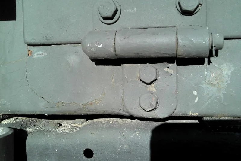

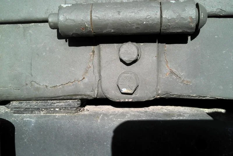

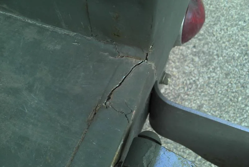

I put the tailgate down this morning and saw the whole rear sill flex at the hinges. The PPO had bondo'd it up without reinforcing it so I knew it was just a matter of time. Both sides of the sill are cracked vertically at each corner of the bed.
Some before pictures:

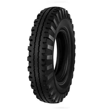

I kind of like the STA super traxion:
https://www.universaltire.com/truck-and-military/truck/750-16-sta-super-traxion.html
The Deestone 7.50-16 is cool but I can't find a source to buy them. I still need to check locally at town fair where the guy claims he bought them.
I'd really go for the Deestone D903 again if I can actually find somewhere to buy them and are within my budget.
