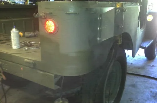

I finally got some time in on ODIE and got the rear channel done and tailgate back on.
Started by cleaning up the floor sheetmetal. Then rosette welding up the extra holes in the rear channel support and drilling holes/mounting the center hinge.
The Oldsmobile front wheel cylinders that the PO used angled the rubber brake hose down into the knuckle. The angle was so bad that they finally wore through from rubbing on the knuckle, losing my brakes at FG2012. I crimped the line off with vice grips and drove home on 3 wheel brakes. I had duplicate hoses made at a local store hoping I could bend the fittings up enough to stop the rubbing, but that didnt work. So, I sent a set of original wheel cylinders to apple hydraulics for a sleeve job. I bought new toyota rubber hoses, and I stole the original copper brake lines off of #6 and put it all on ODIE. While I was waiting for parts, somehow, crud got stirred up and trapped in the fuel line too. I blew out the line today with air and finally got her running again. I also got all of the original parts installed and now have a running, stopping fj25 again. :)
