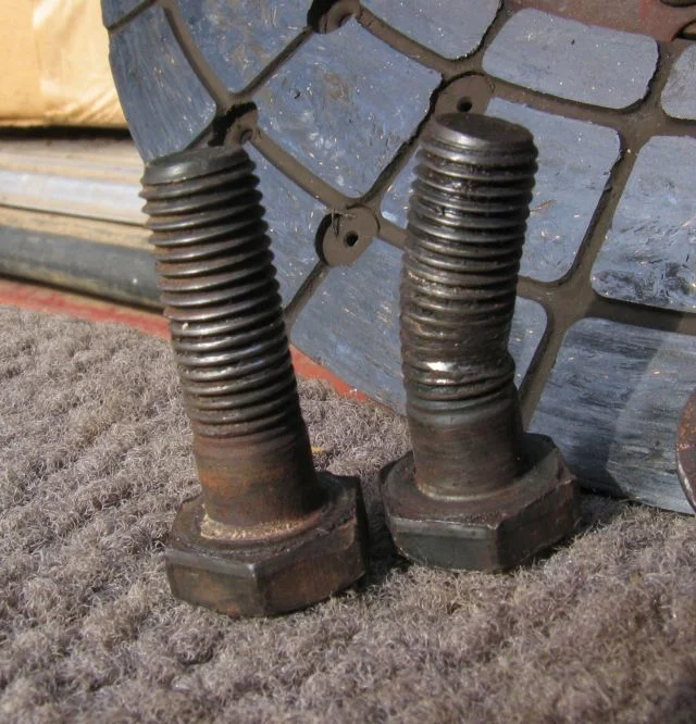

Once had a flywheel bolt back out so I now make sure that I use a bit of blue loctite on installation. I think with the instance in which I had bolts back out I had forgotten to loctite 'em.
