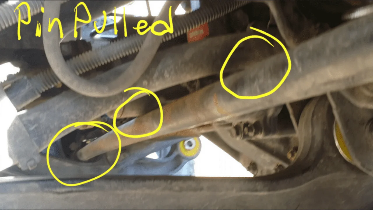

You mean it hits on the control arms locating the diff when articulated and turned on the lock?.
YES.
What I'm trying to do is nothing new to any bloke who has put on a front shock longer than the "L" shock of 26.3" ext. I tried the pulled pin mod & found out around 27" drop measured at the shock & full lock things start hitting. The picture below (as sitting in rig) the front left is dropped out & turning hard left, the right tyre is stuffed. Same results, visa versa. I have resently have been told to go back to OEM bushings & do a washed mod to get the arm away from the the tie rod even grinding away some metal in the conflicting area.

The steering arms are forged, and we fix that by strapping the housing to the four poster in the car, and putting a bottle jack under the arm, and jacking it up slightly to improve the clearance.
You will be surprised how easy they bend a little.
? Define strapping. Define four poster.
Do you mean bend it up to make it ark up more?
YES.
We use a heavy ratchet srtep to hold the housing down so vehicle doesnt lift up.
4 poster is a 4 post flat hoist the vehicle sits on at ride height.
And yes, we bend it up to give more clearance.

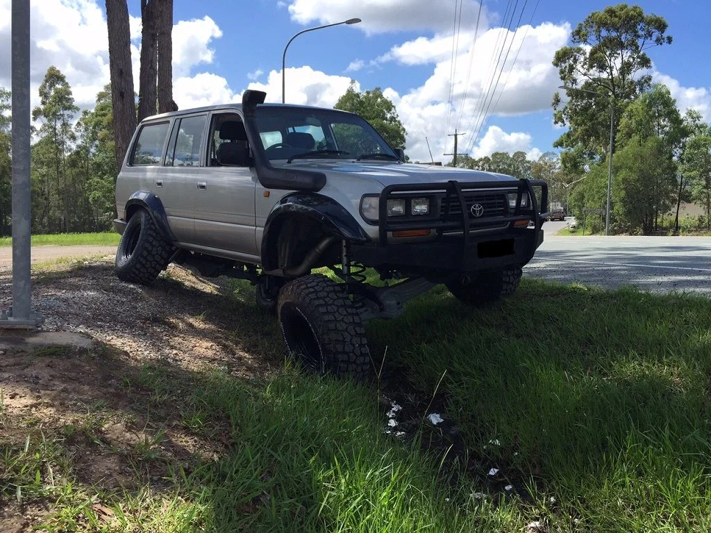

Front
5" Flexi coils
Fox 2.5 remote reservoir shocks 14" travel
Flipped radius arms
Caster correction plates
Diff housing strengthened
Nitro gears, solid pinion spacer, etc
TJM front air locker
Modified pan hard bracket
Hellfire fabworks hi steer
Custom extended brake lines
Custom rotors
Rebuilt calipers with upgraded pistons, seals etc
Rear
Fully built diff housing
TJM air locker
Modified upper control arm brackets
Modified lower control arm brackets on chassis
Custom upper and lower control arms
5" Flexi coils
Fox 2.5 remorse reservoir shocks
Custom rotors
I've probably missed a few things but that's most of the upgrades. Front has more in it, unfortunately the ditch we found wasn't big enough :)
Drives great with no steering shake at speed. Still a work in progress. Have to fit AOE front bumper, Slee rear bar, sliders and measure for limit straps.
Will be doing some trimming soon to make way for 37's.
Yes, I had BigBoy do the work. Extremely happy with the final outcome.
