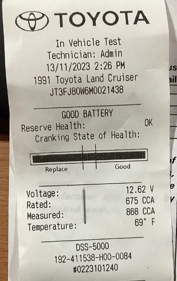

  2. Nope, battery checks out brilliantly. Is does not discharge much if at all during long drivers. Not a spot of corrosion or other problems at terminals. I have always had extra grounding wires from - terminal to body+frame. Microprocessor controlled charging and test of the battery out of the vehicle yields a perfectly-working 84-month Toyota group 27. Even Toyota Stealership says battery checks out fine.

screenshot-2023-11-13-6-21-44-pm-png.3480806

Dude, I mean maybe. I love these 84-monthers and Toyota refuses to warranty as it tests out fine. My own little computer-controlled charger says it tests 100%. Wroth the try I thin.
