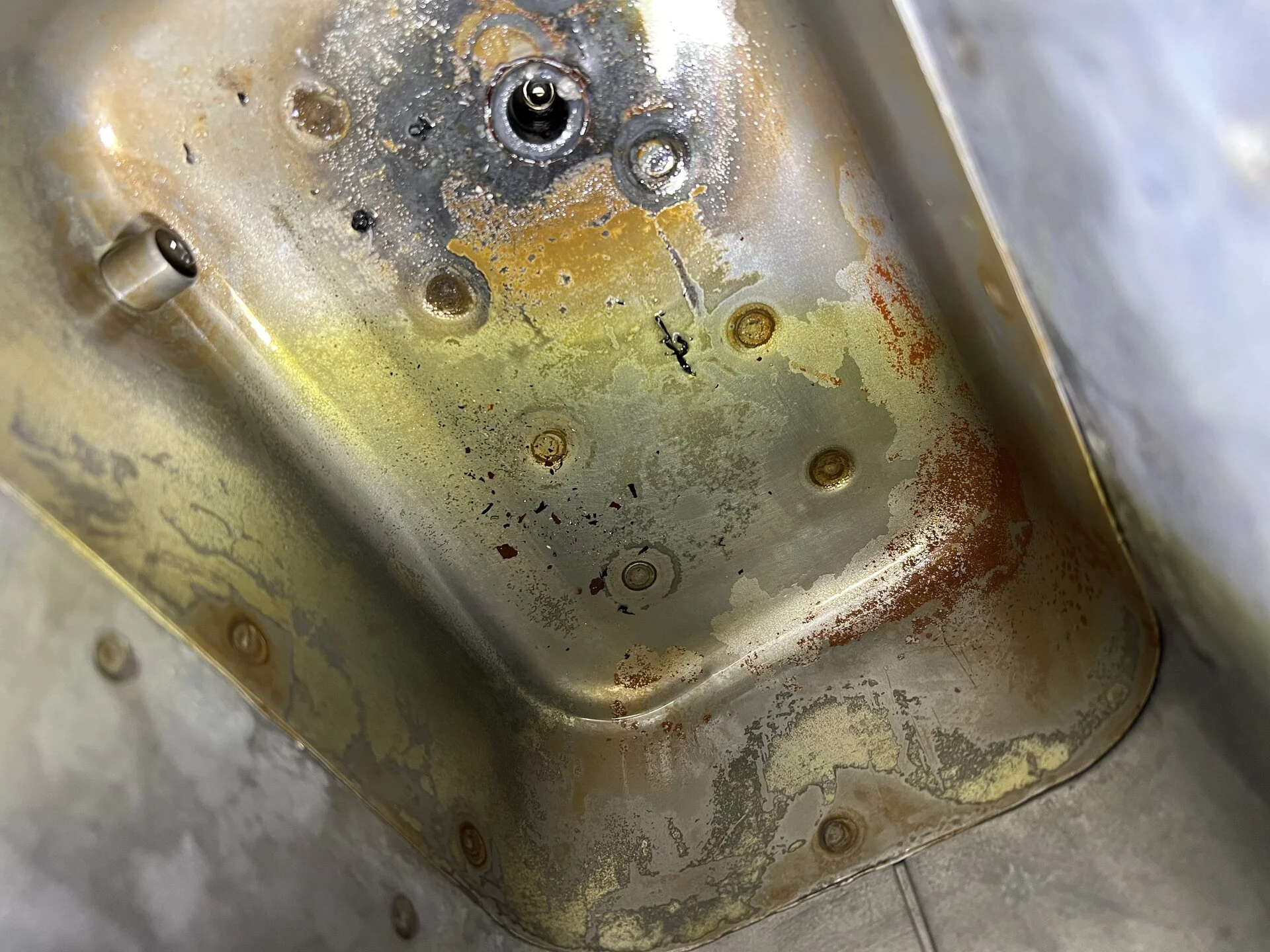

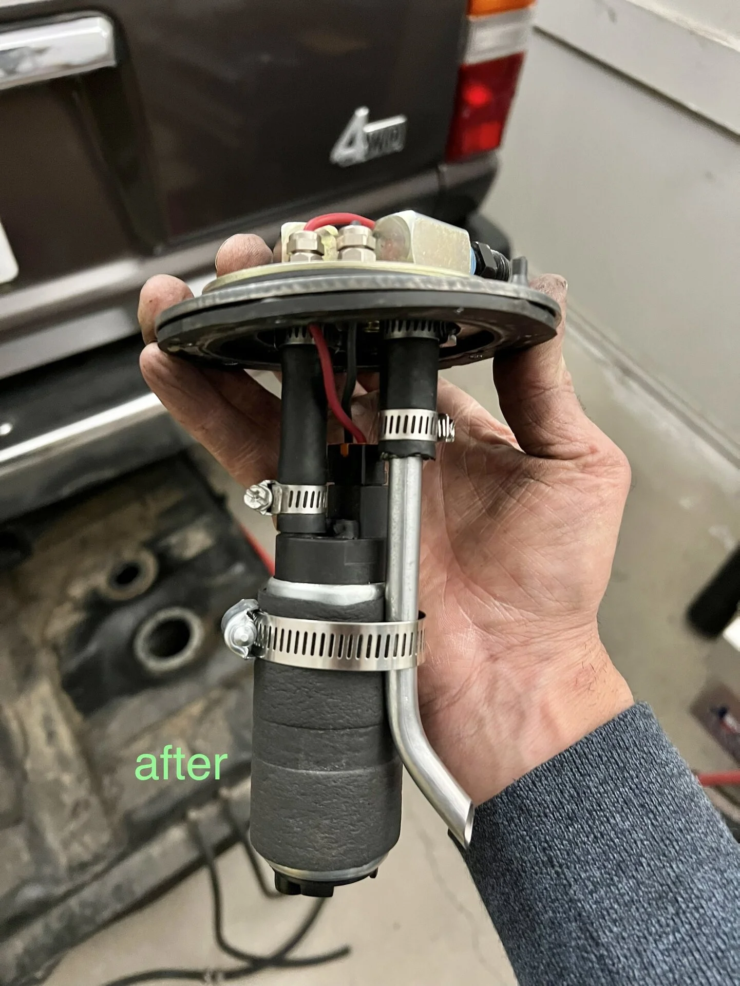

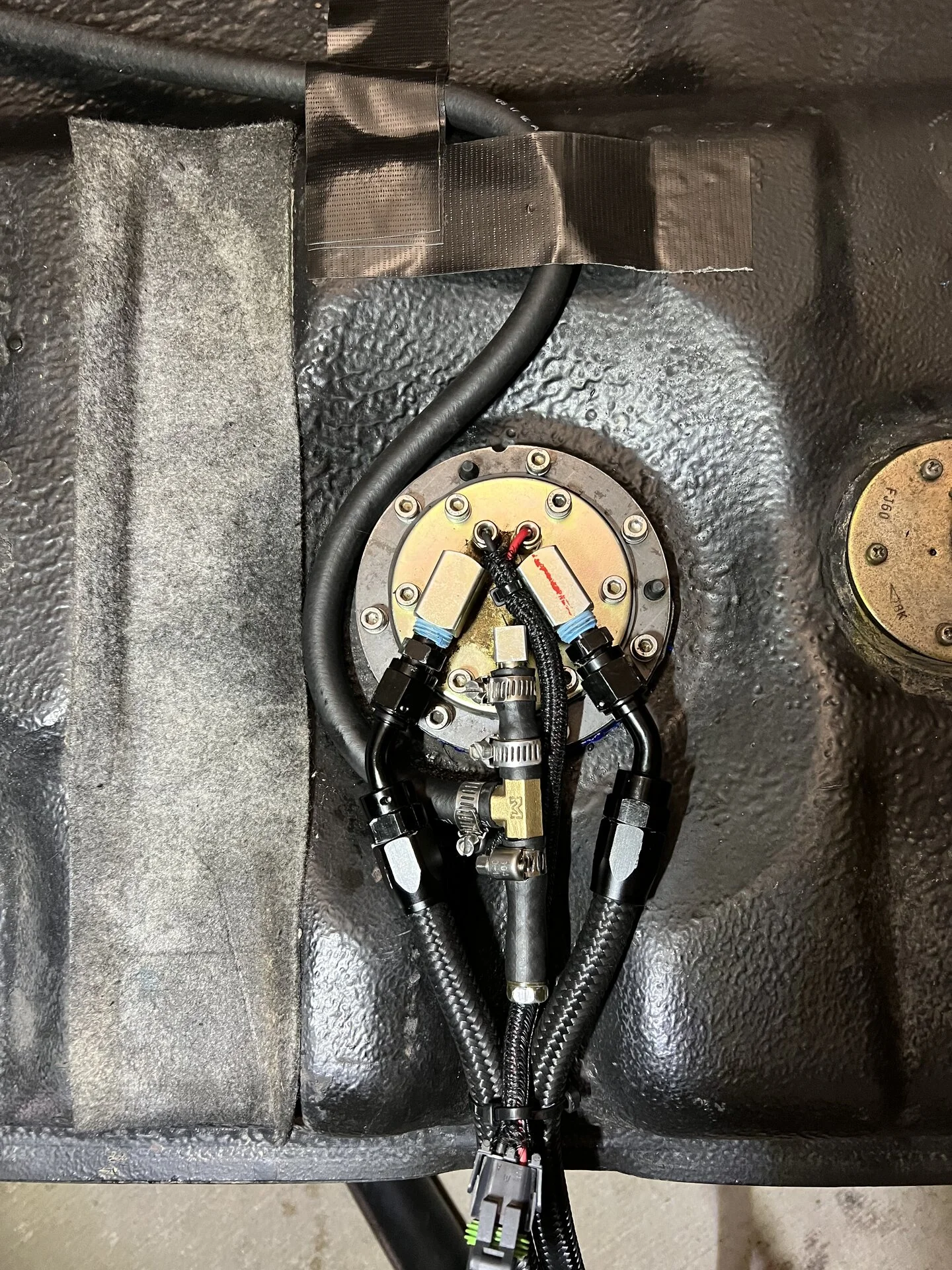

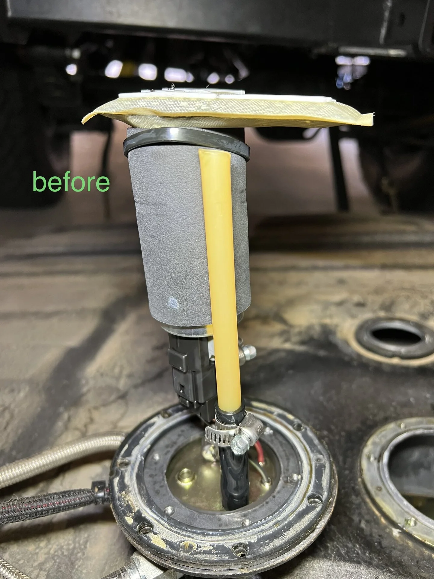

Was getting noise from the tank after retrofitting with Tanks Inc pump module last year. Ties strapping the pump to the return came off. Not impressed, so had an old return down coming metal tube and put it all back the way it was. Here is before and after. The adapter plate is from @tmxmotorsports and Deatschwerks pump replacing the Walbro and ditch the braided metal fuel lines for nylon from the lid to return regulator. If anyone sees an issue with the way I’ve got this ready to go back in let me know. I’ll spin the return back around to dump on sock.

If I did it all over again today I’d have bought all Aeromotive stuff. Tanks is ok but by the time I finished gutting it again all I used was the pump house lid and @tmxmotorsports adapter. He sent me the adapter in a few days everything bolted up fine. Strap a good pump to the tube return and get a 10micron filter on the rails. I had so many issues with tank venting I ran the extra vent off the pump over and t’d into the separator. Be sure not the jam you pre filter into the bottom of the tank. Last guy did this and collapsed the plastic structure and was cavitating. I don’t have a full write up. Don’t buy Walbros pump, Denso is overrated and the Deatschwerks has worked perfect, Aeromotive because you call their tech support line and they answer their phones, Brett. Also Deatschwerks answers phone and email same day. The pump is silent. Full write up but you can message me I’ll send you all my photos. Final note is all this is not near as complicated as I thought.

It didn’t fail but got loud. Perhaps a lot of mixed reviews on the Walbro pump. Pretty much same setup with some minor changes to the pickup and vent lines. The Deatschwerks was one suggested about the time Denso had that recall so left that alone.
Edit: I have to say that the off-road shop that did the work 18 months ago did a poor job so some of the issues could have been craftsmanship

Agree, I don’t think they are bad but when they start making a whine concerns me to take a trip. I kept that pump as backup.

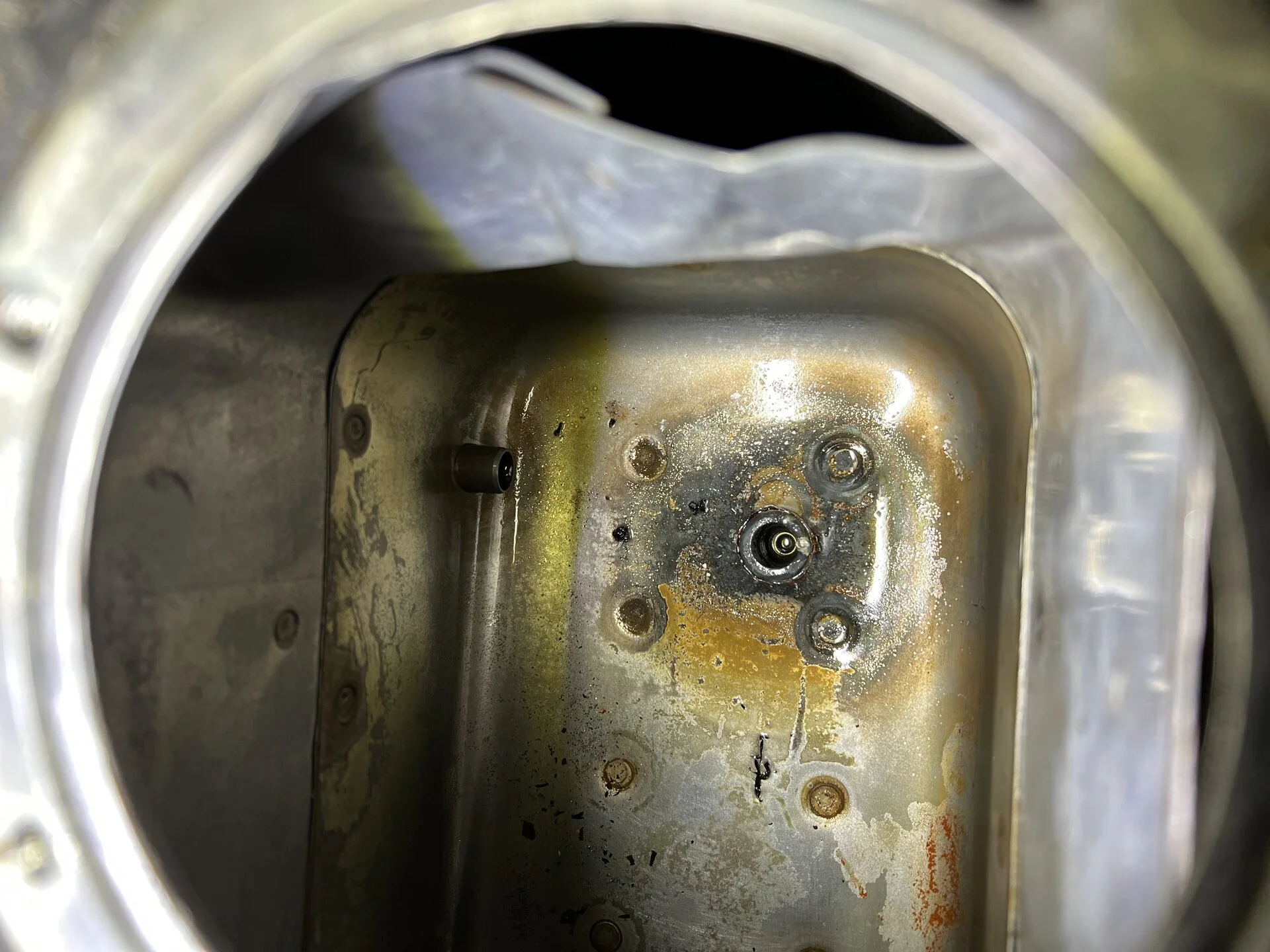

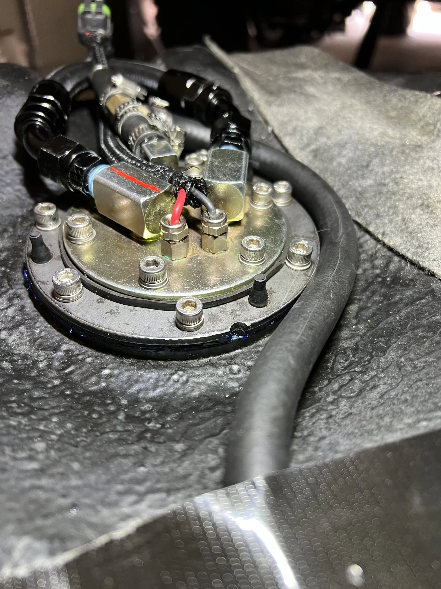

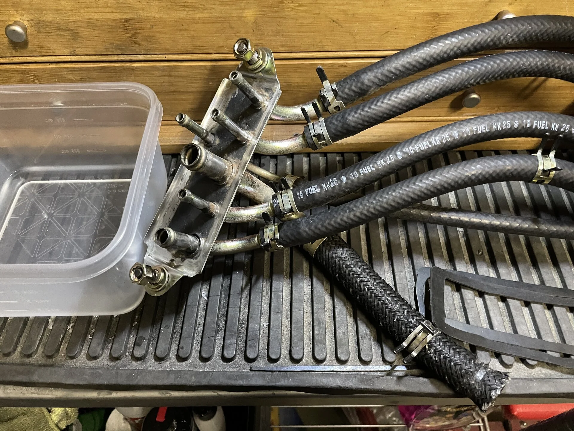

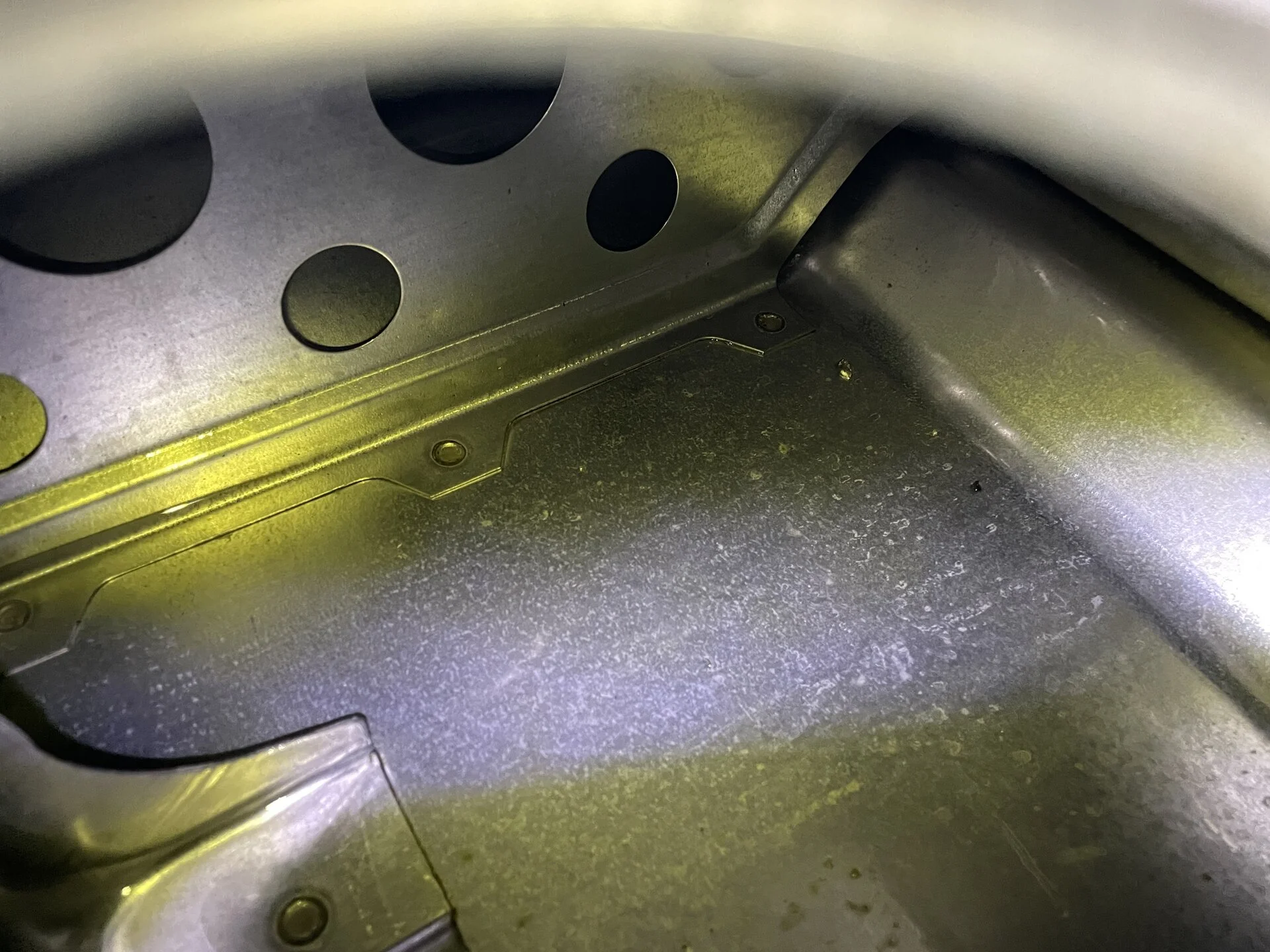

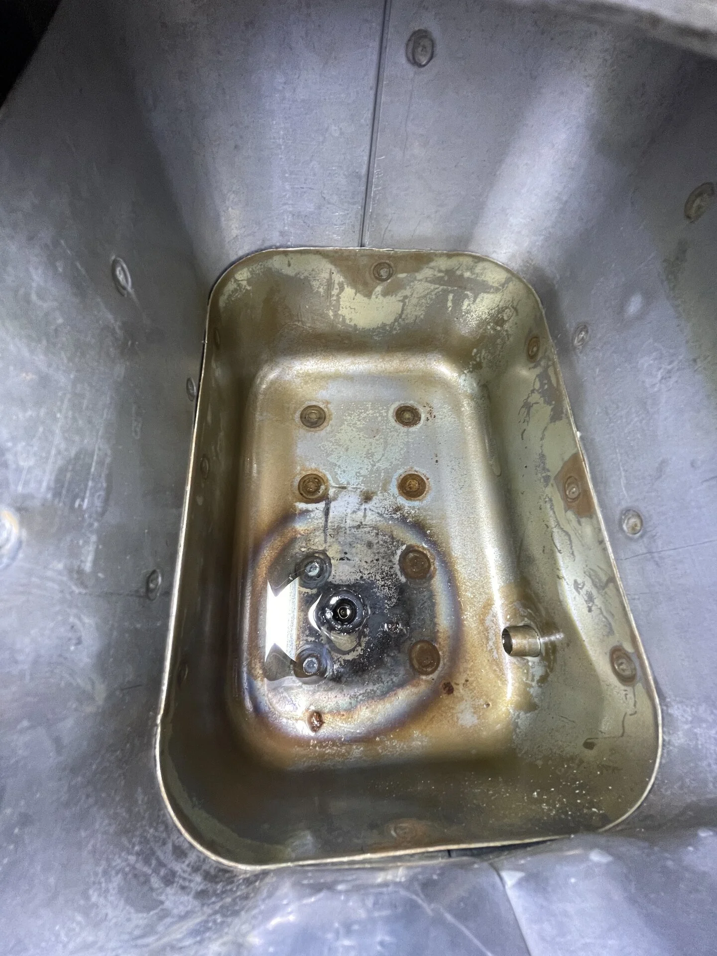

Here’s the tub and inside pics from the last drop. The pre filter was from the first tank drop in 2021. Sorry for the duplicates. Recent pump change I also took the stainless braided lines off and put nylon braided Teflon lines on. Some of the pump sound and vibration was being transferred to the frame and could hear and feel it. Nolan pointed that out to me
