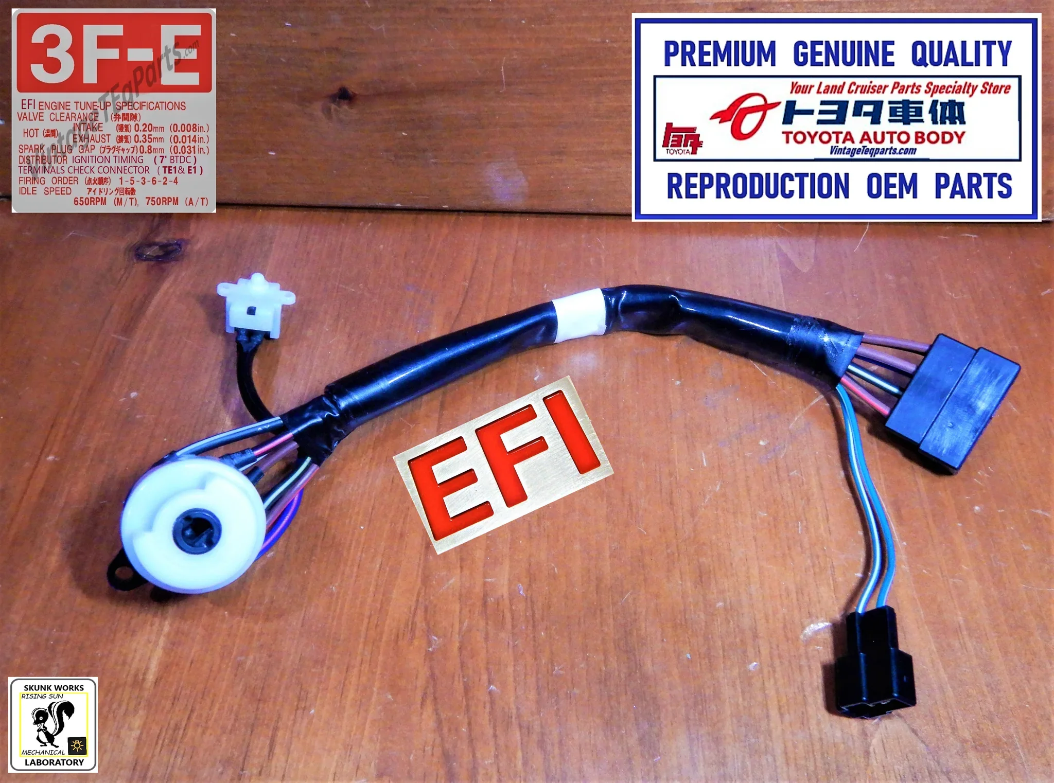

- this is also in-line to be FSM step by step confirmed and verified in Good working order along with your Starter ,
a bad electrical key switch alone can and does cause all your symptoms you outline above
also , LOOSE the aftermarket starter and starter repair parts , you creating a up-hill battle that will become very Klear after you remove and then re-install your starter more then 2 times , which your at that place right now ...
