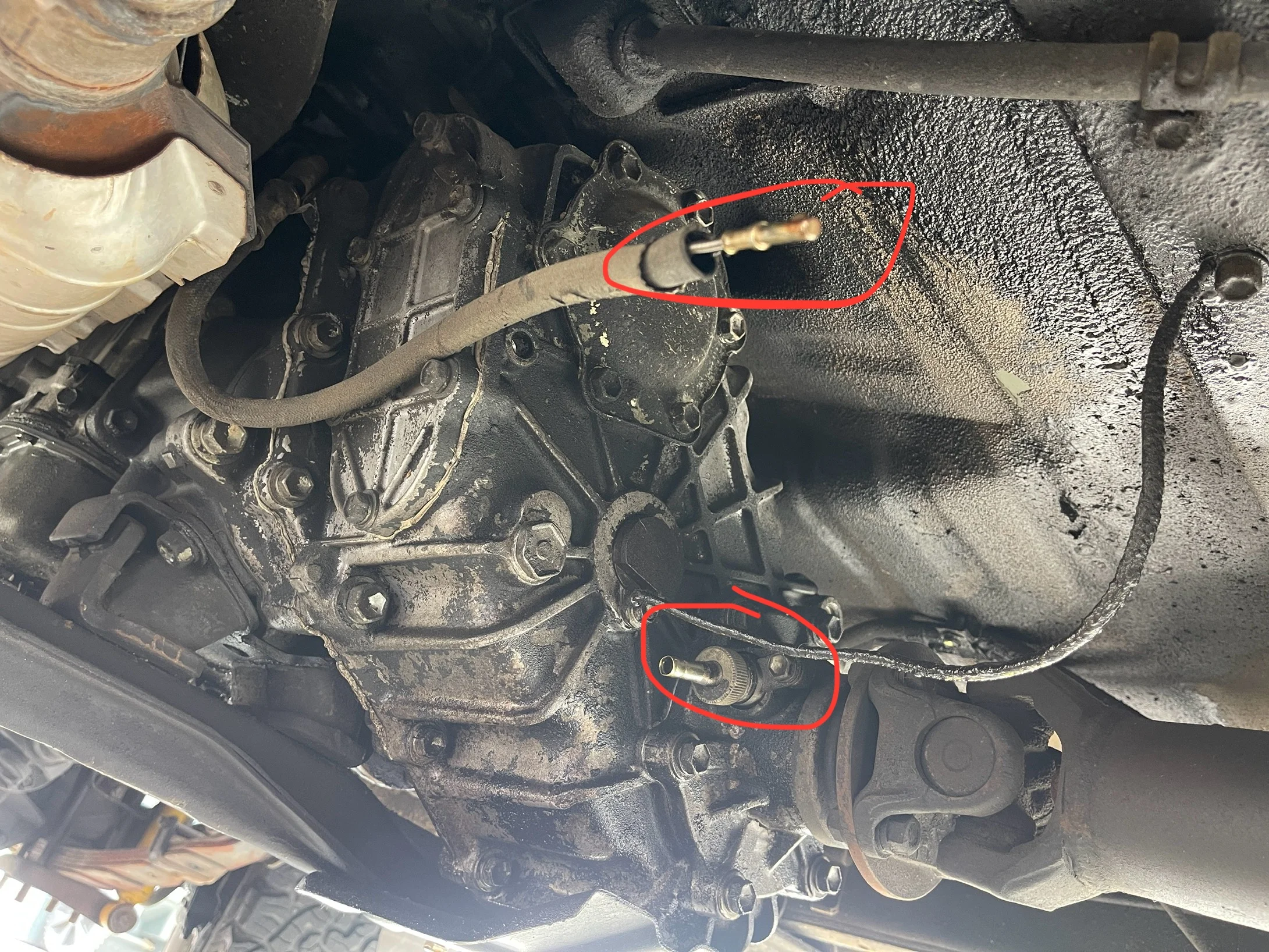

My speedometer cable came apart where it screws into the transfer case. The inner cable itself didn’t snap, but seems where the outer hose gets secured to the screw on part failed. Anyone know how this usually stays in place?
Think just a clamp around the rubber hose to secure it to the metal screw on thing would work?

Hose clamp might work to repair, that's normally a crimped end.
Remove the part that's screwed on to the T'case tailhousing and see if the plastic gears inside are ok.
i wonder if you could just squeeze it in a vice to square the crimp again. i bought one for @cruiseroutfit a few years ago. maybe check with them for a new one if “renewing” the crimp doesn’t work.
looks like the cable is in tack. just gotta get the housing to stay. after crimping maybe put a heat shrink on it to help hold it.
