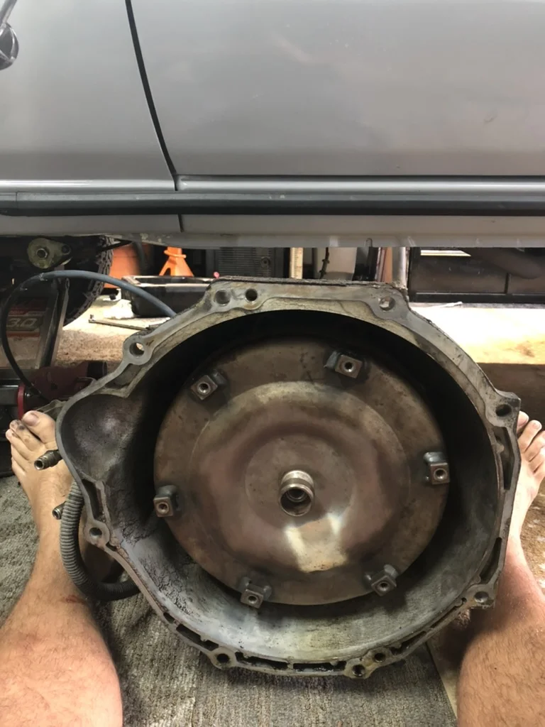

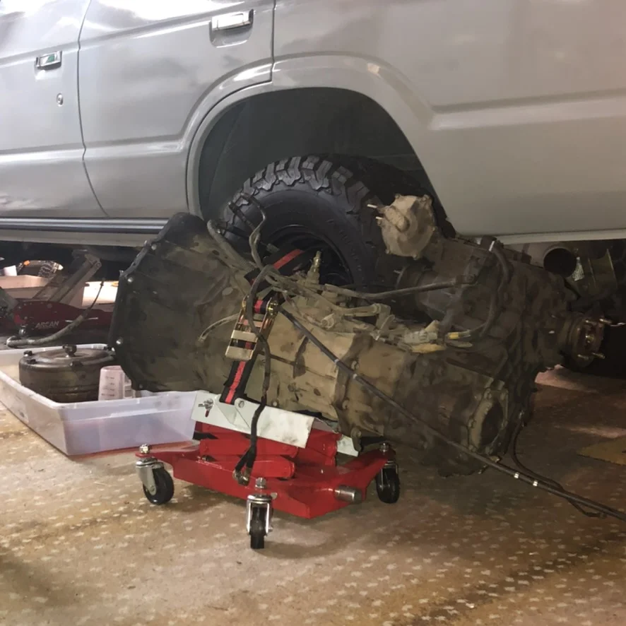

@wrc3 - Ended up on the side of the freeway on easter Sunday of 19. I am terrible at following up on here. Ended up ordering the 5 speed H55F and a pallet of parts from @cruiserparts and dropping that dead beast. I cant tell you exactly what it was but it did finally go bye bye. My truck is now the best version of herself shes ever been with the manual 5 speed. The hype is real! - also get the big tranny jack from HF...the little one almost killed me.
