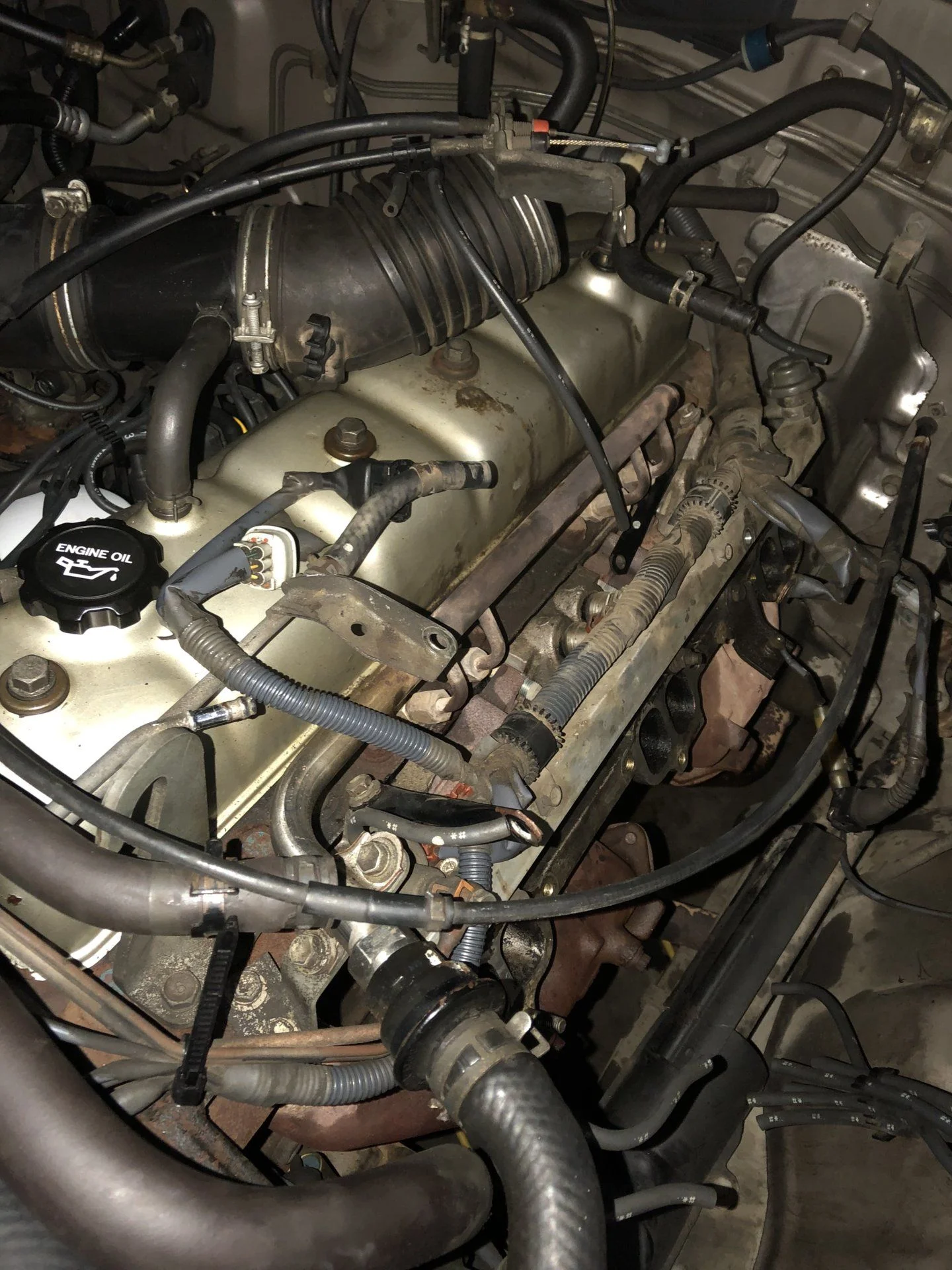

Ok Ill look into getting them checked out. As far as I know I would need to completely remove most of the Smog equipment on the right side of the engine, as well as the throttle body, EFI, and the intake manifold, as well as obviously removing the exhaust manifold too? I just am not 100% sure what to completely remove and what to leave? Any funny business involve draining the coolant etc? Last time I did my throttle body I didn't need to drain the coolant. And I don't believe I will need any special tool either.
You should not have to drain coolant. You do need to remove everything on top of the manifold so that you can gain access to the bolts. The heat risers on either end also need to come off. I used a remflex gasket for the manifold and egr when I did mine. It is kind of hard to pull it away from the head. You are going to have to remove the bolts for the exhaust, j-pipe, and maybe the j-pipe cooler so you can wiggle it out. Once you do get it out, you can check for straightness with a good metal ruler or take it to a machine shop and have them check it for you. Look for cracks down in the center of the intake portion of the manifold.

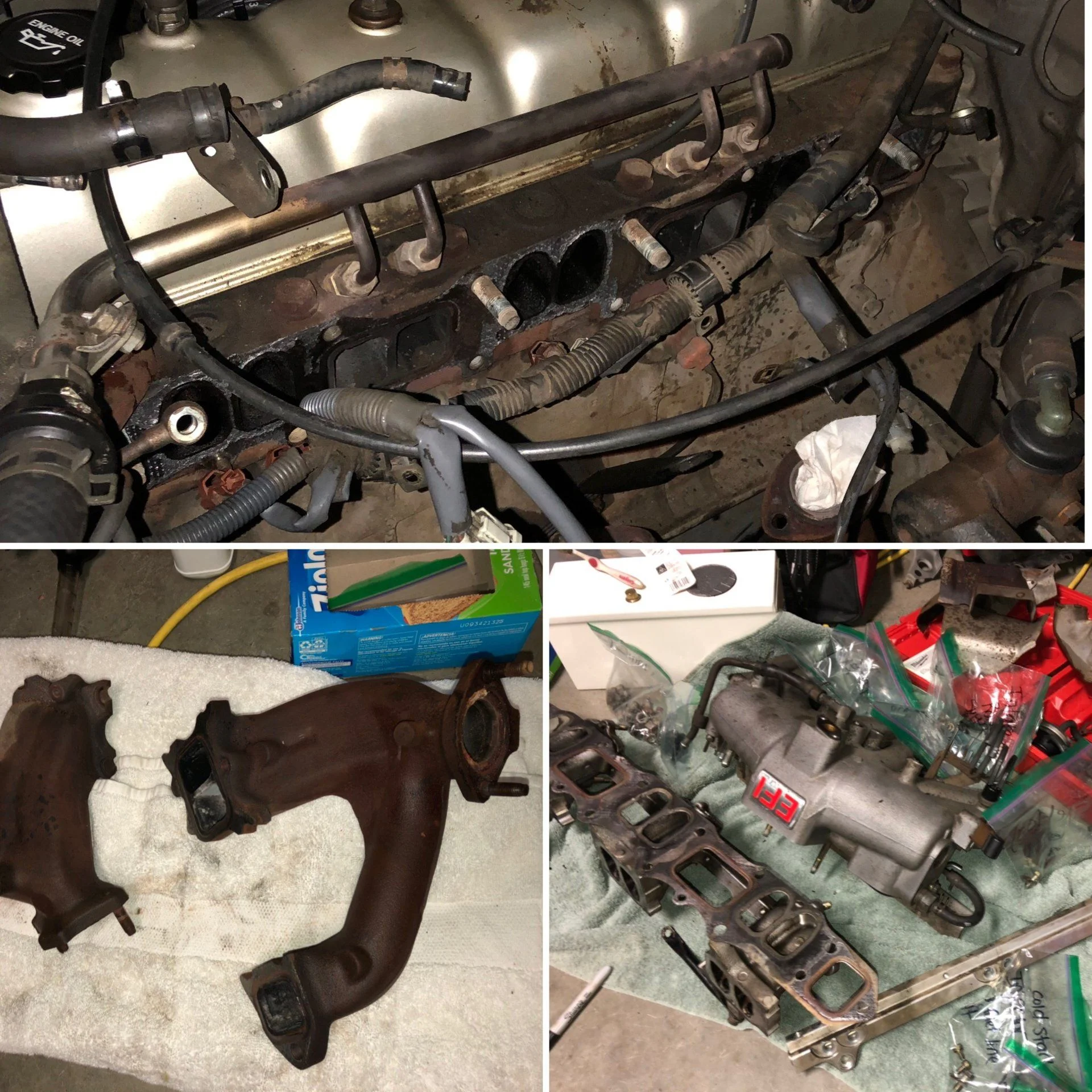

Got everything off I need to. I am going to take yalls advice and spend a bit extra $$ to get the injectors checked and cleaned by witch hunter here in Bothell WA.

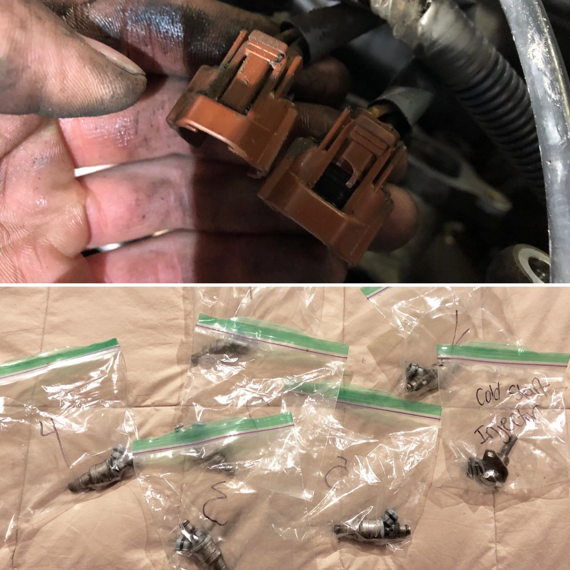

Oh and one thing, the top pic, you can see I broke off a piece of the clip. Is this bad? The clips were so hard to pull off.
Hmmm... Don't know for sure about the broken clip. I do believe its possible to buy from SOR or other places a replacement and splice it in. You could always try clipping in one of the injectors you took out to see if it holds. I would be afraid that from vibrations it could come loose.
Figure this out now before you ship off your injectors - so that if need be you can get a replacement clip sent to you while the injectors are out.
Also, I was able to ship all the injectors ( 6 + cold start) in one USPS small box. Frankly, I didn't have enough driving experience with the truck to tell you the difference in before and after cleaning. But it made me "feel" good about the rebuild - so why not?
this thread has a link to buy new injector connectors in post#4
ih8mud.com/threads/fj80-v-fj62-injector-connectors-engine-harness-differences.812590/
I replaced the same connectors on an old miata. On that car I removed the center inside plastic section and then the wires can slip out of the back of the grey housing. As long as the crimped end fittings are good, just reassemble each with a new housing. These might release the wire differently - maybe Lambcrusher can chime in - I see a paperclip in the picture

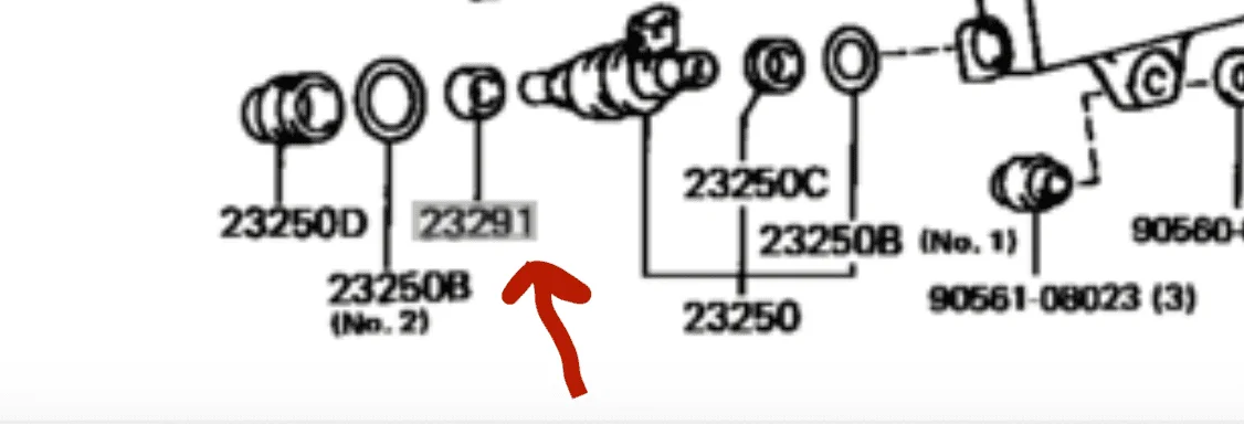

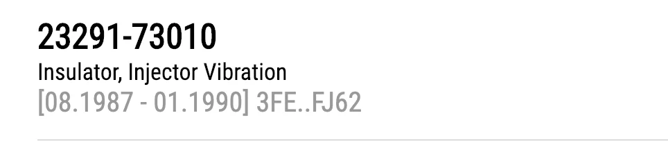

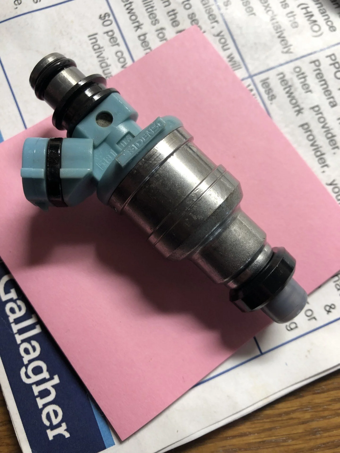

Got my injectors all cleaned by witch hunter, however they came back with this big black rubber gasket on the end of the spray nozzle... These were not on there when I took them out. I am assuming I have to take them off before I re install them? Thanks!! Also btw i was able to get an injector clip from Torfab in Everette WA.
The old ones are probably just still sitting in the manifold. Here are some pics for reference
