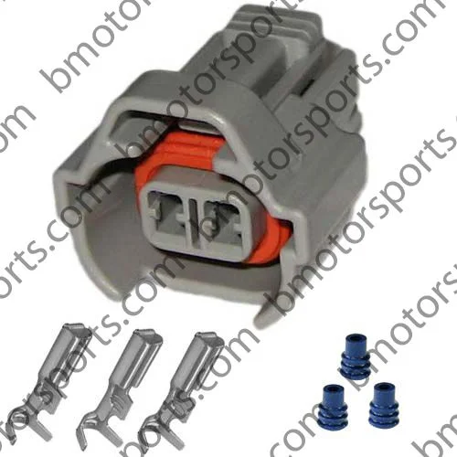

link to injector plug repair kit for stock fj62 3FEs>>>http://www.bmotorsports.com/shop/product_info.php/cPath/109_175/products_id/571
