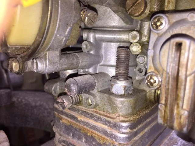

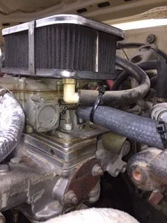

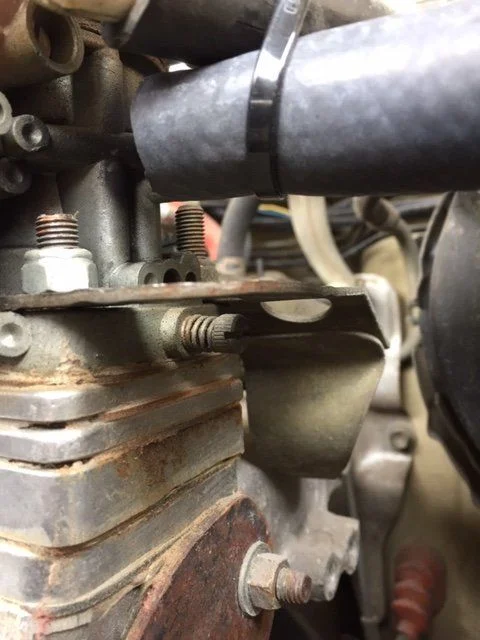

I purcahased a 1984 FJ60 with a Weber carb - 38 DGAS/ES. I have had endless issues trying to get it to idle. Carb was stripped, cleaned and reinstalled. Tested for vacuum leaks. Got it idling great when engine was cool to warm. But as soon as it ran hot it would stall. RPM would vary between 400 to 800 RPM - it never idled constantly at 800 even though this is where we set it. Got it idling fine when hot but then would stall when cool to warm. After several months I retested it for leaks by spraying some engine starter around the base of the carb and the RPM increased. Figured it must have a leak. I then noticed the nuts holding the carb were lose - so I tightened them - perhaps a little too tight because now it will not idle at all - period. Not when cold and not when hot.
The carb is installed on a stake of aluminum spacers. Any ideas?
Thanks - Fred

Is the choke hooked up? Can’t tell from the photos. Sounds like the choke plate wasn’t opening when it warmed up.
Yes, it has an electronic choke which appears to be working fine.
Okay just checking. I disliked the electronic choke and just disabled it altogether. Never needed it in Texas.
Do you have your timing set to the BB? It also looks like you don’t have a vacuum line to the base of the carb, I had the largest pot on the distributor advance to that port.
