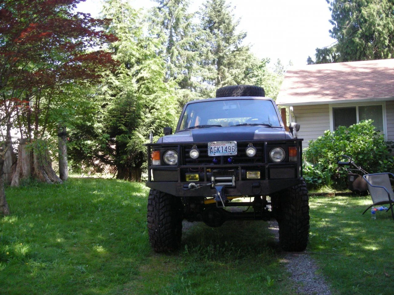

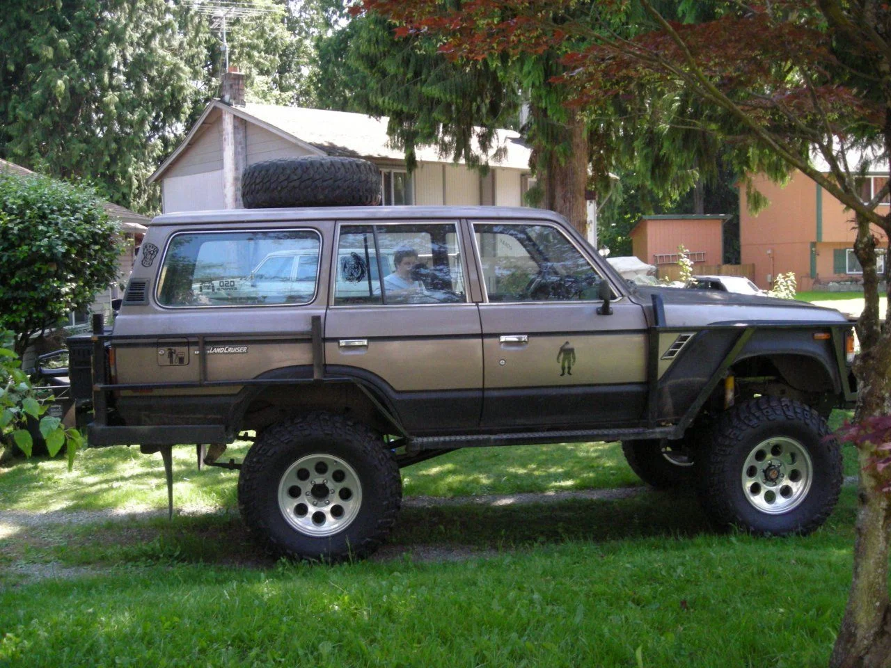

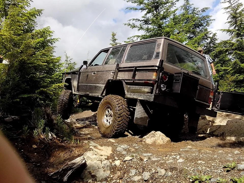

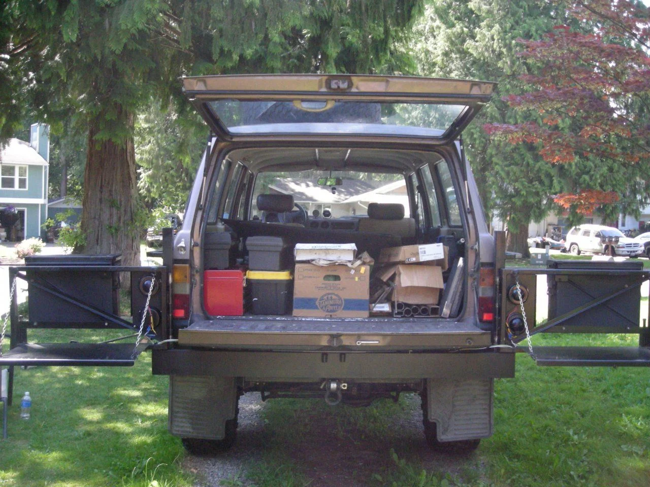

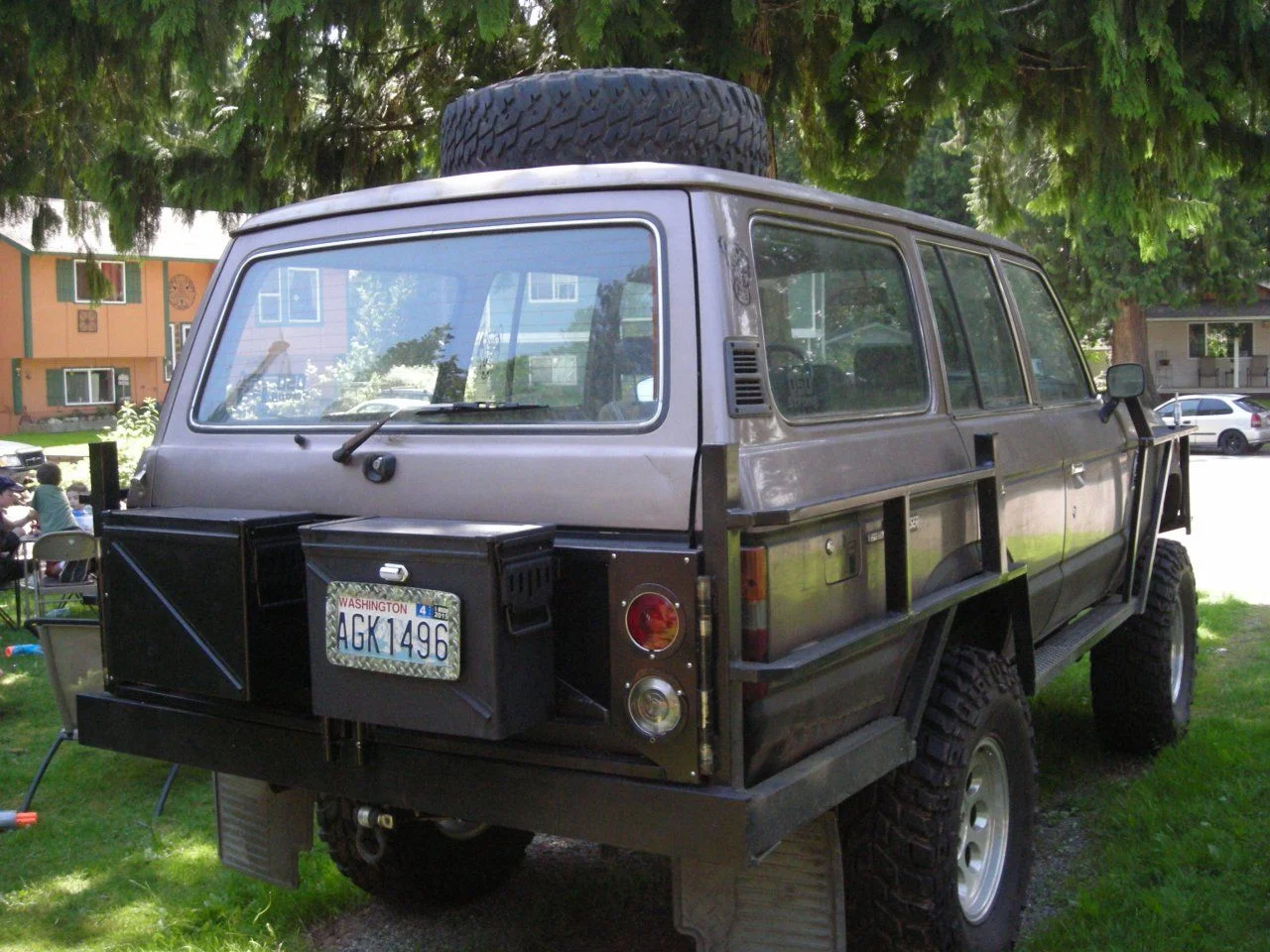

I bought this truck about 2 yeas ago from someone down by Mt. Ranier. I have completly rebuilt it and its still not done yet (are they ever). It now has 37's, locked, 5.29:1 axles, high steer, reverse shackel kit, 4.0:1 crawl kit, New OME suspension, etc., etc. still have to finnish the EXO cage among other things.

Id reconsider putting a bunch of junk on the roof. Itll be a huge pain to get it up and down and all of the cog lowering the sway bars got you will be offset by weight up high...
The exo will not help too much either but this is coming from someone whos on the verge of makin something to protect his roof so take it with a grain of salt.

I agree about the weight but the tire is just too huge to put anywhere else and it does have an aluminum rim to keep weight down. Inside space is precious to me. As far as the rest not that heavy and since I am 6'5" reaching the roof is easy for me. I had to drop the seat by 4" and move it back 6" just to fit inside. The main reason for the exocage is to mount stuff to including my many antennas and camping gear. Its got 37's now but 44's wow they are too expensive.

The vise is plugged into a receiver hitch in the front and is removable. I am building the truck in a friends side yard outdoors so the vise has been heavily used during the build. No garage build here just less muddy than the trail. The front receiver hitch is used for all kinds of things including holding big antennas for mountain top DXing with my Ham radios.
That... Is brilliant. I'm seeing many potential uses.
Thanks. I've even seen a BBQ that plugs into a receiver hitch. But then again I have the fold down shelves in the back for BBQ & stove & water container etc.
I made a swing down tire carrier mounter on a swing out gate for mine. There are options for the big meats man. Even if youre 7' tall and have adamantium rims the tire is gonna be a bitch to put on the roof. Hell im not a small dude and my 40s on alu rims are fun to put in the rear cargo area.
