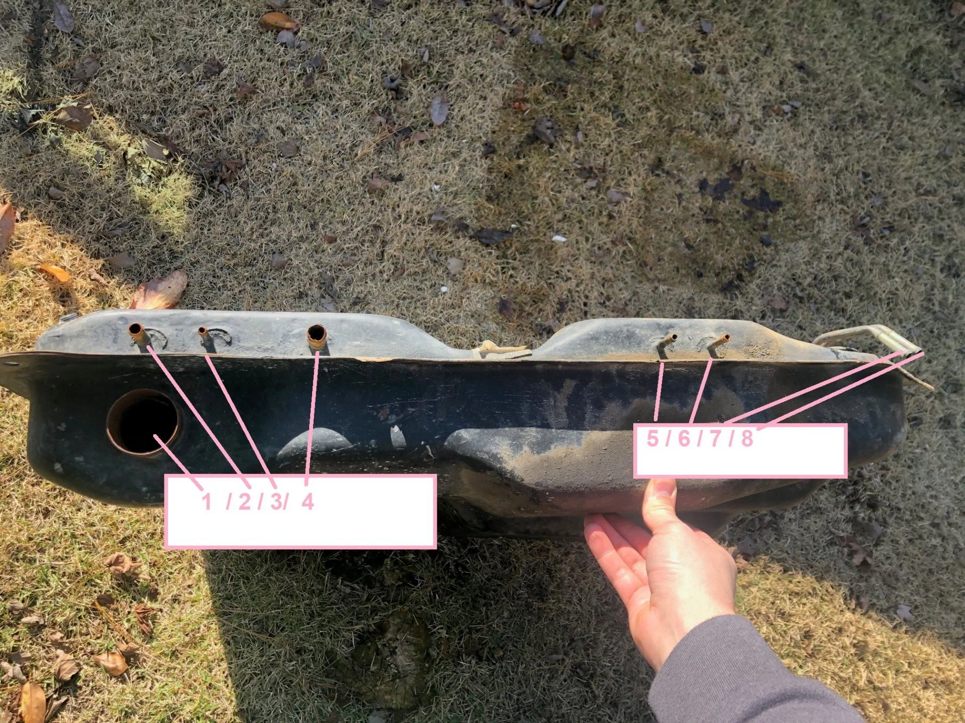

Here's a photo of the old tank removed - it shows all 8 fuel line connections that have to be removed.

Good advice. As I was underneath my 84 FJ60, I noticed how my flat my leaf springs were. I have to shop around eventually for something else. Were 7&8 lines hard to get off?
I used some seperator pliers and replaced all the hoses, mine were really crusty, 1 busted knuckle

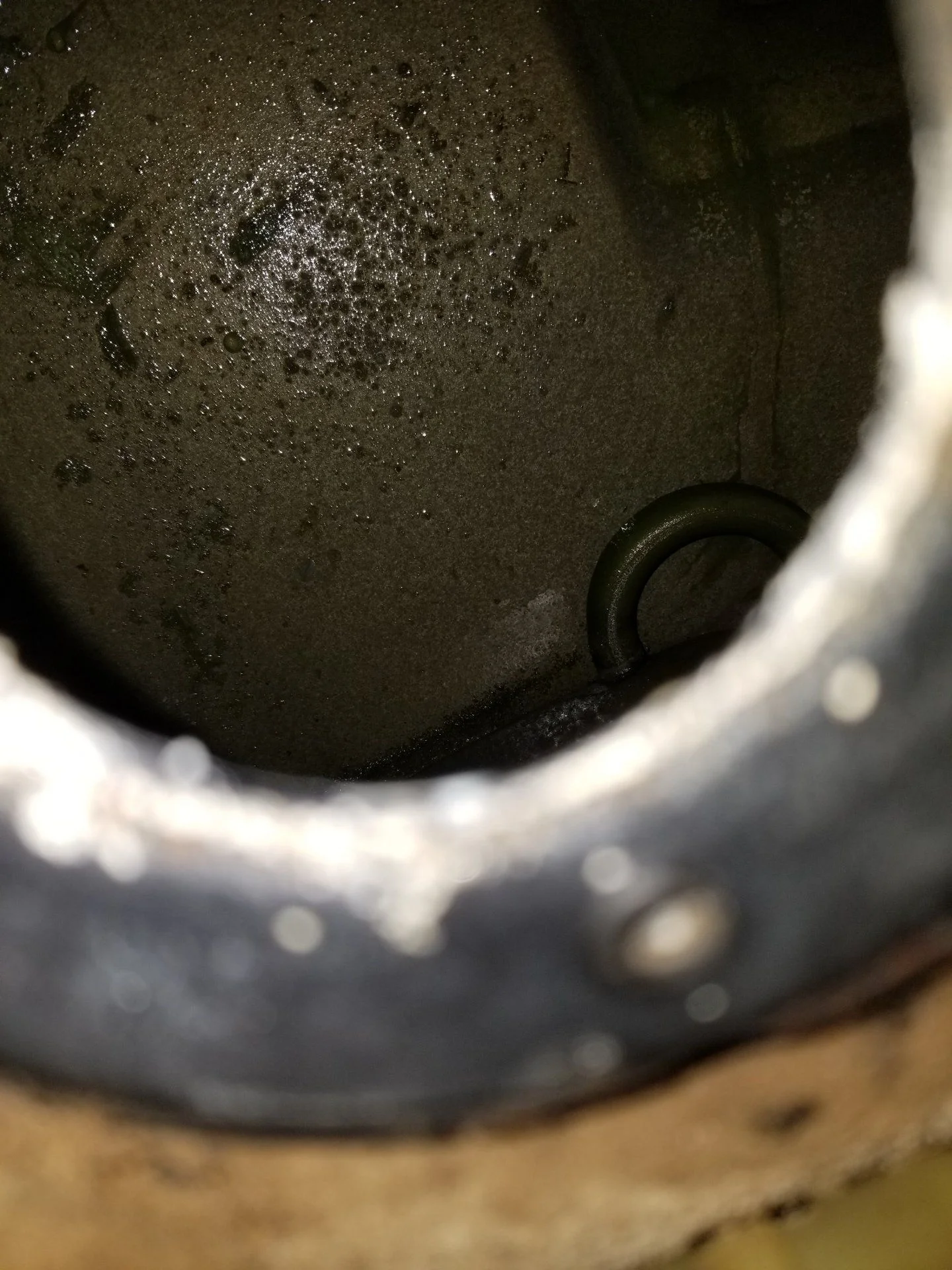

So here is a pic of after blowing line and draining it. I do not see any rust in the tank...
In my case, none of the lines were hard to get off, I was able to pull them all off by hand, including releasing the hose clamps by hand.
