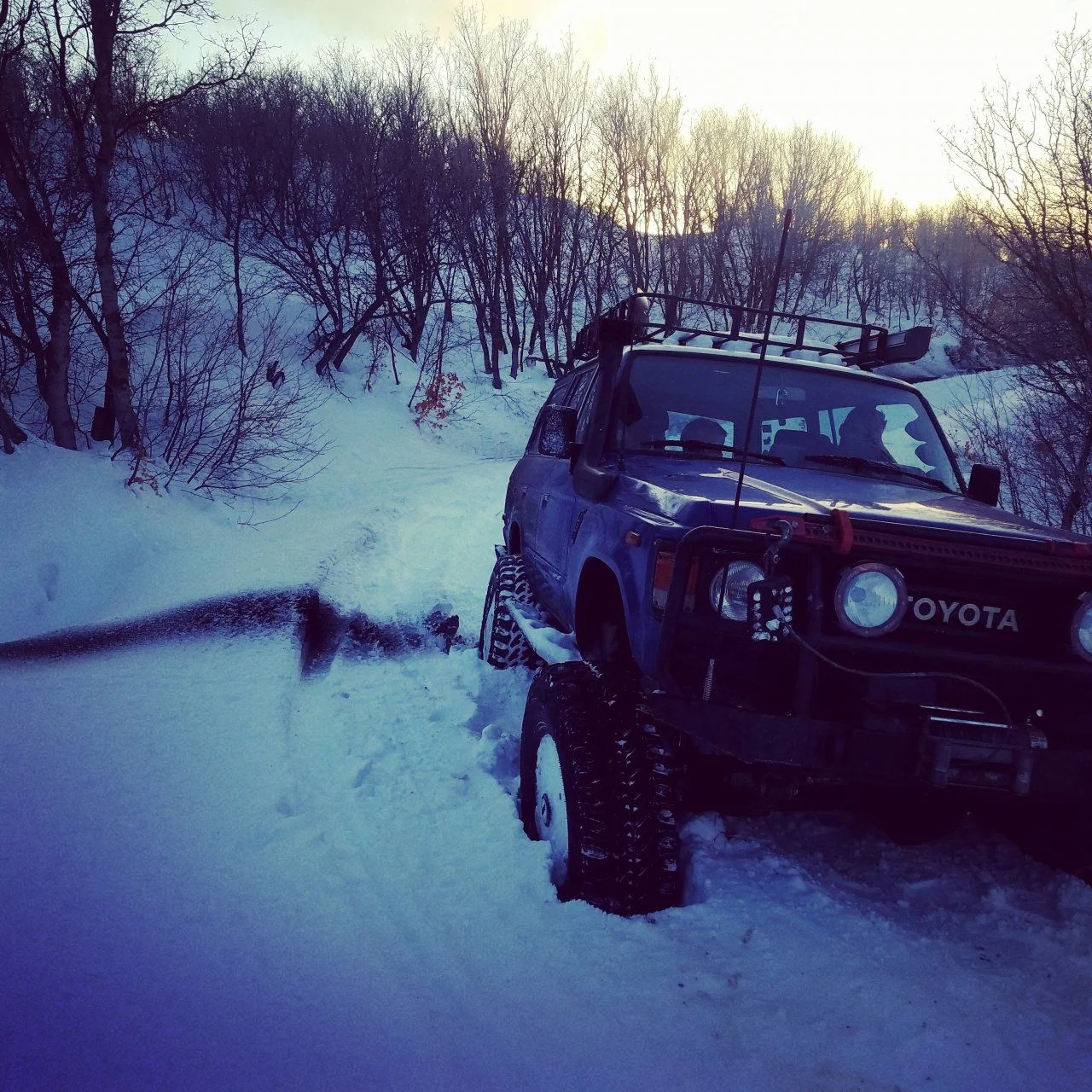

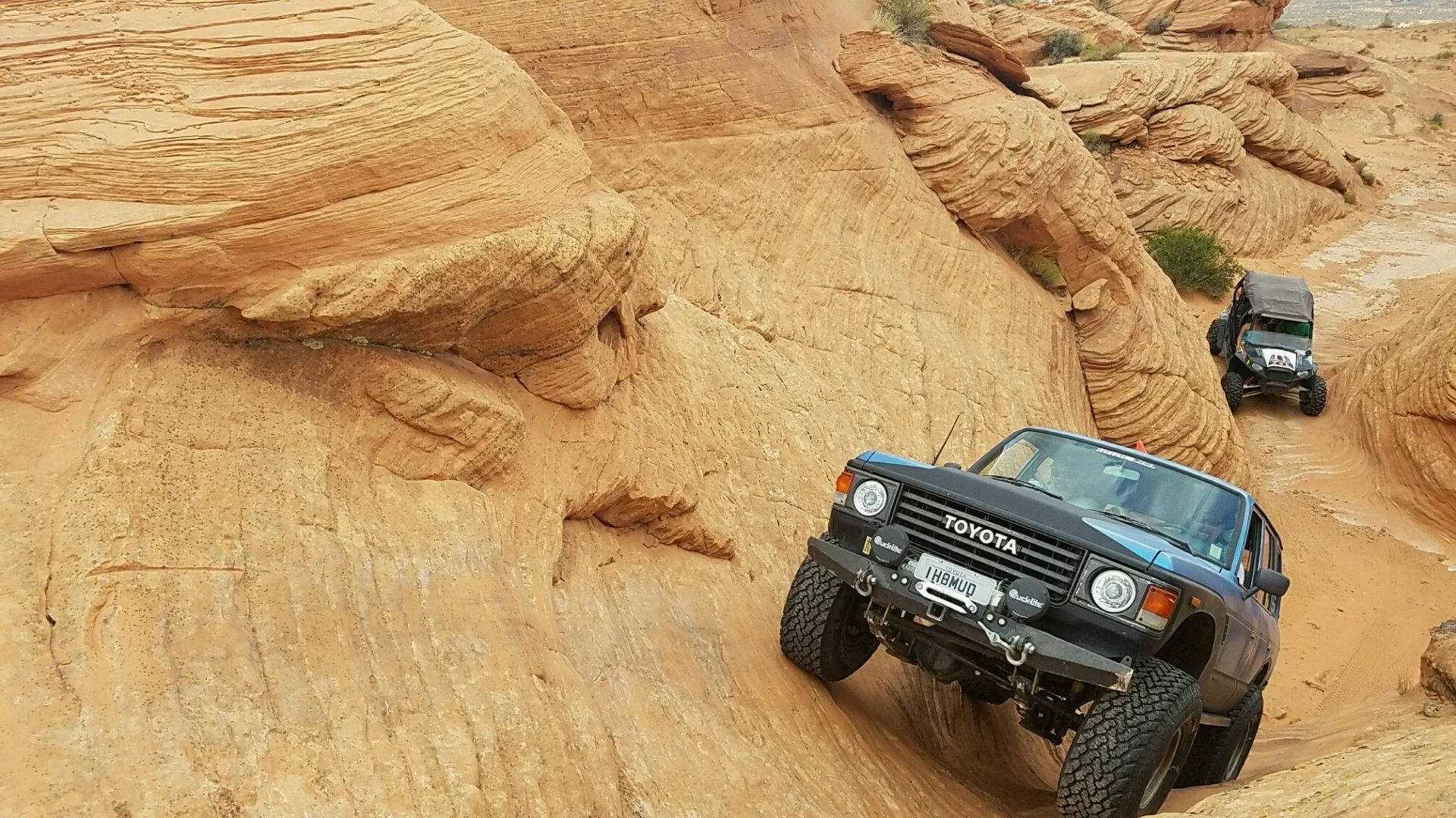

Update. I fixed the threads in the 241 and slammed it back in. Went on a rescue mission with it on new years and torture tested the whole rig harder then ever to get to where the stuck rig was and I'm happy to report no mechanical issues whatsoever other then my winch cable finally giving up its ghost!
Marking your territory with diesel char. Nice!

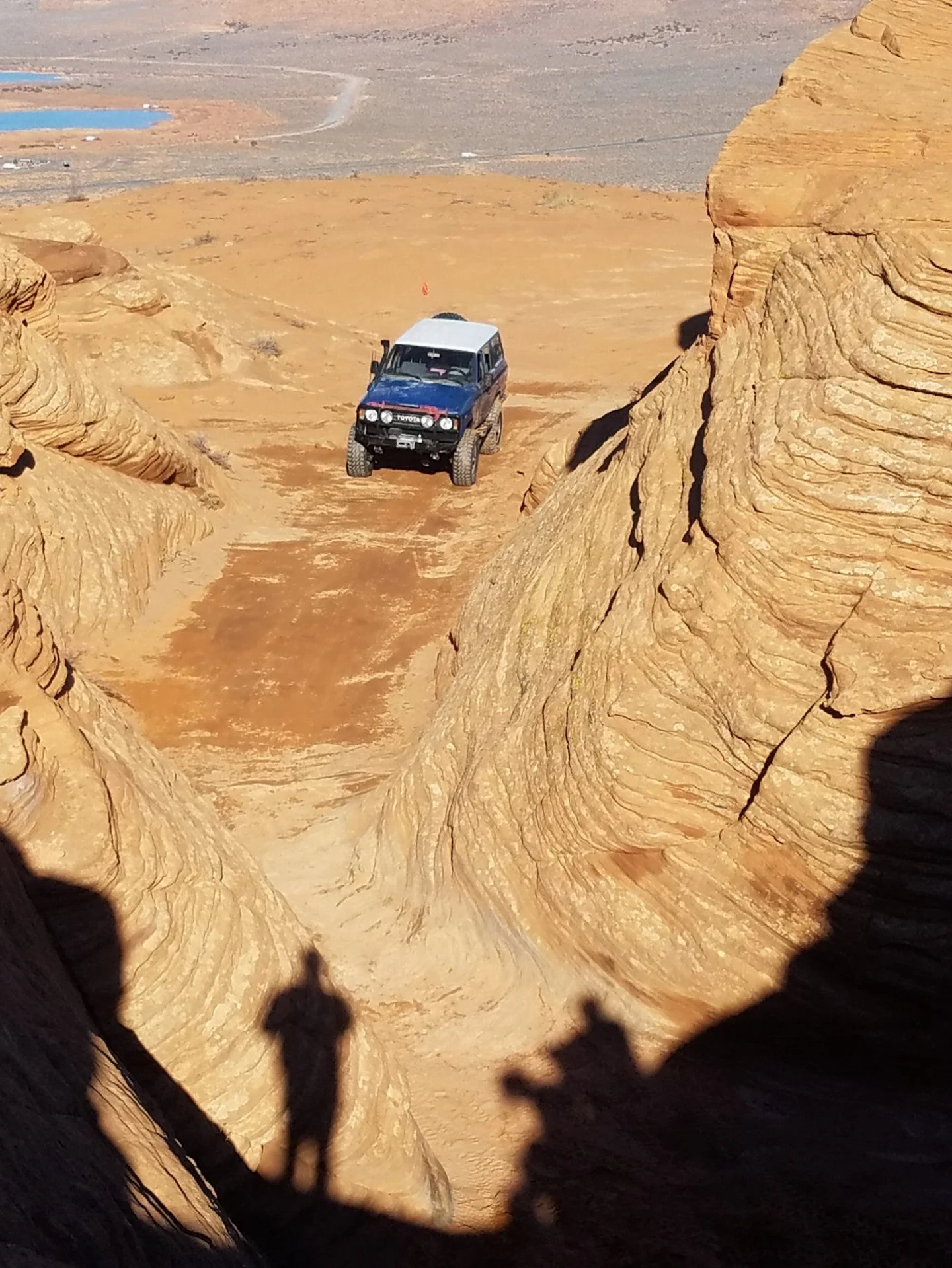

To ring in the new year (and warmer weather) I went down to Sand hollow in st george Utah (3 hours from me) to do some trails and long story short I learned I in fact need to cut fenders for 37s and those front leafs gave up on life from the trip. So now it's links and coil over time. Anybody ever done this on a 60? I would like to use 16 inch coil overs instead of 14s but I'm not sure if they will fit. What is your guys take on it?

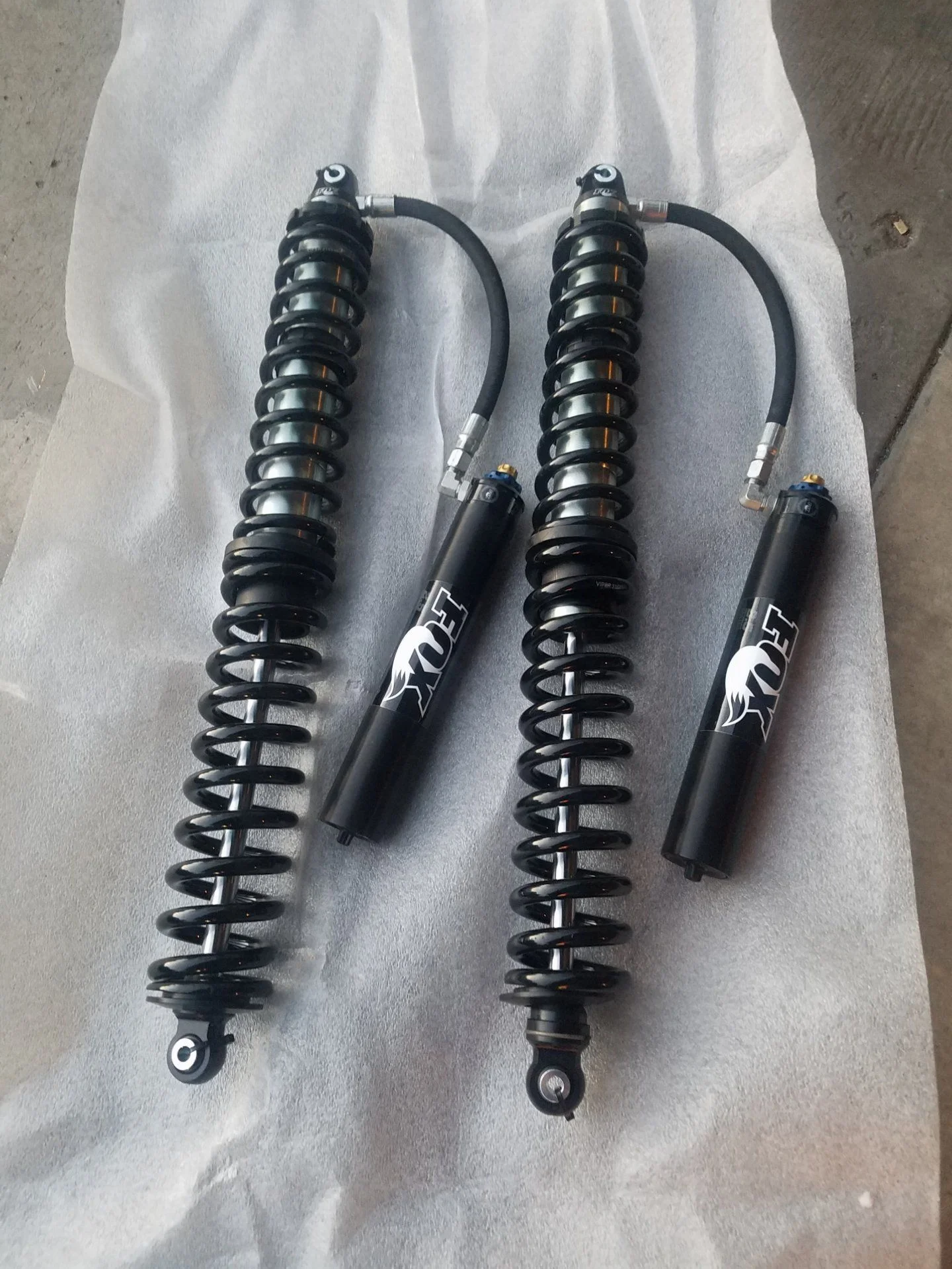

I got serious about it recently. I have everything I need to do it. Unfortunately it's been snowing all week! (Of course) this weekend should be alot of great progress on the swap. These are the coil overs I went with. 14 inch fox competition shocks with quick external adjusters
Good choice! Are those 2" or 2.5"?

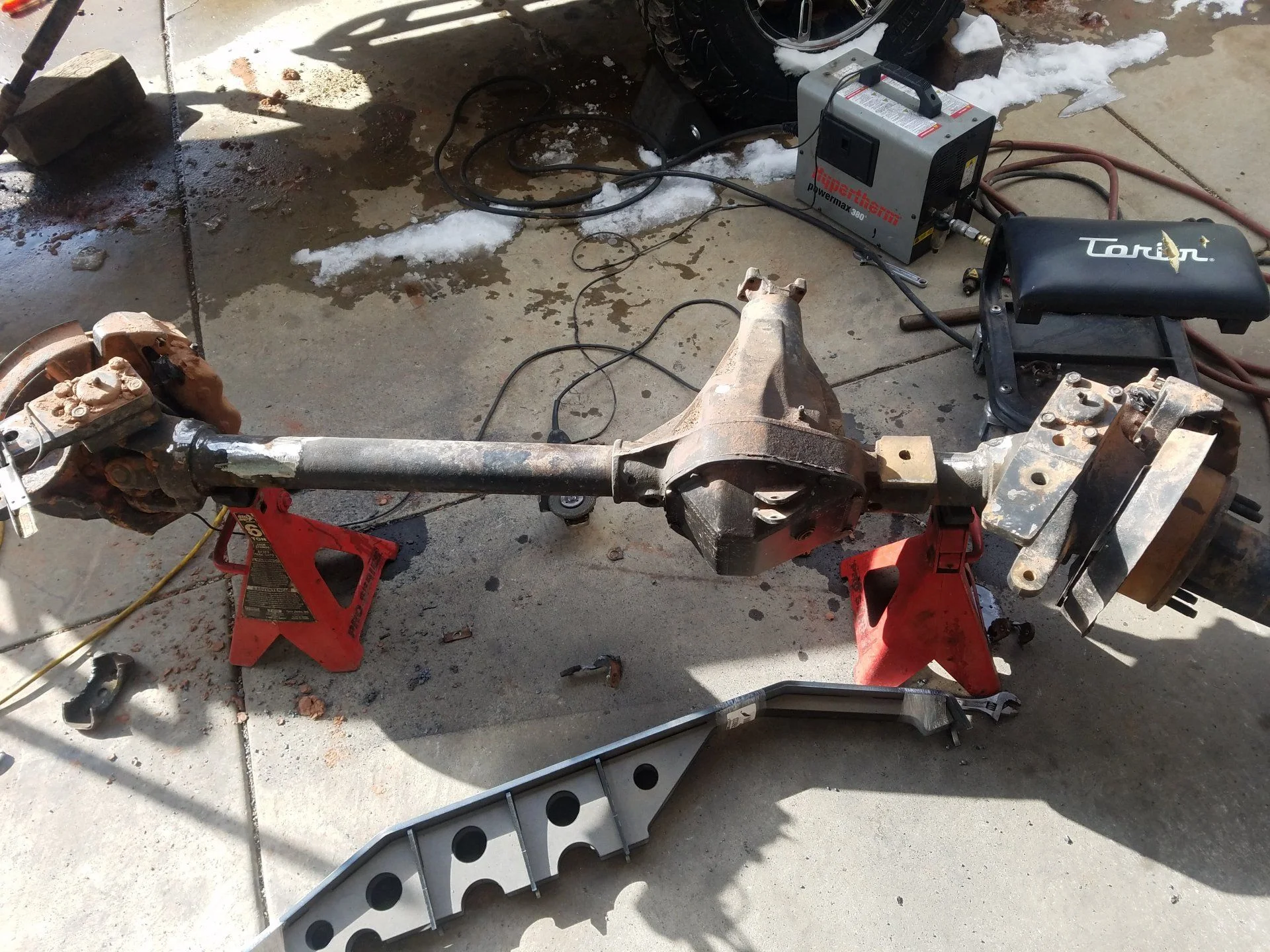

Got the axle out and all cleaned up. Truss is tacked on and track bar mount is tacked on. Due to the track bar location I had to move my tie rod back down to the stock location (gives me a world more room to play with) unfortunately now I'm trying to rebox my diff cover to fit the steering from contacting when it's turning left. Tomorrow I will shove it back under and start setting up links
