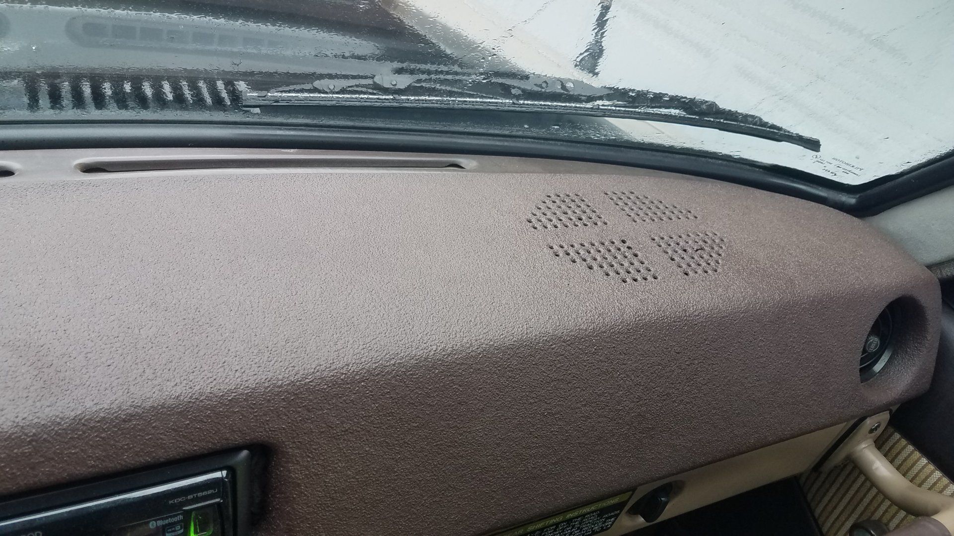

This is mine. I patched the cracks, and smoothed it out then I had it sprayed with line-X with a light texture. Finally, I painted it with the SEM Cordovan Brown interior paint.
