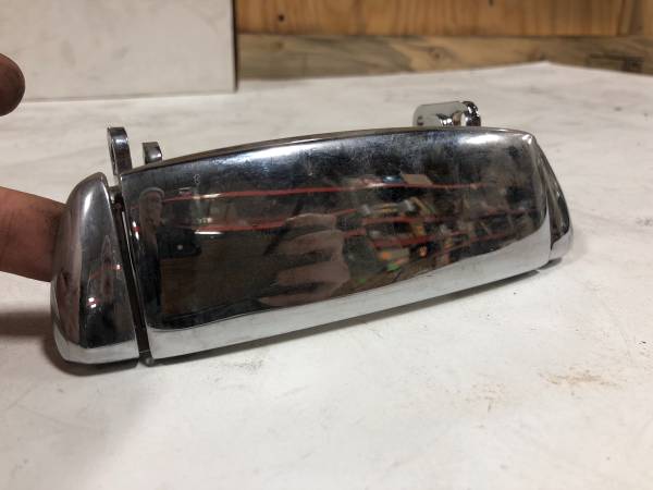

honestly, I leave for vacation tomorrow. back next week. I was going to take the part over to the machine shop we used for all the mold making (smallworks.com) and ask them what their approach would be. They do a lot of EDM, but more traditional tooling is certainly within their grasp.
I expect to be asked about anticipated volumes, because that tends to drive the solution space as well. "less than 100" is my best guess, which is why I intend to run these on the mill in back, rather than have them made somewhere. The mill is *almost* hooked up. I need to finish the airlines in that part of the warehouse/shop.

My best guess on the gasket is to cut it in-house on the 60W laser etcher. If that works, maybe I figure out a pattern on the others (door handles, etc.) The laser makes super-clean cuts if you can keep it moving fast enough to not ignite the material. I could probably figure out how to make a die if that doesn't work.

How about the metal 3D printing ? Yes, the company is Mark Forge.the metal particles are encapsulated in polymer and which is what is initally melted together. Then the part is put in a furnace and the metal is sintered. They are doing stainless, and even inconel. Cool stuff.
Slightly distracted with making reproduction snake blinders for the 60-series right now. People seem to be willing to pay $500 for a pair of these in decent shape on fleabay. OEM is chromed stainless, but we’ll probably electro polish a better grade of stainless and get a better result. Would CNC/anodize the ends in aluminum, source appropriate clips, and need a hard tool to get consistent results on the sheet metal bends.
But, this is the pig channel. So, ... while visiting the machine shop, we also looked at the 55 handle. Closer inspection shows visible stress risers in the casting. Semi-obvious why they break now. Some thoughts on a rubber “bumper” for option ‘2’ below to reduce the ringing when the handle is allowed to slam closed.
Current though is to make the handle in two versions:
  1. Cold steel, that can be powdered, chromed or nickel plated. The plated versions will want more surfacing than a powder coated version. Chromed would be as close as I want to get to a pure “reproduction” part.
  2. Stainless, likely polished, but other options are possible. Could offer customized (“FJ55”) text in the face of the handle.
Very likely just laser-cut the gasket.
